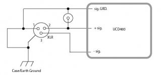

Chassis grounding question.
I have XLR inputs on my amp and I thought a few posts back that I read Bruno saying that the correct wiring is to take the earth tab on the XLR sockets directly to pin 1 (earth) on the XLRs? This seems a bit peculiar because a) we are then grounding to the chassis at two points and b) we are sticking chassis noise into the signal ground
Surely something like taking the XLR grounding tabs directly to the chassis earth is better?
The rest of the amp uses something which should be a star earth with a single tap from the powersupply to a screw in the chassis and from there to the mains inlet earth pin
I don't have any hum at this stage, but could someone confirm the "correct" wiring for these things. I don't have control of the source wiring - it's an embedded plug in an RME pro audio PC soundcard - however it's a balanced source

Of course you will have TWO groundings in this way, but the UcD amps are having a fully symmetrical balanced input (instrumental op amp!), so all common noise or hum is cancelled out.
The length of the input wire (pin1 to ground) is with the Neutrik connector the shortest what is possible so all common noise/hum or RFI is put away from the input and goes thru the chassis ground. When you work with a central ground by the power supply all this common noise goes inside the amplifier, and we don’t wants to have this inside the amp!

But...we DON'T recommend to connect a RCA in parallel with a XLR. Use the XLR and make the cables asymmetrical whereby the shield goes to -sym at the cinch side, the XLR side stays symmetrical. In this way the signal stays symmerical from the XLR at the amplifier till the cinch connector.
But you don't have to do it in this way, it's our recommondation, everybody is of course free to do it in their own way!

It's also recommended by Bruno to use a three core signal wire when using RCA and tie ground and pin 3 together at the source (using an XLR on the amp side of course). I guess the idea is then at least you get the second wire which carries a copy of the noise out of phase and hence provides some noise immunity (clever really)
However, I do agree - surely if you put an RCA jack on the back of the box then it's going to be pretty noise wired like this? RCA jacks are normally insulated from the chassis, what we are essentially doing here is tieing the RCA shield directly to the chassis
