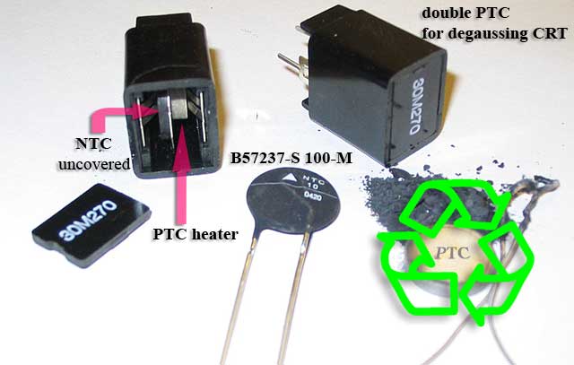

Some illustration to the NTC softstart
I've just built a softstart for my transformer I'd like to use with the UCD400 if its suitable
It has 2 x 40-0-40 secondary's and is rated at 2780va this was removed from a 2000watt poweramp so it should run the modules ok
I have a pair of these Avondalecap-6 modules to use for the rectification and smoothing caps
The diodes are MBR20200 Schottkies with 3 x 6800uf 80v caps per rail so theres a total of 12 x 6800uf capacitors for a stereo amp.
Would it be worth changing the 12 x 6800uf to 12 x 10,000uf instead?
Maybe a bit overkill but the transformer is huge
