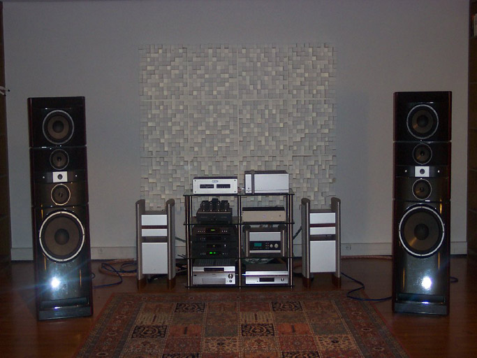

Pics from the setup
As promised, here are some pics from the setup with which we made the listening tests (sorry for the bad quality). Not that most of all devices have been used partly, but the conclusion is only for the best gear.
On the rack
(top shelf, from left):
- preamp Audio Research SR16
- Halcro Logic 5 channel amp
(second shelf from top)
- tube amp Audio Research VS55
- UcD400 dual mono amp
(third shelp)
- stacked up: dCS Verdi Encore, dCS Verona (ext. clock), dCS Elgar Plus
- Halcro DM 10 preamp (not used in our tests)
Lowest shelf: some Sony S-Master surround amp and SACD/DVD player used in 5.1 setups.
Beside the racks the hefty (55Kg/120lbs) DM88 from Halcro.
Wired in "enlightened" (some blue LED's at the end or beginning of each cable, powered with 5 PSU!) Synergistic research cables. Shuntaya power filter.
Speakers Grande Utopia Be by Focal
