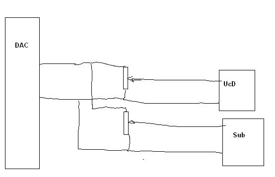

Hmmm..I think I will stick with the 4 gang pot method for the time being.
I haven't found one yet, but I bought some two gang types and have pulled them apart. I will put a common shaft through them to make a 4 gang.

runebivrin said:Just connect the amp inputs in parallel after the pots. The worst that can happen is you get a slightly over-logarithmic volume curve. At full and zero volume the pot doesn't matter, and in between it's just a voltage divider.
Rune
Sorry to ask the same questions again, but would the above be the only draw back? If so, I'll just stop looking for an affordable 4 gang pot.
There must be other issues with parralleling the inputs on both the UcD and sub.
I believe the speaker negative connection on the UcD400 is not at ground potential, so you can't use it to drive an unbalanced input sub.
All you need is an active volume control after the DAC, with two outputs. One stereo pot is all that is needed. It's probably cheaper to build an active circuit than buy a quad pot, if you can even find one. And the performance (and tracking between channels) will be a lot better.
richie00boy said:I believe the speaker negative connection on the UcD400 is not at ground potential, so you can't use it to drive an unbalanced input sub.
Hi Richie, I wanted to avoid an active volume control. And I don't have the time to research and built one. The simplest for me would be to just parrallel after the pot.
What you say is an oxymoron. An active circuit is about the simplest and easiest thing you can design - just slap together a non-inverting amplifier from what you have lying around. Conversely to build a passive correctly would require consideration of all source and load impedances.
richie00boy said:An active circuit is about the simplest and easiest thing you can design - just slap together a non-inverting amplifier from what you have lying around.
richie00boy said:Conversely to build a passive correctly would require consideration of all source and load impedances.
Do you have a link to a site which tells you how to do this correctly?
A non-inverting amplifier is just an op-amp and two resistors. Google it, you will be able to get it in under an hour I guarantee it.
