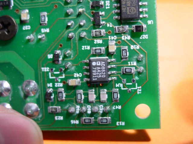

Some of my UCD180AD that I get from local Hypex dealer in Singapore has got missing T22 and T21 smd transistor and some of the modules were intact, all of the module were V4 dated 11/04/2005.
I wonder is that a manufacturing fault, or Hypex removed the T22 and T21 for goods.........

Well, the collector and emitter pins of both T21 and T22 are tied together. The base of T21 is connected to OUTB of the 8620 and the base of T22 is connected to OUTA of the 8620. The collector and emitter of T22 are connected to the negative supply of the 8620, and it appears that the collector and emitter of T21 are as well, although the trace runs under the case of the 8620 so I can't say for sure.
The purpose of these devices, assuming they're pnp transistors, could be to prevent output overshoot below the negative supply rail voltage (plus the drop across the np junction too).
how's this?
Ahhhh, now I see. I saw on my UcD400 modules that the same spots are empty as well. At that time I guessed it was to have the possibility to add a transistor acting as a current source to load the outputs of the AD8620 with a constant current .
Ahum......correct. Now you have guessed it, I can tell it. This is a 'hidden audiophile' option for a SST511 😉. But will only work when you have the AD8620 upgrade.

Seems to me that with the AD8620 you might not want that tweak.
Yves you can think of it as a constant current source or an active load, better off as an active load in this case.
A tightly regulated and well filtered auxiliary supply for the front end makes this tweak redundant anyway.

Well, I remember Bruno saying in one of these threads that loading the AD8620 with a constant current load to the negative rail was his way to high-end heaven🙂
Anybody tried it? I think most people only tweak the caps, but this could be an interesting one as well.

According to Bruno's explanation of what is really occuring with that tweak, it has next to nothing to do with "Class A biasing" in that cross over distortion isnt' the problem as seems to be the common thought. His post will explain it better if you can find it, but it has to do with how the op amp is being compensated, always leaves you with one rail that has lower PSRR than the other, usually you can see this on the data sheet.
To that respect you dont' always use this tweak as commonly thought by tying the load to the negative rail. Maybe that's what JP meant when he said you needed the AD op amp for this, the 5532 might require being tied to the positive rail.
Anyway the point is, if you have a _very_ quiet supply, increased PSRR then becomes redundant. But at the same time it's a 2 cent part and if it makes you feel better why not?
Increased operating temperature of the amp is the only downside and I can't see that being a very big deal.
Put it this way when I do add the aux supplies, since I'll already have the active load in place I won't bother removing it, but I'm sure it's more of a bandaid and the real tweak would be the aux supplies and regulators like yours 🙂
