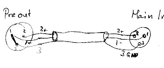

Hi Jan-Peter!
I didn't quite understand what you mean. But as long as I use only balanced inputs, it doesn't matter, right!?
Could you please make a drawing, showing the schematic on:
"solder the -input line to ground/screen at the source side and NOT at the side of the amplifier connector."

Roland,
Indeed with a symmetrical input everything is ok!
But supose you would use an asymetrical input so must put one wire to ground. Normaly to keep everything in phase you put the -input to ground. The question is at which place do you put this to ground? The best would be at the side where the source is. So you will pick up the signal at the side of the source.

Roland,
Indeed this is completly right! Now you take your signal still "slightly symmetrical", because the small signal voltage what is on the screen does not go to the input.

Thanks for the info! It's good to know, should I, or anyone else need to go unbalanced.

paradigm said:Like this you mean?
/Roland
Hang on... your drawing depicts a preamp with a balanced output! In that case you just connect "normally" ie pin2:+input, pin3:-input, pin1:shield. Depending on the output stage of the preamp, shorting one of the signal lines to pin1 is not always a good idea...
The connection whereby the shield and - wire are tied together at the source is used when the source has an RCA output connector. In that case shield and - connection at the preamp output are indeed both ground.
...Bruno, you had a better eye as I
Ofcourse the best is a symmetrical output and it would be VERY stupid to connect it in an asymmetrical way!
