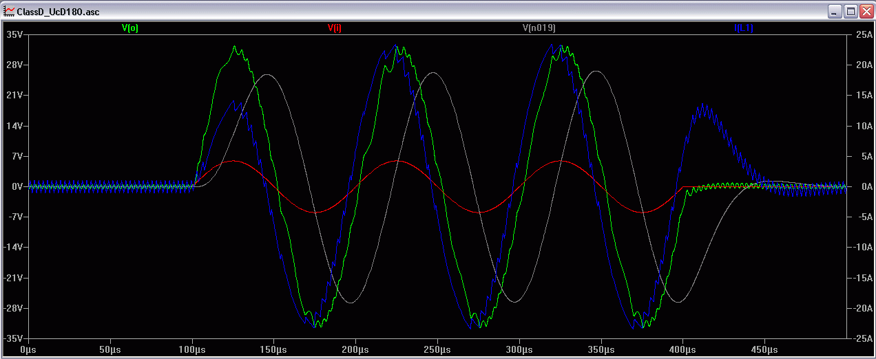

attached is a simulated response of UcD180 to 10kHz burst signal into proposed ESL load. UcD180 simulation model was provided by Analogspiceman here.
Traces are:
red=input voltage
green=UcD output voltage
blue=UcD filter inductor current
grey=13.4uF load capacitor voltage
It can be seen that classD amplifiers are actually capable of driving ESL. Problem with actual UcD circuit might be current limit since peak mosfet current in simulation exceeds 22A.
I also think that it would be possible to design classD amp without output filter using actual ESL speaker as a filter. It should be integrated with outpt transformer, or you would enter EMI hell. Also high voltage feedback might be a little problematic. Transformer losses from switching action of output stage might also be problematic, although my experiience shows that deltaB of less than 25mT at 80kHz is quite acceptable for standard iron cores.
Best regards,
Jaka Racman

Jaka, good work on the simulation of the ESL load.
I presume that you also included the resistor and inductor elements of the ESL model.
I have been wondering if the ucd amplifiers might be the "magic amplifiers" that work with ESLs. The ucd is strange in that its stability (or designed-in instability to ensure oscillation) depends upon oscillation where most loudspeakers present an inductive load (at > 400khz). Whether ESL or conventional, for such speakers the ucd output filter will dominate the open-loop gain at the oscillation frequency. The peak output current required is another issue.
I have thought of building a ucd-based ESL amplifier with the transformer installed inside the amplifier to form a simple second stage of RF filtering. Another approach, simpler to implement, is to move the ESL "tuning resistor" (the 1 ohm resistor I mentioned) into the amplifier case, and add an impedance compensated notch that would provide > 20 dB suppression between 400 and 500khz. The load seen by the amplifier would be about 4-6 ohms between 30khz and 1Mhz.
This looks like a perfect application for the leapfrog method of switching amplifier design. 🙂 🙂 I noticed that with critical damping, the ESL rolls off the upper treble starting at about 12kHz or so. This could probably be extended to >20kHz closed loop BW with leapfrog.goudey said:I have been wondering if the ucd amplifiers might be the "magic amplifiers" that work with ESLs. [...] I have thought of building a ucd-based ESL amplifier with the transformer installed inside the amplifier to form a simple second stage of RF filtering.
Actually, since the ESL is well damped, just a passive, open loop pre emphasize would probably do. -- a.s.

HI All,
With Quad ESL speakers (yes the old radiator-like monstrosities), the way to test if the amplifier is stable enough to drive the speaker used to be to have a 1KHz square wave input to the amp, 8Ohms load, and put a 2Uf capacitor in parallel to the load.
If there was no excesive "ringing" (overshoot on the leading and falling edges) on the output of the amp, it is deemed stable enough.
This has been borne out by numerous tests I did with almost any brand of amplifier. Some amps just burned if the output was over 10% of maximum power, and some, like Quad (of course) SAE, Crown and Krell did fine.
I haven't tested this with my modules, but that I think is the way to go....
Any comment is welcome, and I'l be trying this next week and get posted some real time results.
Arty123:
The test you are suggesting may be helpful for understanding general amplifier stability (with the help of a signal generator and an oscilloscope), but does not well represent an ESL load. The load you suggest presents an impedance of less than 0.2 ohms at 400khz, and an impedance of about 3.6 ohms at 20khz. The typical ESL impedance is very low at 20khz, and very high at 400khz. The ucd amps rely on self-oscillation at about 450khz, so the impedance < 0.2 ohms may be a problem for it.
jmateus:
When you destroyed you Sonic Impact did you have a resistor in series with the transformer winding on the amplifier side? Without one the ESL setup will very likely either cause a weak amplifier to shut down or blow up. A resistor in series is necessary.
jmateus:
