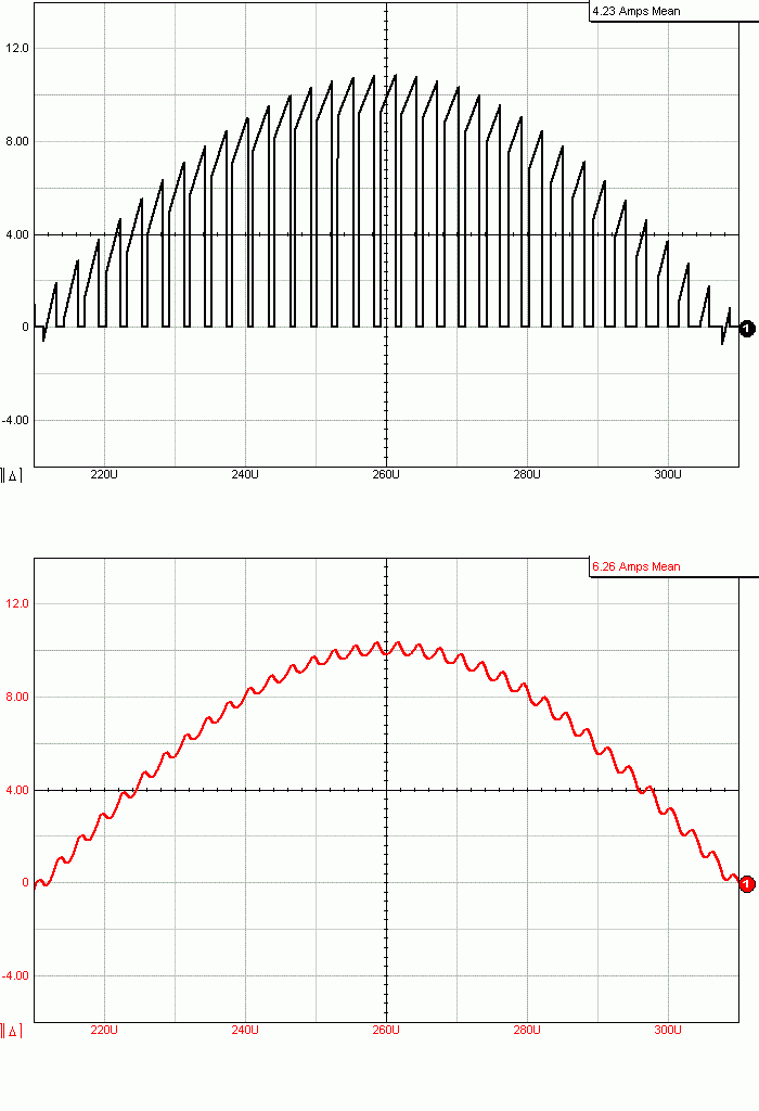

The above quote shows total lack of comprehension how classD amplifier actually works. Now if you would substitute current for voltage, that would be correct. Namely:
The way that class-d works is to supply the max voltage with every pulse, but the duration is such that it averages out to be the same average voltage that a class-b amp would produce.
Amplitude of current pulses is actually the same as coresponding load current at the same time, or the same as class B amp would produce. (inductor ripple current is neglected in this explanation.) So we have a series of current pulses whose envelope coresponds to that of a class B amp curent consumption, but whose average value is less than envelope. This is where the conversion process of classD amplifier takes place and that is why it can be compared to a variable transformer. Actually duty cycle corresponds to turns ratio of such a variable transformer.
Now if you still think those are minor differences, then there is also a minor difference between classD and classA (both being amplifiers) and we can end this discussion.

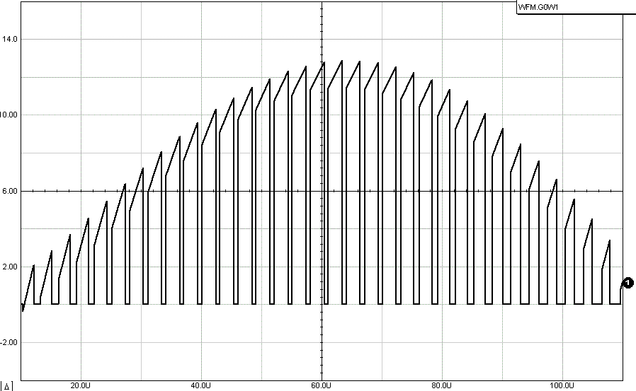

Attached is image of current pulses drawn fom power supply in classD amp.

I am afraid that your assumption is incorrect. The point is that the current drawn from the power supply is average value of the waveform. I attach two waveforms, black one showing current drawn by classD amp and red one showing output (load) current of the same amp. Load current would be the same as current drawn by classB amp. In upper right corner you see calculated average values of both currents, 4.23A for classD and 6.26A for classB. (Average value is calculated as area of the waveform, so you must account for the voids between current pulses.) As you can see, there is 2A difference between both amps. Those 2A of current is transferred into heat in the classB amp, so this is why classD amp runs cooler: It draws less current from the power supply.
