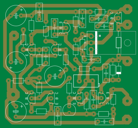

BTW, simple discrete opamp from here http://www.diyaudio.com/forums/attachment.php?s=&postid=369533&stamp=1081722163 have ~0.03% THD at 2kohm load@4Vp-p output@gain=4, just by adding a current mirror ([bc857+bc857+220ohm+220ohm]=cost is nothing), THD will be less then 3 times (0.008%@20-20000hz flat).😎
IVX,
Intersting!!
Who is making the schematic complete and creates a SMD PCB????
Or starts a new thread, I will offer to make the PCB design, I will put the gerberfiles for free to everybody on the Internet.
Jan-Peter
Intersting!!
Jan-Peter
Jan-Peter said:IVX,
Intersting!!
Jan-Peter
Impressive! Nice offer, very admirable indeed.
Koldby was right on too, that is the exact thread I had in mind, I guess I didn't read far enough into it for it to seem familiar at the time.
Thanks Koldby for that other link too, I had it saved for some rainy day reading but then I lost my hard drive. Another thing I'd missed is where they said this discrete amp works in class A..
What I didn't miss was Peranders questioning the need for an output buffer stage, and that the design as it currently stands is for loads >5K. Have we got work to do on this?
Regards
