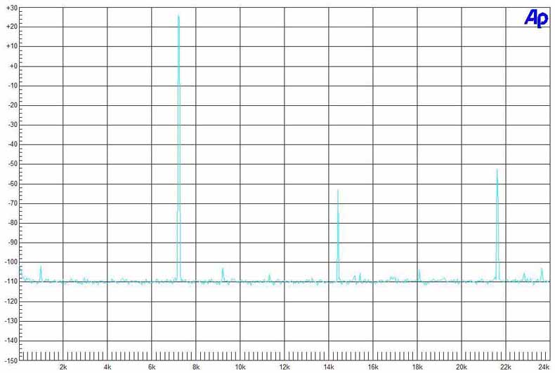

Hereby a FFT of 7.2kHz at 20Vrms in 8 Ohm load, of the UcD180.
I am sorry I can't give info about OEM customers they will not appreciate this. But when the amps are ready we can show you some details about the product.

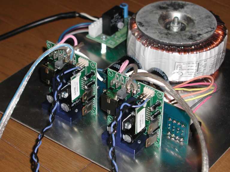

Hi xman737,
Here are two pictures taken from two different angles. The whole setup is still very experimental as you can see and this is sure not the final setup.
The first picture shows the view from the power supply side. I used a 250W transformer that gives about 2x32V AC output voltage. I ordered it at partsexpress in the US, the transformer should give 2x35V but in Japan the line voltage is only 100V while it is 115V in the US so I get a few volts less. The small PCB at the right of the transformer is a softstart module (from LCaudio), this module puts a series resistor in between the power supply and the transformer during start up and shorts the resistor after a few seconds. As a result, the peak currents for charging the power supply caps is reduced. Then just behind the transformer is the PCB with the diode bridge rectifiers and power supply caps of 10.000uF each. This gives me about 42V DC after rectification. This module is also from LCaudio, it is the Predator power supply that was designed to be used with the LCaudio ZAPpulse modules. It works perfect for the UCD180 as well. In the back are two UCD180 modules.
In the other picture (in the next post), you can see the two UCD180 modules from the other side. As you can see, I have soldered all wires directly to the connectors or to the PCB (power supply). I did this because I did not have the connectors and I prefer soldering above having connectors. I realize that I may not be able to return the modules in case of any trouble with them, however, I took that risk. I have used WBT RCA connectors and speaker binding posts, but I`ll be using XLR connectors in the final version. In the final version I`ll probably add a few more 10.000uF capacitors in the power supply.

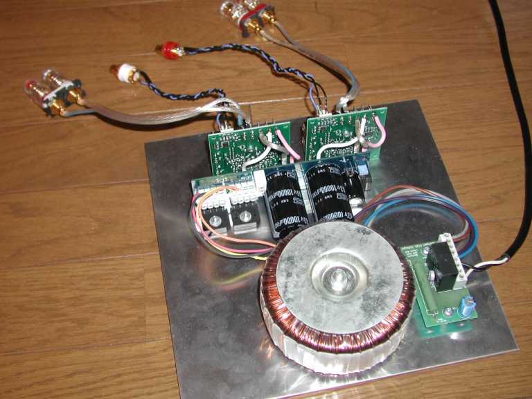

And here is the second picture
Hi, ghemink,
Thanks a lot! Very impressive setting and very clear introduction. I think I know how to set it up right now. I wish you can complete your active loundspeaker project early and share us your expirence. Thanks again!

Hi xman,
You are welcome. Building the active system takes time, progressing slowly. The speakers are almost ready (not yet in child-proof version so I set them up only at night in the living room), amps will take still a bit more time but I can listen to the speakers with my Marantz amp (4 channel Tripath) so I`m not without music all the time 🙂. They sound better than my passive B&W CDM9NT so I don`t really want to listen to those speakers anymore since my half finished 3-way really sounds quite a bit better.
Good luck with your project.

Hi all!
Jan-Peter, about 7.2k..
my experiments had the floating balance between 2nd and 3nd harmonics, which was changing by the changing loop components, however THD was kept (almost). Would be the even/odd balance different from sample to sample of UcD180 due to the tolerance worst case, with still around 0.013% THD?

Ivan,
We never tested a batch of the UcD180 with this FFT analyze. It's indeed a good idee to test a batch.
What do you mean with;
Jan-Peter
www.hypex.nl
