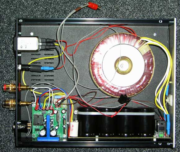

Thanks for the advice but I do not plan to use the same. I have nice 3mm circular leds to place on the front plate.
I will replace the led on the UcD module with a 2 pins connector.
I tested the mute circuit with the module. Works fine. I also replaced the original op amp with OPA2134.

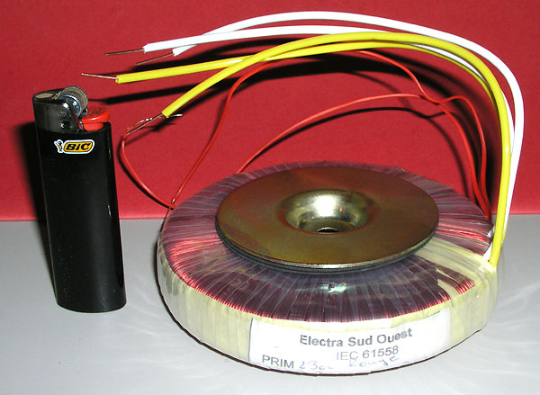

Actually Tx seems small to me (160VA isn't it Stef?), it's been said on one of the UcD threads that up to 300VA you don't need a soft start.
maxlorenz said:Won't you need an inrush current limiter for that big Tx and caps??![]()

I just received mine from Plitron (Canada) and judging by the picture I thought it had the same power as mine, 300VA.

300VA is supposed to be perfectly ok without a soft start either. In any case you can always try, there is absolutely no risk for the amp apart from blowing the fuse.
I did try and blew a 3A fuse.
Now I'm building an inrush current limiter from ampslab. It looks OK.

3A seems reasonably safe for a 230V country: rms current should not exceed 2A if you draw 200W with a power factor of 0.5 on low line. Did you use a temporized fuse ? (3AT)
Are you sure you haven't got a short circuit?
Are you sure you haven't got too much storage capacitance? As explained by Bruno in post 441, the correct sizing is 50000/R µF per rail and per channel you're powering, where R is the speaker's impedance, independently of amp power! E.g. if you have 1 channel and an 8 ohm speaker, the correct sizing is 6250uF/rail -> 6800uF/rail
There is a specialised thread for power supply questions. Yesterday I uploaded a diy-version for a softstart cicuit, built into my 4-channel UcD-amp.

2*4700uF definitely is not a lot. Try a 3AT or 4AT fuse. T stands for time-delay (and not "temporized", sorry for my english) i.e. slow-blow. With a T fuse you shouldn't need an inrush limiter, if it blows systematically you definitely have a short circuit somewhere.

My project with 4 x 10000UF + 160VA for one UcD180 works fine with an 1A slow-blow fuse.
You may be have a wiring problem. Disconnect the UcD and try the power supply alone. Check voltage at the output.
