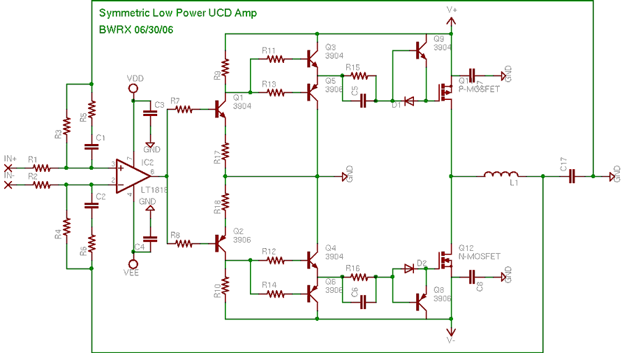

Ok, I played around with that first design and realized it wasn't very good at all. I played around some more in SwCAD before I had to go back to work, but since then I've come up with what I think could be a decent design. It's more complicated, but it is symmetric with a BJT driving stage and FETs at the output. If it works, I'd like to dub it the SLPUCD - symmetric, low-power UCD. When I have time tomorrow I'll work on figuring out some values for the driver stage and maybe try to tackle the feedback values too. I'm still a little confused as to what values would be a good starting point for the feedback components.
Please don't hesitate to post any tips, feedback, or suggestions about the circuit (whether you know what you're talking about or not! 🙂 ).
I used the LT1818 opamp because it can source and sink up to 40mA of current, has a high slew rate, and can work off of split supply rails. If anyone knows of a good dedicated comparator that can handle a split supply, have a rail to rail that can source and sink current please let me know. Most of the LT ones advertise split supply and rail to rail, but the output only goes from ground to + supply... at least it does in SwCAD.
Almost forgot, these are the supply voltages:
V+=12V

If you want to use a P channel, You could try a source follower arrangment for kicks. Also I believe you can simplify this somewhat by AC coupling the comparator to the drivers.
A thought:
I think you would get much cleaner and faster switching by not using BJTs that get driven into saturation as MOSFET drivers.
Maybe you could use emitter followers instead, or if you need to swing the gates rail to rail use CMOS gates to drive the FETs.
You both have valid points, thanks for the input. I have since read more into MOSFET driving schemes and have come up with a revised circuit. The driver part of the circuit simulates ok, but I can't seem to get the feedback values right to obtain a high switching frequency with the output filter (L=30uH, C=0.68uF) and load values (32ohm) I'm using. I'll post some part values later along with the SwCAD file so anyone can fiddle with it too.
Naw this there's a few other options like source follower or better yet dual n channel that puts far less transistors in the signal path. AC couple or go dual N channel with good level shifters.
Low power right?
We are talking low power right? Why all the complication with the output? As suggested earlier a 4420 as the output stage would be more than adequate. This could be powered with split rails but may require a means of level shifting for the input signal. http://download.siliconexpert.com/pdfs/2005/08/10/semi_ap/1/mcl/mosfet driver/mic4420.pdf
The only thing that bothers me would be if the amp didn’t oscillate properly the output would be full rail and would destroy any phones connected to it. Since we are talking high freq at the output a small cap could be used to couple the output into the filter, 1uf film? This would give the DC protection we need and also insure no offset.
This implementation would be good for several watts of power so could be tested with small speakers. Various input schemes could be tried including the suggested lm319. 2 chips and a few small parts implementation looks very good and would be very friendly to battery portability.
Sorry, but it's not just a high frequency. It's a high frequency modulated by a much lower frequency. The cap will need to be as large as it would in a conventional amp (A, AB, B).

What's your goal for this amplifier. Why class-d, what advantages do you think it has for a headphone amplifier.
Tim__x said:Why class-d, what advantages do you think it has for a headphone amplifier.
The idea is to see if a class-d amp built for headphones has all the detail and fidelity that the class is known for with speakers.
My guess is that at these low powers class-d will not sound as good as a good, simple class-a or a/b amp.
But let's see if Brian can prove me wrong!

Tim,
At the output pin we would have a PW modulated full frequency signal that only would require a small cap. After the filter we would have mostly audio and this would require the large cap. The only problem is this cap must be quite a bit larger than the following filter cap or we would have problems with interfering with the filtering and more importantly the feedback.

First of all, you shouldn't put the cap before the output filter with post-filter feedback because you'll lose all DC feedback.
Secondly, no a small cap won't work. The pre-filter output of a class D amplifier contains large low frequency components. If it didn't, ampliverters would be the easiest thing in the world to design.
I quite agree. My questions were rhetorical.
P.S. About the cap, think of it this way; if you remove the filter cap the amplifier will still work (if clocked or pre-filter) just with a first order filter, right? Now add the series cap, being in series, the order doesn't matter, switch the inductor and the cap so it goes inductor, cap, load. Still think you can use a small cap?

Those were my thoughts as well.classd4sure said:So it seems to me that at such lower power levels of concern, one could potentially push these components much further, and perhaps enough to more than compete with a class a/b counterpart at least.
Exactly. To quote a smart man "Everything should be made as simple as possible, but not simpler." At low powers you could use complementary devices and other techniques, but that doesn't mean you can't do just as well with normal devices or layouts running well within their limits. A higher switching frequency was one thing I originally had in mind for the design and that means fast turn on and turn off of the output devices. I don't know exatly what could be achieved with a very simple circuit but I'm sure a slightly more complex scheme would still outperform something simple at low power. For example the latest schematic I posted has some provisions for quicker turn on and faster turn off of the output FETs.classd4sure said:I think a number of designs of the simplest possible nature should be evaluated for this purpose, the low power gives alot of design freedom we normally would not find, and greater care towards layout should be the area of concentration.
The thing about class d is that a lot of transient current capability is required for the best performance - even at low power levels. If you want simple you can just use a comparator or opamp with a lot of output current capability to feed the LC filter but you can surely do better by using some FETs and BJTs for the output and driving stages, respectively.
I expected a lot of cynicism but that doesn't really matter. I like this project because it should be rather cheap and simple and is a great way to become more familiar with the intricacies of class d (for myself and certainly anyone else who wishes to follow along).
Hi Brian,
Hence my thoughts on using small devices instead of the usual high power mosfets.
Remember the razer. That will better allow you to push the speed while keeping transient current draw as small as possible.
What you could use is a comparator with emitter followers, AC coupled to complimentary mosfet drivers.
But then there's aspects such as source follower output stage that is worth exploring dependant upon where you find the greatest problem areas are, such as transient current or freewheel current or deadtime ....?
Chris
