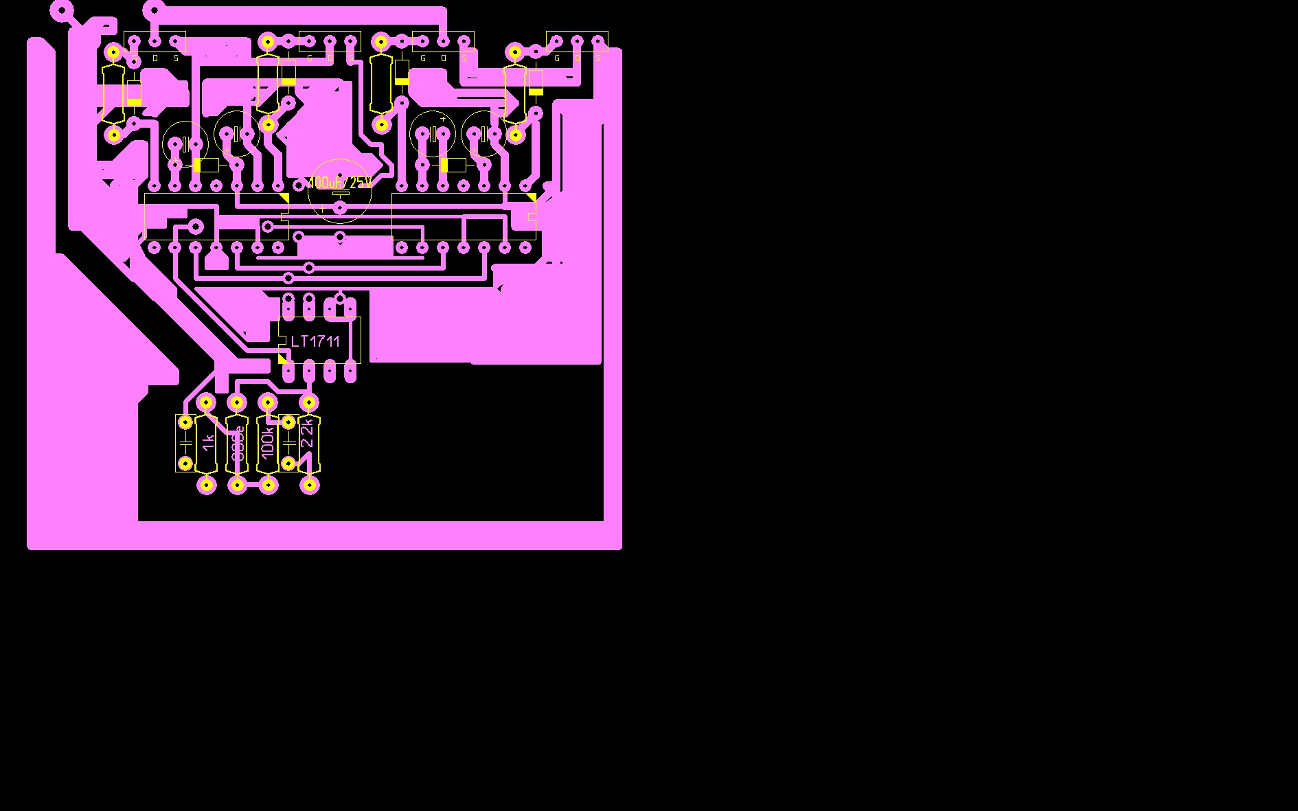

PCB LAYOUT
Hi Lorylaci
hello just need to know if this layout can work for the schematic savu posted its rough layout ground trace is around most components what more tips
must i do to make pcb suitable for this amp i am new to d class pcb designing
any tips are most welcome always a first time thats how i will learn

There seems to be errors with connections. Also you should check all the current loops, they seem to be going round noise sensitive tracks.

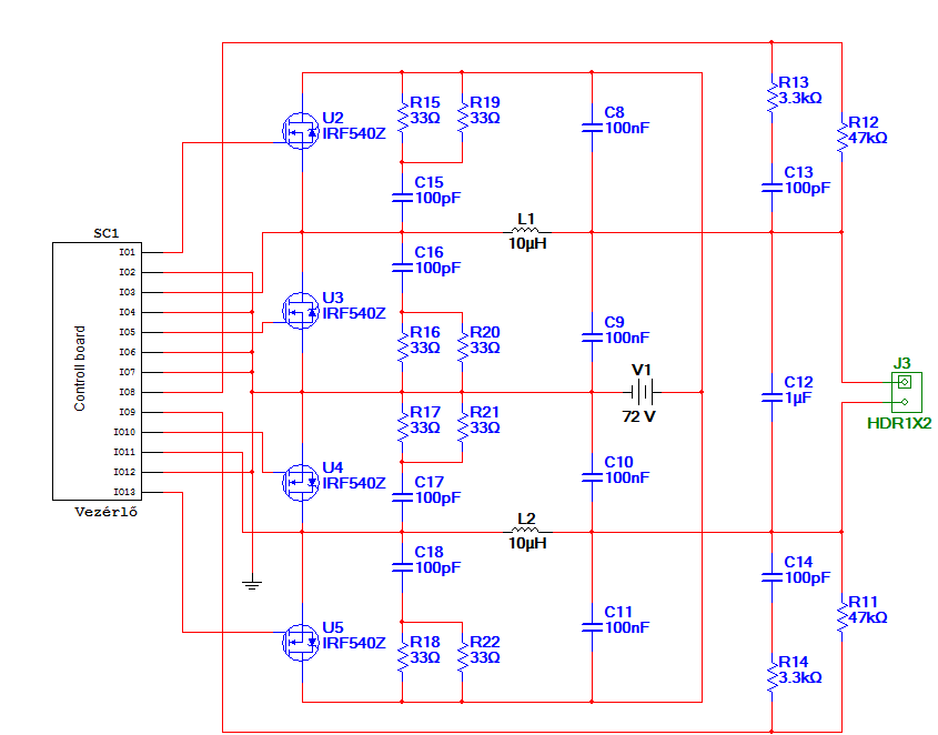

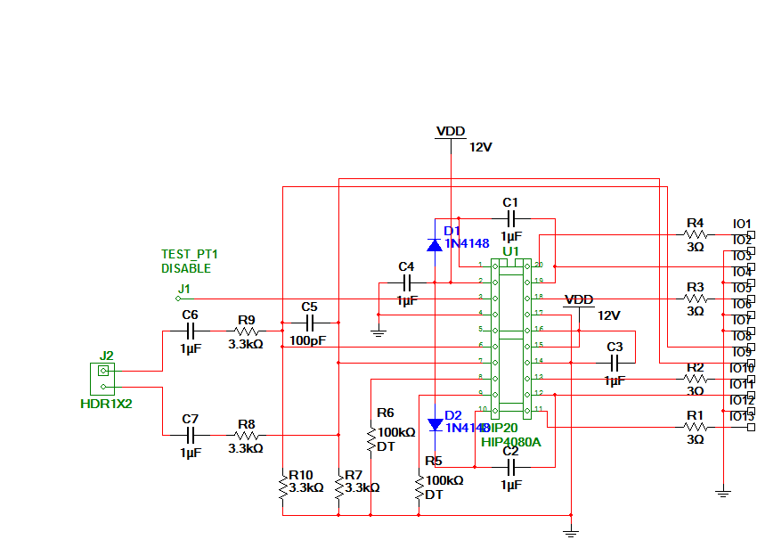

Are you interested in the HIP4080A plan? Its a full bridge (single supply max 72V), and I have a layout for that.
Hi lorylaci,
Its looks like great project, hmm i need to find hip ics first, i dont have it yet. and what about the layout? im not good in making pcb design, very bad ... damn.
Attached is the layout, in sprint layout format. I haven't tested it yet, but it is an amp based on UcD, and has a good predicted performance. HIP4080A has an ability to set dead-time, and has a very fast input comparator, and fast propagation delay. So modulation limit can be very high (which enables you to use the supply to maximum).
got it, but schema have comparator and layout dont include it? it works?
Please, use a little more specific english, because I cannot understand you.
HIP4080A is an integrated full-bridge driver, with integarated ultrafast comparator. So no external comparator is needed.
I haven't tested it yet, the PCB is ready, but I am working on my Master's Thesis Work, so maybe on Easter holidays.
im refer to this schema http://www.diyaudio.com/forums/atta...upply-bridge-ucd-referencing-signals-ucd1.pdf
which include comparator at the input stage and having fb out from it, but on layout u give me feedback is directly come from HIP and not using comparator, or maybe i`m refer to wrong schema.
The one you linked, is not my schematic. Mine is here: http://www.diyaudio.com/forums/class-d/207145-ucd-project-subwoofer-class-d-amp-full-h-bridge-single-supply-50-v-2.html#post2933972
gate resistor 3 ohm? I would try with cheap mosfet like irf540 without N, what about gate resistor? 27 ohm?
You must get at least an IRF540N, forget Class-D without good mosfets. Even for testing, an IRF540N will be bad. IRF540Z is cheap, and usually easy to get. I planned using FDP3652.
3 or 27 ohm? You must change the dead-time, not the gate driving resistor, to avoid cross-conduction (according to your chosen FETs). You can only use higher gate resistors for very small gate charge FETs like IRF6645.
