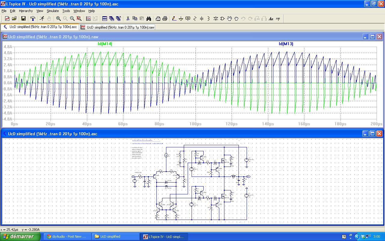

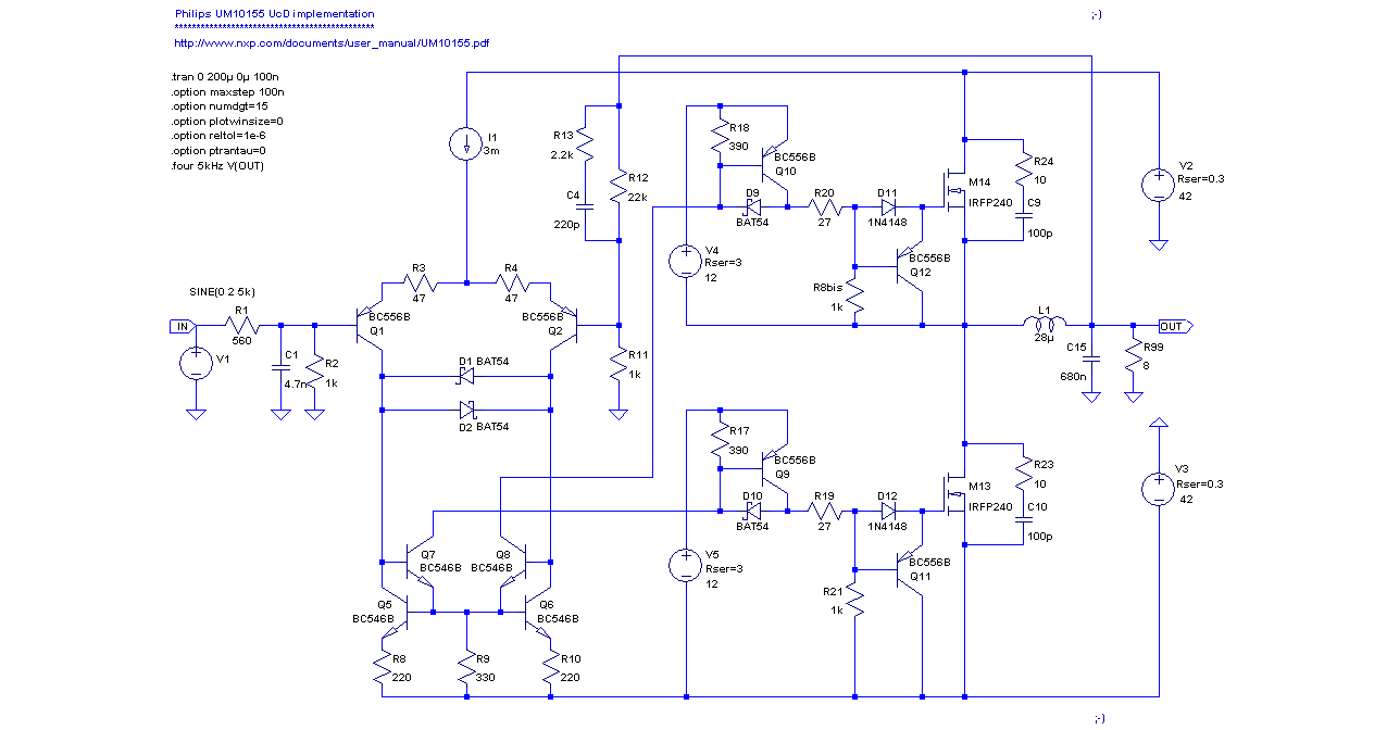

UcD Philips UM10155 LTspice simulation

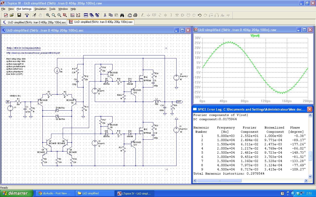

Hello, I had great fun simulating the UcD module Philips UM10155. Can somebody check the waveforms ?

In the philips circuit, R9 330ohm controls deadtime. As default the philips eval module comes set to high efficiency mode (long deadtime).
Play around with the value of this resistor and see what changes that brings in simulation THD.
Also play around a bit with the resistor in the phase lead network and see what changes a increase or decrease in switching frequency gives in simulation THD.
In the philips circuit, R9 330ohm controls deadtime. As default the philips eval module comes set to high efficiency mode (long deadtime). Play around with the value of this resistor and see what changes that brings in simulation THD.
Thank you, indeed R9 value is critical. A low value induces cross conduction spikes. A high value adds deadtime, preventing cross conduction spikes. Past the optimal value where the cross conduction spikes get eradicated, the distortion increase. Actually the lowest distortion occurs when there remain visible crossover spikes, same spike magnitude as the coil ripple current at idle. EMI will be badly impacted. This is of course on simulation. Don't know if the real world behaves this way.

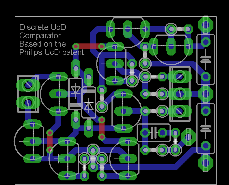

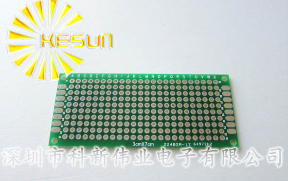

I think that you better can judge performance, by designing a single PCB containing everything, including the comparator/modulator, power MOSFETs, local power supplies, filtering capacitors and filtering coil. Will you try this? Please specify Philips and NXP components all-round. I'm willing to order PCBs for building such amp. Supply rails say +42V and -42V, no more.
That is what i was gonna solder it together on. That cadded template was so i know beforehand how to place the transistors and wires.
Either way heres the layout for the ic based UcD, which was ordered today from seedstudio, am currently listening to music on the prototype.

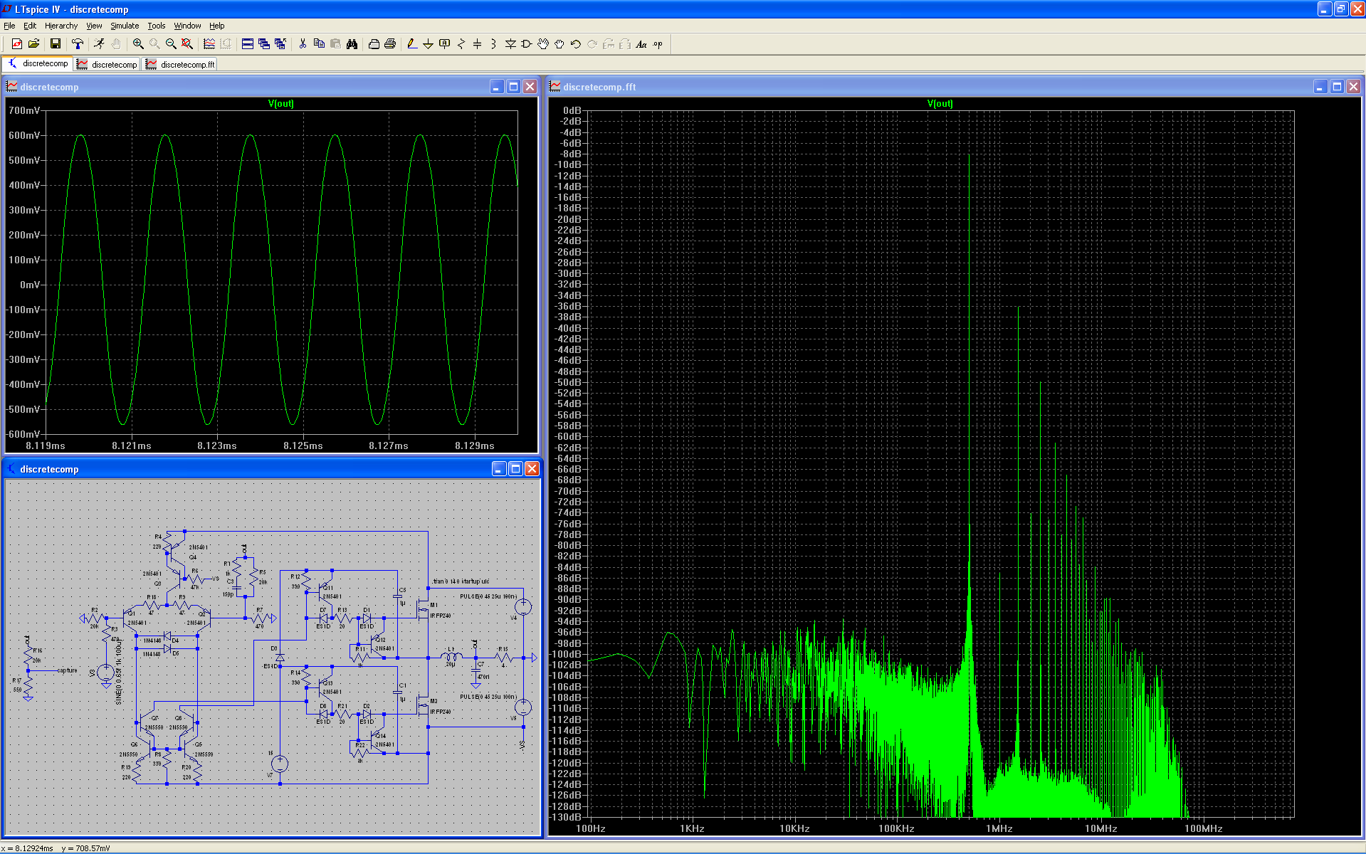

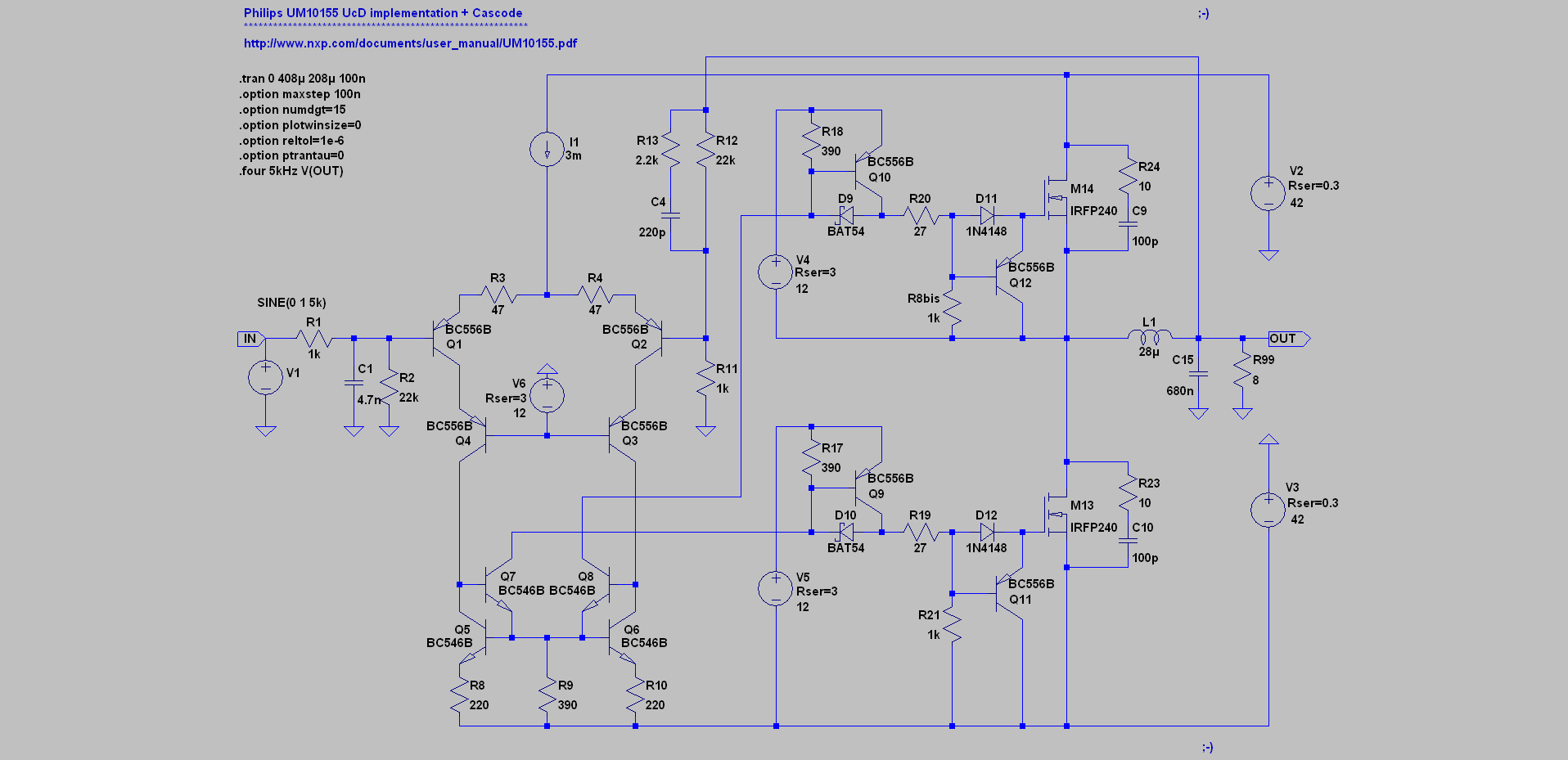

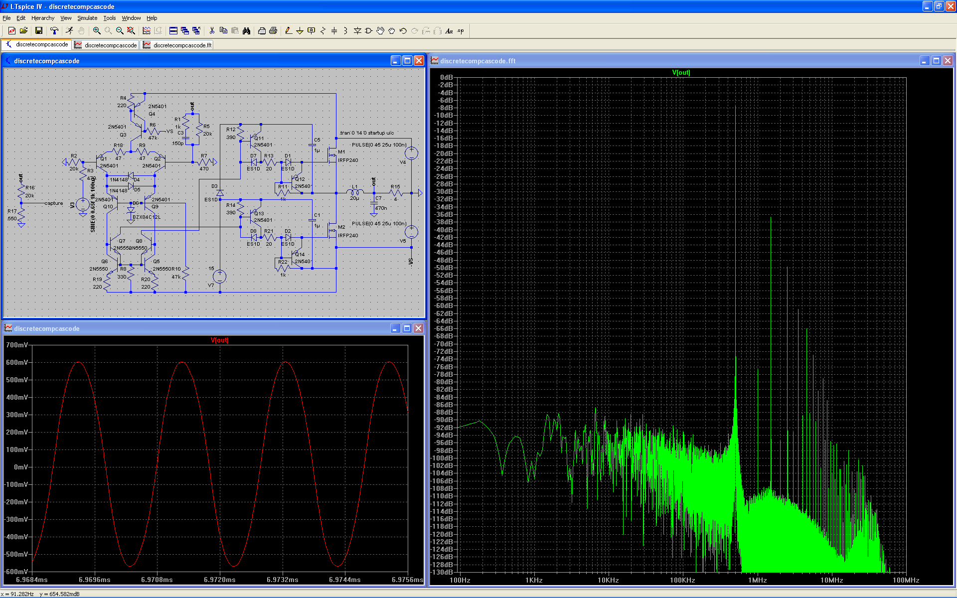

Indeed. The cascode worsens the noise by 6 dB. Is that an implementation issue?
Have you checked the THD?
I got interested by a cascode as it isolates the differential pair from the switching transients. Plot the current wavevorms in the differential input stage. Without the cascode, the differential pair collector currents are far from clean. I'm thus expecting a better audio quality with the cascode.
A THD decrease with the cascodes, would confirm such theory. Can you please check?
Regarding D4 and D5, aren't they supposed to be Schottky diodes?
Cascode seems to bring THD from 0.56% to 0.48%, as small improvement.
Apparently, cascode voltage can by anywhere between 10V to 33V.
I think you can remove D4 and D5 with the cascode.
Have you tried comparing the noise of a Zener-based cascode, with an ideal voltage source-based cascode?
I'd like to know the LTspice settings & FFT viewer settings for plotting the noise spectrum, like you did, for reproducing the plot on my side.
I'm astonished by the performance of the integrator as error correction feedback, exploiting the virtual ground error signal. It appears to divide THD by 10.
Does it work in the real world?
