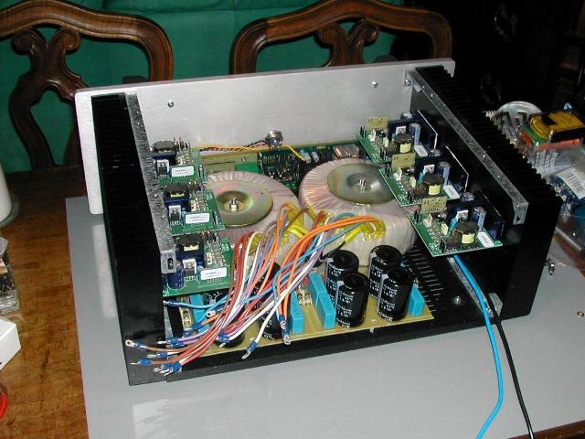

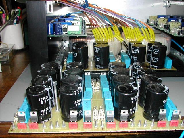

Yeah leakage is higher in new caps, but quite frankly, I think that's a load of ****. The little bit of extra leakage is just not going to fry a fuse.
I am now using a 6.3A fuse (yes, our outlet is 230W), and it seems to work fine. But I definitely will have the amp. checked out when I have the time.
Thanks for the advise!
lucpes said:
You can get away with as little as 1.6 uf for a highpass corner frequency of 1Hz on the input caps at the module. 6uf would be 0.3Hz and I don't see the point of going that low... (the series capacitor and the 100K input resistor to ground form a highpass filter) 😛 I have 1uf coupling caps at the preamp end and it works just fine...
Are you sure you can use such low capacitor?
