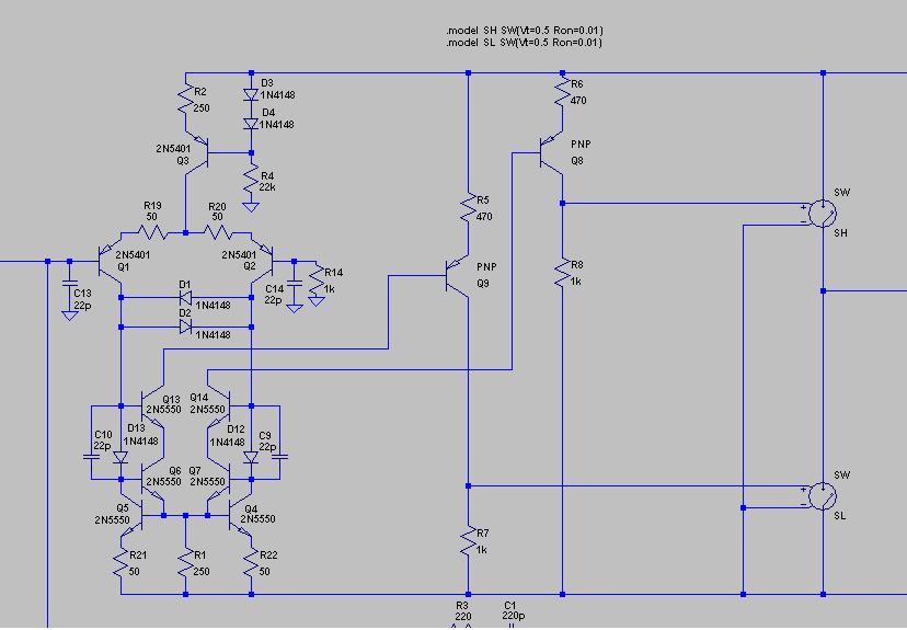

UCD/simu question
First post here
I am trying to make a UCD design and while doing my searches i found this post.
I always like to have a good overview and feeling of how the signals should look so i first started running the LTspice simulation of what kartino posted (post #52).
Then i wanted to try with only one stage comparator(like in the philips ucd design) keeping the same gate drivers. But if the operating point seems about the same, even playing a bit with the values i cant get this thing to work.
So I wanted to know if i am missing something specific the kartino design does that i am not getting.
Or is it just a simulation problem ?
Any help appreciated. thanks!
First post here
Re: UCD/simu question
Hm, you're not yet really messing with UCD designs but more so people's interpretations of them... everyone tries to add their own twist. You can find closer designs if you keep on digging.
There's several errors in your schematic, and you're going to have a real hard time figuring them when you're just starting off.
My suggestion to you is start off by studying the real thing. That means look up the patent, study it, look up the AES paper on UCD available at Hypex.nl , that alone should solve most of your issues.
You'll then be armed to start figuring this stuff out, along with some practice on the simulator. I don't know how long you played around with this but I'm thinking, not nearly enough.
I see no model statement for your pass transistor.
I see a run time of only 100us.
I see your input signal is 0Vac
I see you taking feedback differentially (not made obvious by the schematic but what do you suppose that network is connected to the non inverting input your signal goes to.... ) and driving it single ended..
I see your feedback networks are improperly terminated.... c4 for instance... there goes your proportional gain.
If you manage to solve all that, you'll just need different resistor values for your driver turn on transistors.... try 300ohm. Then you'll get some waves. Also notice these are Kartino's tweaked drivers... not the real thing, you'll note that from the schematics in the proposed writings.
You've much work to do. I hope that's some help, I know it's not much, but it's clear to me you haven't put alot of time into it so far.
If you have to, dig up a simpler version, idealize what you're uncertain of, and read up on how it's supposed to work.
I'll be happy to help out more later. Welcome to the forum.
Chris

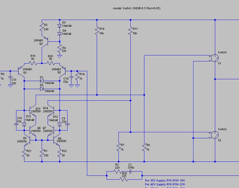

well thanks for taking the time to answer.
This is true i am new to class D amplifier design and just starting learning how it works. The thing is i started with a working design and maybe i wanted to add my changes to it too quickly heh.
As for LT Spice, i am not an expert but i did some simulation with it for some other class AB amplifier with no problem before.
Anyway it just tells me i need to get in it more deeply as it is surely not something simple.
I ll get back here eventualy when i have some progress.

Yah, I just saw more than one problem with it.
I'd go for DC coupling the inputs BTW, one less source of confusion.
I managed to get that sim going but making all the changes mentioned. Maybe they're not all required.
Feel free to ask whatever should you run into a wall though. It's a great circuit to learn from.

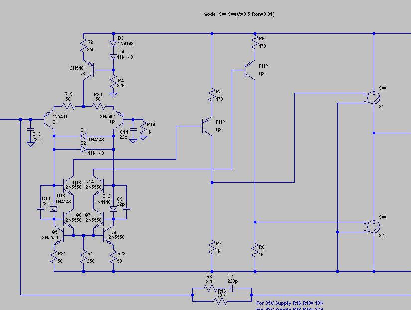

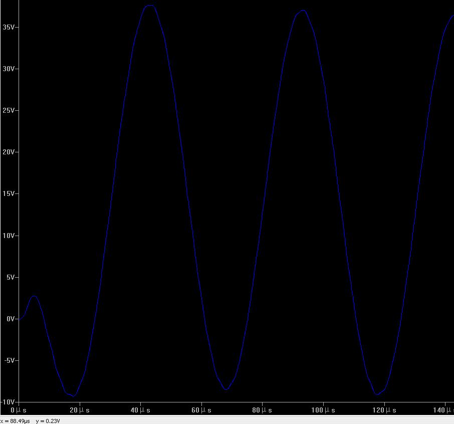

yes, i did do some of the modification you suggested. I also changed the gate drivers to their simplest version, like the one presented at the hypex.nl page. Also changed the feedback for a DC coupling and put a little less gain. (also simulation time because capacitors takes more than a few periods to load heh.)
Now the circuit is a little less confusing and i think i understand better how it works and what each part does.
there are still some points i need to clarify a bit more (for instance i am not sure of why the 2 diodes in the comparator are needed)and then i can go on and try with more optimised design i guess.
Also tried to change MOS models but LTSpice doesnt like it too much . but thats another problem...
Anyway i ll probably spend some more time on the forum the next days to learn more .

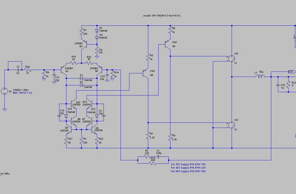

kartino said:Hi,
OK, I thought that fokker will use discrete driver. BTW I have turned version, see on attachment.
Hi Sir,
What do you think, would it work in real life? Or only in sim?
I'm quite interested.
Thanks,
regards,

but to your point, I am building a pwm generator to test the driver / output stages independently and we shall see.
Baldin said:What voltage are you using for the driver? I think it should be 12V to make sure there is enough juice to switch the FETs.
that's a great question. I initially ran the set-up at +/- 8v and it didn't work. so I suspected that the ULVO circuitry in the driver was at fault. so I ran it at +/- 32v and I got the same thing. so I am now back at +/-8v.
Baldin said:What did you mean by running the LM5104 through an adapter?
the 5104 came in soic form. so it is hard to use it directly on my breadboard. I soldered leads to it, rearranged the pin-outs so that it mimiced that of ir2011 (5104 doesn't have the L-in pin), and fixed it to a dip socket. That way, i can plug it right into a ir2011 circuit and it works right away without any need to rearrange the breadboard.
