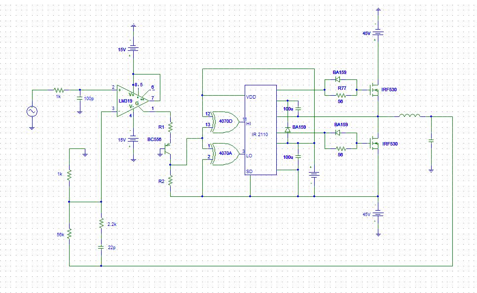

I want to build a UCD with the following specs:
freq=250kHz.
s/woofer = JBL CS1215, 4 ohms, 275W max.
req amp power = 200W.
Unfortunately, i have no access to an oscillioscope 🙁. and would like to get help on the following:
1) How to calculate values L, C for output filter?
2) Is a gain of 56 problematic?
3) How to provide the GD power supply with good peak-current capability?
4) How to work out values for the resistors around the level-shift transistor?
Schematic attached.
Thanks in advance.

Do you think you need some special LC filter because it's going to be subamp ? No, you are wrong. Use 30uH and 680nF. These values are used typically ( at least in diy ).
If you want to use it as subwoofer amp, then you need active low pass filter on the input side. Btw.
Lout = Rsp / (2 x Pi x Frolloff), Pi=3.14
Cout = Lout / (4 x Rsp x Rsp x K x K ), K=0.707 typically value.
"thank you Vienna tom, but would you please share your idea on getting LC values for the filter? "
I can propose a good starting point for LC filter values if u tell me exactly what load impedance (min and max) and what bandwidth (sub or full range?) it should be designed to. I assume fs in your design will be ~250kHz, but for full range, 400kHz is better, especially with varying load impedance this would give more freedom to choose L C values...
BTW: I really dislike the old mosfet type you have choosen.... there is many way better parts (try to seek for parts with as low body diode reverse recovery as possible as well as low Rdson while the Qg is still reasonably low). Save 2 or 3 bucks on the heatsink and invest 3 bucks on better FETs - this can push efficiency up at no extra cost, but u get smaller size and weight.....

PLEASE - no parallelling of old junkFETs - look at the latest low voltage Trench-Series of the different vendors FSC, STM, IR, Infineon, Vishay,....
Think: 100 V TO220 is available down to less than 4 (!!!) mOhms now
http://www.fairchildsemi.com/ds/FD/FDP036N10A.pdf
I do not recommend this type, but listen: take this as a starting point for thinking and search for devices with smaller chip size (same case). As you go smaller chip size (=higher RDson) keeping the same latest trench technology you get: 1 lower cost, 2 lower reverse recovery, lower Qg... lots of advantages - maybe you ll find your optimum part at...say somewhere between 10 and 30mOhms - there is tons of available and cheap FETs out there.

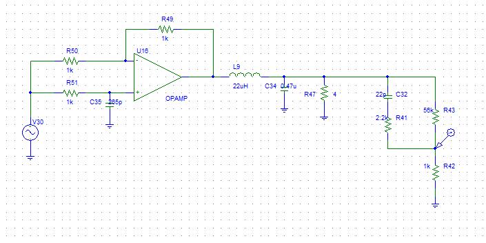

Hi gogo,

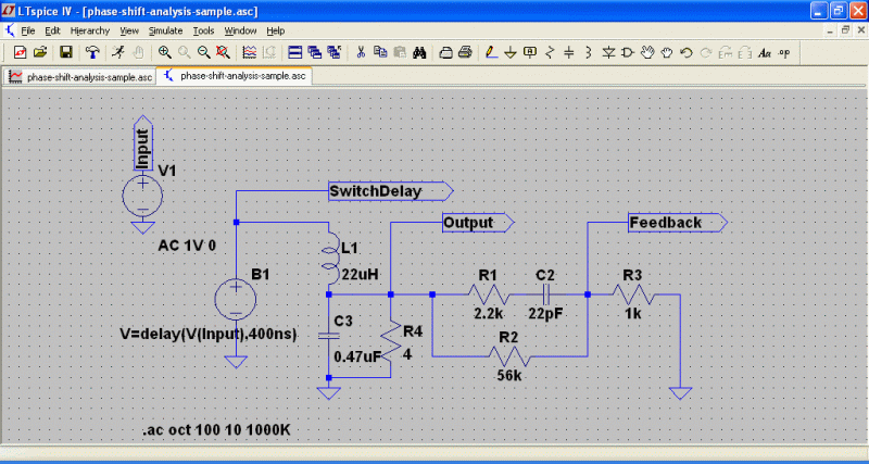

Got it man! But the problem with me was that i was using PSPICE schematics and orcadwhich does nt have any option to delay analogue signals such as sinusoids (to my best k'ledge). But you have it there in LTspice.
However if you re familiar with schematics, please tell me how to implelement delay of 400ns.
Your design seems to oscillate between 500kHz and 600kHz, is that right?
Hi gogo,
Sorry I don't know how to use Orcad.

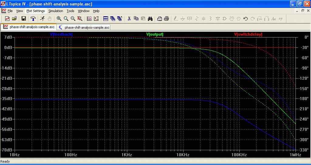

The delay is the total delay of comparator, level shifter, drivers and mosfet output. The signal once leave the comparator becomes a square one instead of sinusoidal.
I learned ltspice model of delay from this thread.
http://www.diyaudio.com/forums/class-d/159707-ltspice-delay.html
Actually you can play with the ltspice file I attached in my previous post.

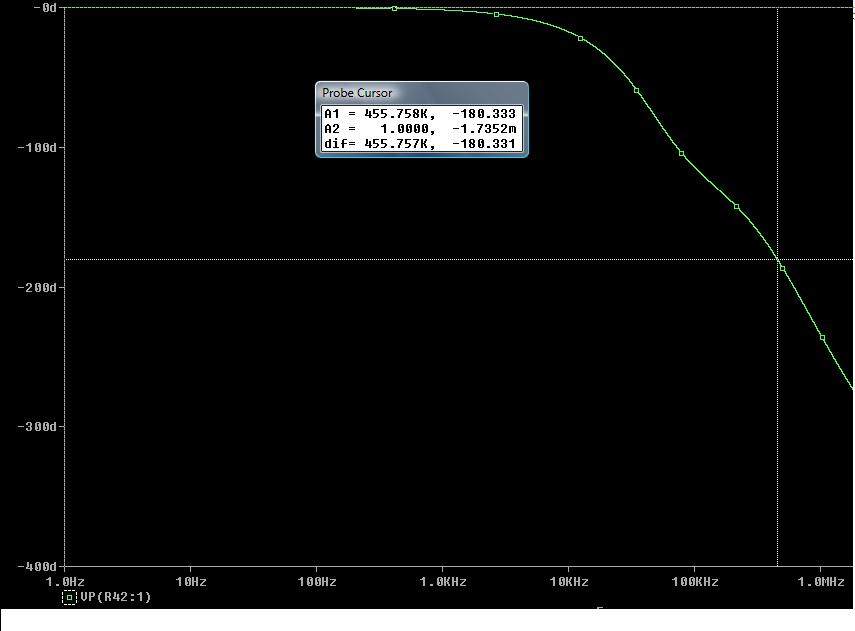

The schematic I posted is not an actual one but just picking up some parameters from yours. Yes, you're right. It should oscillate between 500K-600KHz.
What I've actually done was that, I built a UCD circuit without closing the feedback loop, measured the actual delay by injecting square signal into the comparator, use the simulation to design the parameter of the Phase Lead network, and finally fine tuned it experimentally. You need a scope to do so though. 😀
Is that right ?
Just read 500 or 600 instead of 455kHz.
And the phase lead n/w is to push the phase crossover freq to the desired value........okokok
Even i think i ll need a scope 🙂
