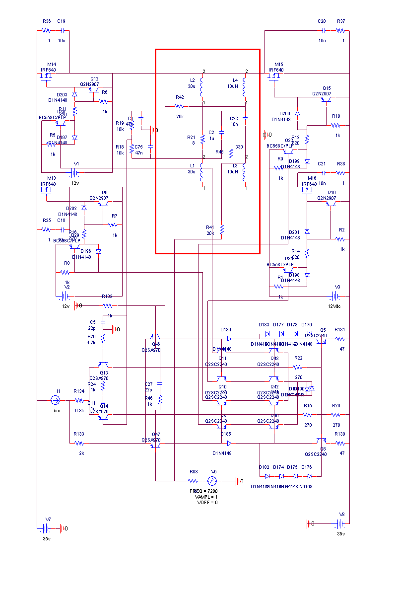

Konrad said:
This seems to work!
Basic circuit without classd4sure's input stage.
The input/controll-cuircuit shown by classd4sure would improove performance as open loop gain also in higher.
Abt the open loop gain have someone tried higher open loop gain?
I mean like replacing the resistors R121 and R122 with smal caps in Classd4sure's input stage ?
Yeah I had tried that, wasnt' able to get it to converge, doesn't mean it can't work of course. Also tried a cap parallel with the feedback resistors you mentioned .... and in series...sadly, non converged.
Kind of hard to follow it but..
The diodes in the comparator will pass no current.... it will actually "compare" with them totally removed, but not as good. I'll go out on a limb by saying this but I think they add a small measure of hysteresis to it which it seems to like. I've changed them to schottky's as well for the "hot carrier" aspect, trr characteristic.. faster and cleaner switching I thought. Maybe someone more qualified can comment on that.
What's the purpose of the ground between RC going to Q13?
That should be a small signal schottky diode for the baker clamp.

YPP ! There is definetly som more attention abt the clamping to bee done, as the shot thru in MKII is high(!) the implement of "Bruno clamping" and some value adjustments/rearrangement, it became much better.
Also adjusting the Ton time ( switch losses then neads attention) by adjusting R11, R12, R14 andR16.
i belive we will end up with somthing like Toff<Ton+(R*Cin) choose biger than minimum R will increase losses caused by exstended Ton. At the same time bigger R will reduse shot thru, here is definetly some energy / timing to take care of, after the clamping net is improoved.
But with better or 'Bruno clamping' and 'minor' adjustments in the resistor network arrangement is the place to improove the circuit "ballansed comparator with added feedback" as i see it as a unit behavior. In a different tread under Digi amp there were som suggestion on a simplified way to calculate the fiter/ and outer timing and internal delays.
Abt lower driving voltages for the output dev ; Yes lover voltage is a must! there is in some datasheats a internal zener gate-sorce it's important not to damage or overdrive, current limited by R, V drive and 'internal-zener'.
Uh! these output devices ! :bawling:
Well after a little fidling;
Different clamping- "Bruno clamping"
Timing controll to remoove shot thru; Ton>Toff
Feed forward switch diodes in pre switching stage.
It simulates ok, a little bit slow maybee. :smash:

Is common mode feedback truly a necessity? It's my understanding a truly "differential" circuit does a fine job of rejecting common mode voltage, and it certainly seems to.
Granted if you can get a decent cmfb working well, great, but I don't feel it truly requires it. Rejection can be further improved by a simple change to the output filter as well.
Chris
If you use a single differensial to handle a bridged output. AND you tend to use outer coltroll amps what will happen when thiese have great offsett on their output?
If your using two differensial stages and then bridge, its directly comparable to two separate amplifiers in bridge konfiguration. (like bridging UCD 180)
With one differensial pam you must have some way to avoid the controllers go into klipping. (nested feedback loops)
Else it should not matter much if there is some common mode on the output. Also this form of common mode rejection is NOT the werry best, and i belive just abt sufficient enough.
Thou it can bee improoved by moving the feedback to common base but with more components involved.

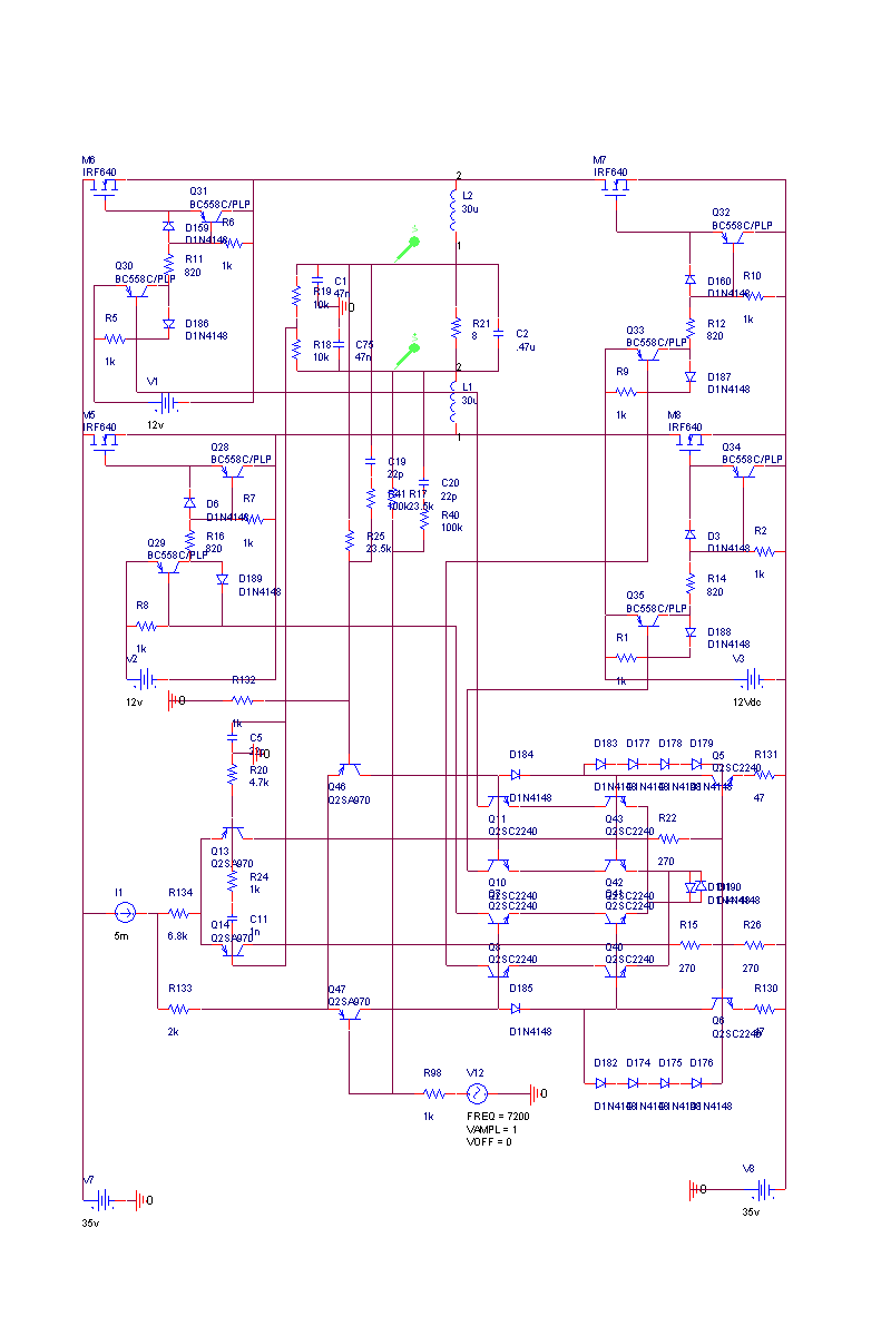

Thanks reply.
There is two Things neaded a closer look;
The Ton/Toff at the mosfets, if i want to have plenty safetymargin and not going for a shot thru. If i go for a single resistor on SWITCH ON pass there will bee to much switch losses and less losses givs more shot thru.
This can bee solved by placing a smal delay before the first "SWITCH". Delay by R30 R31 C11, C12. hence redusing switch losses at the next stage is a possibility.
Someone mentioned somthing abt dv/dt limit at the gates of the mos, this i have litle knowlege abt. But this may sertainly bee somthing to bee avare of.
Switching the mosfets of hm there is a smal coil in the lead and... better protect the driver by reverse diode D218, D219, D220, D221.
Reconfiguring again! and this time to bistabil toggle, thus having two toggles in series.
Remember Bruno saying there should bee another 3 components in the circuit loading the input current, and all is passive R24, R25, R26 makes the transistors here Q5 and Q6 act like a bistabil toggler.
The C2, C3, C4, C5 and R3, R4, R6, R7 is my estimate for the noise killer around the output switches.
Its abt time to start prototyping:devilr:
Maybee i should make som pcb's as well 😀
someone claiming PCM triangle modulation microcontroller stuff etc.... well i prefer this simply of beauty!
Thou its still simplifyed, and the rest of it ?
I hope someone likes it !
I've re-optimised my circuit, and made a few very minor changes.
I should add that I've also tried numerous variations with the driver stage, it remains the same because nothing else has matched its performance, and so I think it's the best version to start a prototype with.
Shoot-through is respectable with only one large spike over a 10 cycle period at full power/20khz. At anything less than full power, it is virtually eliminated.
Coupling caps can easily be added for anyone with a DC offset problem on their source, without affecting performance worth mentioning. It simulates well with a DC offset of even 100mV, but it will offset the output as well.
I'm not concerning myself with common mode voltages induced in the feedback paths, I think that's best left to a proper layout.
I'll take a few days to complete another another range of simulations to fully prove the design, and I'll include the shoot through graphs as well.
From what I see thus far, however, THD results seem a bit worse than those first posted here, but not much, and are still somewhat impressive.
