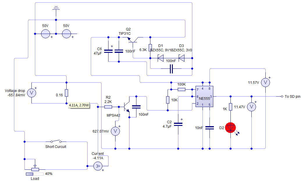

UCD 25 watts to 1200 watts using 2 mosfets
Because lower disipation of shunt resistor, I will use transistor instead of optocoupler. Now voltage drop is 0.7V
In simulator it works (schematic like Luka's)
Rsens = 0.7V / (Ucc/2Rload*2*sqrt2)
Rsens = 1.4Rload*sqrt2 / Ucc (1.4~sqrt2) =>
Rsens = sqrt2*Rload*sqrt2 / Ucc
finaly
Rsens = 2Rload/Ucc (=) Ohms

I made a mistake regarding my wire/inductor protection...using an inductor with a core with value>1uH is not recomanded because it will be too sensitive to noise...🙁
Aditional residual filtering should be made elsewhere...thanks Pafi for clearing that up..🙂...so a low inductance(<1uh) wound wire is recomanded..
Dzony988 use optocupler/level shifter for ir2110 sd pin and faster detection if you love your transistors..😀
I said optocoupler for comunication with ir2110...
With optocoupler for the detector yes you will have 1.0-1.1 volt drop..if you decide to use my protection i thing you will get away with 400mv drop but i do not think you will have the pacience to sort resistors and obtain minimum error...:no:

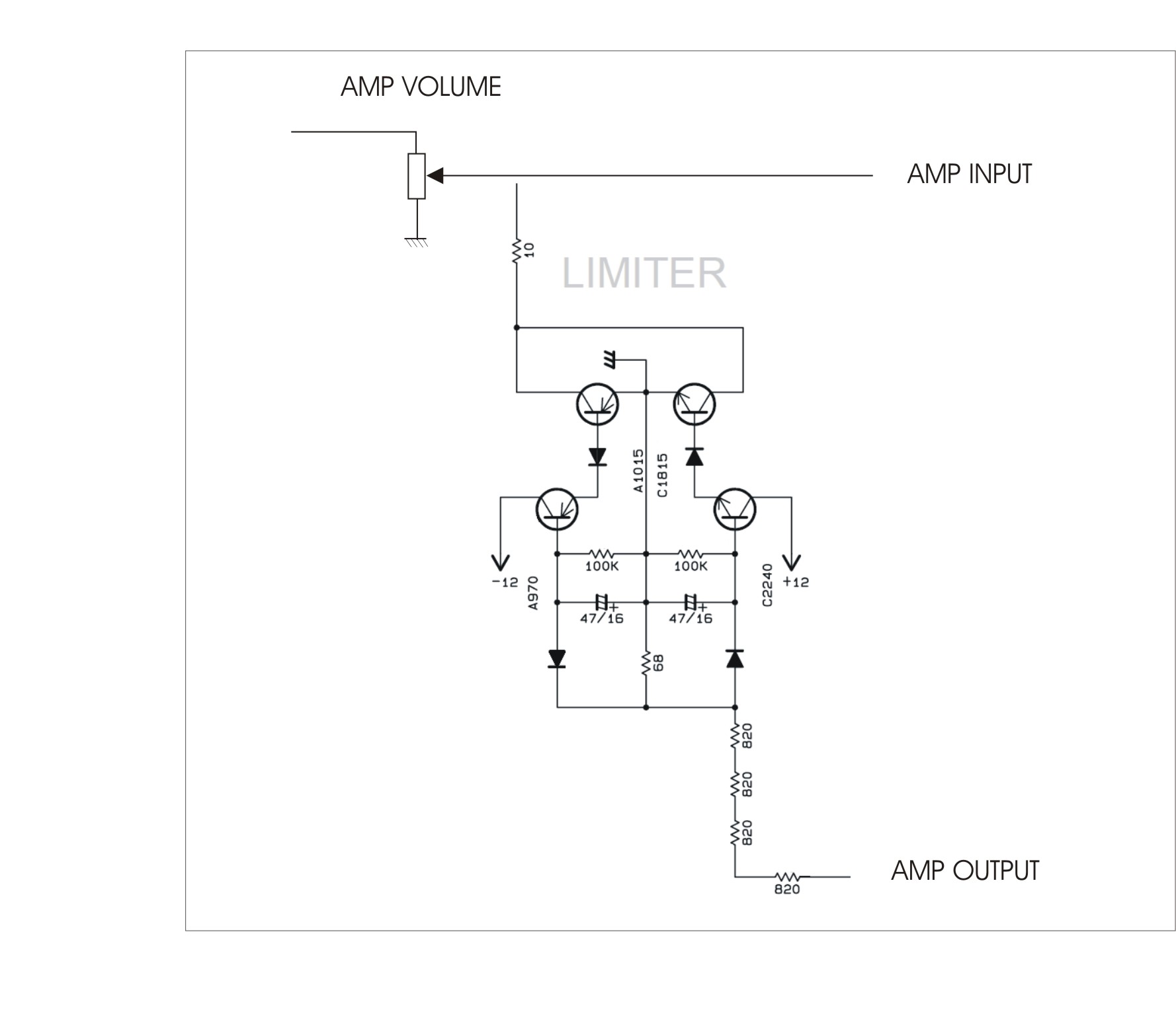

Do anyone have curcuit of input signal limiter but without optical elements. I try in simulator many of curcuit from google, but it doesnt work or has lot of distorsion.
something good what you used?
Reason why without opto elemets is because I dont like it and bigger rison is that I can only find photo resistor LDR07

try this its from APEX should working very well
