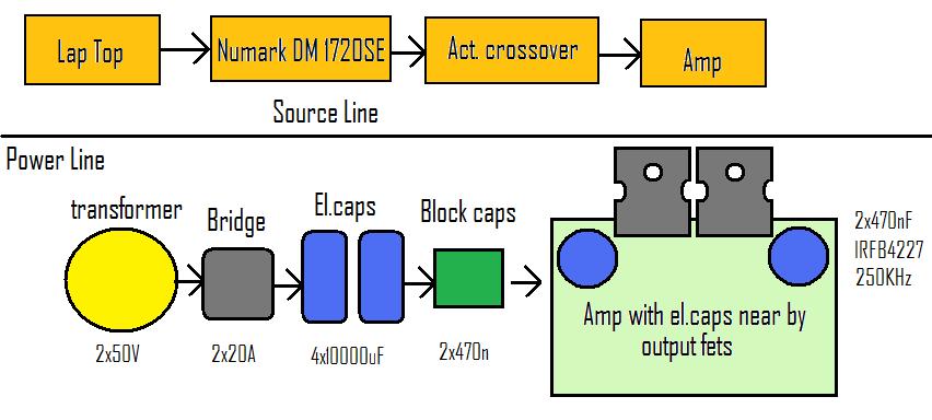

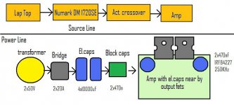

- Signal source:
Toshiba lap top--> Numark DM1720SE--> Beringer CX3400 act.crossover--> my amp
When I play directly form PC result is the same.
- When I short the input cable on begin and end, noise disapire.
- Core is EE33 from PC atx swich supply and i dont know nuber of turns, I forgot but I think it has 15-18 turns. Gap is 2mm and its very difficult to wind the wire to avoid the gap. Its very hot
- To understand each other, noise on my amp isnt big and loud. When I come in front of the speaker, very close then I can hear the noise. When I 3 meters away from speaker I dont hear anything, but that annoys me because this amp is good, produse good sound, very powerfull bass and this is the little things that ruins a good amp.
Thank you Pafi, and I draw to you Source and Power Line.
