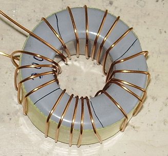

hi ionutzxpo how much are they and which web site or manufactures can deliver to east africa if you order like 5 pieces .
you can try ebay. 1.5GBP/pc
Radio Toroid, P/No: T130-2, Manuacturer: Micrometals - eBay (item 390047924056 end time Dec-20-10 00:44:02 PST)

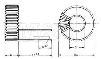

I will try to find T130-2 (ebay). From my calculation uH=(Al x turns^2)/1000
20uH=(11 x 43^2)/1000, then I need 43 turns on this core?
I tried a T106-2. 10 laps 1UH ONLY

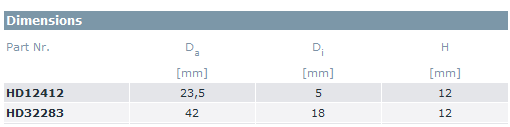

I find in my contry ferite cores
1)HD12412
2)HD32283
3)HSD3606
4)HSD3622
Can I use any of them for uotput coil?
Yes.

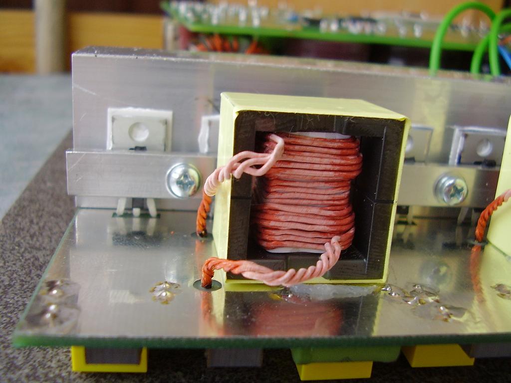

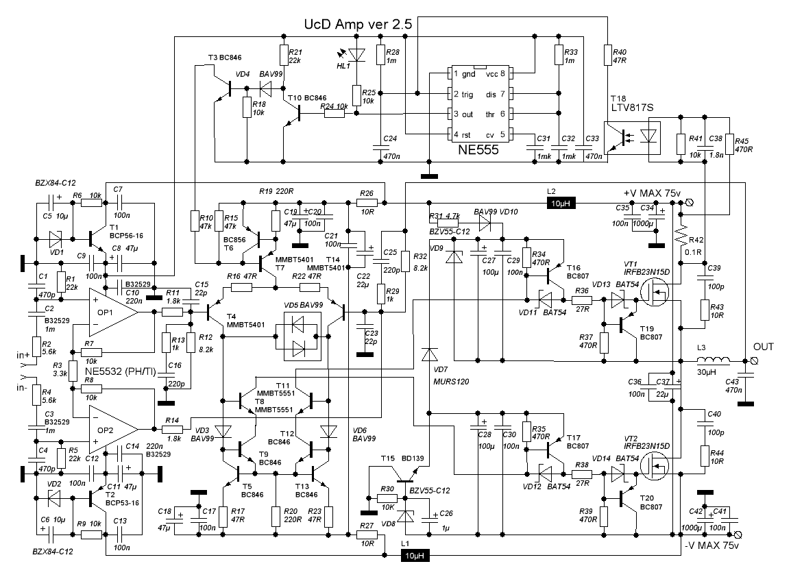

Have you measured your switching freq yet? The original schemetic with the original phase lead network gives a switching freq of 120kHz. The corner freq (-3dB) of your filter is about 50kHz (at 4.5 Ohm), this means about 20dB filtering only, very poor. The 1mm gap could be enough to protect your core from saturation, but you can have a very high ripple current at the inductor.
Lorylaci:
I dont know my switching freq, because i don't have osiloskope or other instruments... In original schematic output filter has 30uH and capacitor 1.5uF. On my amp output filter has 20uH (24 turns on t106-26 with gap 1mm) and 1uF. Output coil and core are very very hot (on high power on 4ohms speakers with +-50V, output coli after several minutes begins to smell the heat).
Sound is great, output transistors are cold even on high power and I have full audio spectar.
What are you suggest that I do?
Important to me is a great strength, a little heat and a full range of audio spectar and classic sound quality, I dont need absolute Hi-Fi, I need for the parties

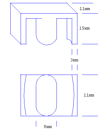

Hi Pafi,
can you make a measurement of your ferite EE core. i got below sketch of my E core
thanks,
