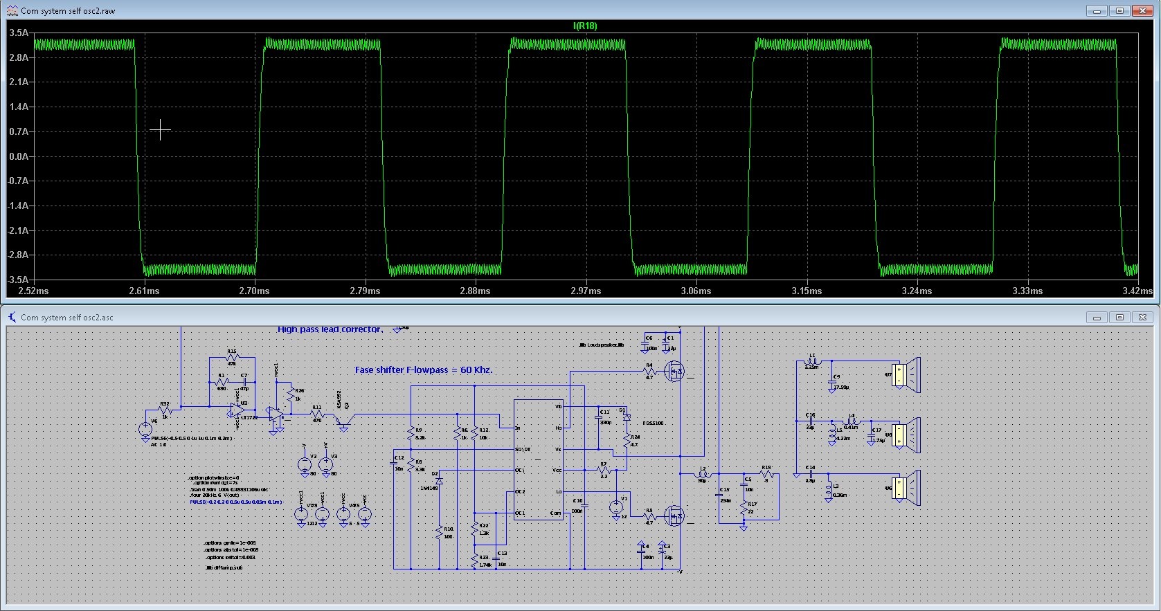

nice design , looks promisingI am also busy with design, a other version who is not the same and still in front end condition.
Give nice 10 khz square.
I am learning about class D I do not now it will sound well but it did pass through a triangle in very clean state.

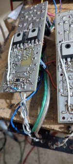

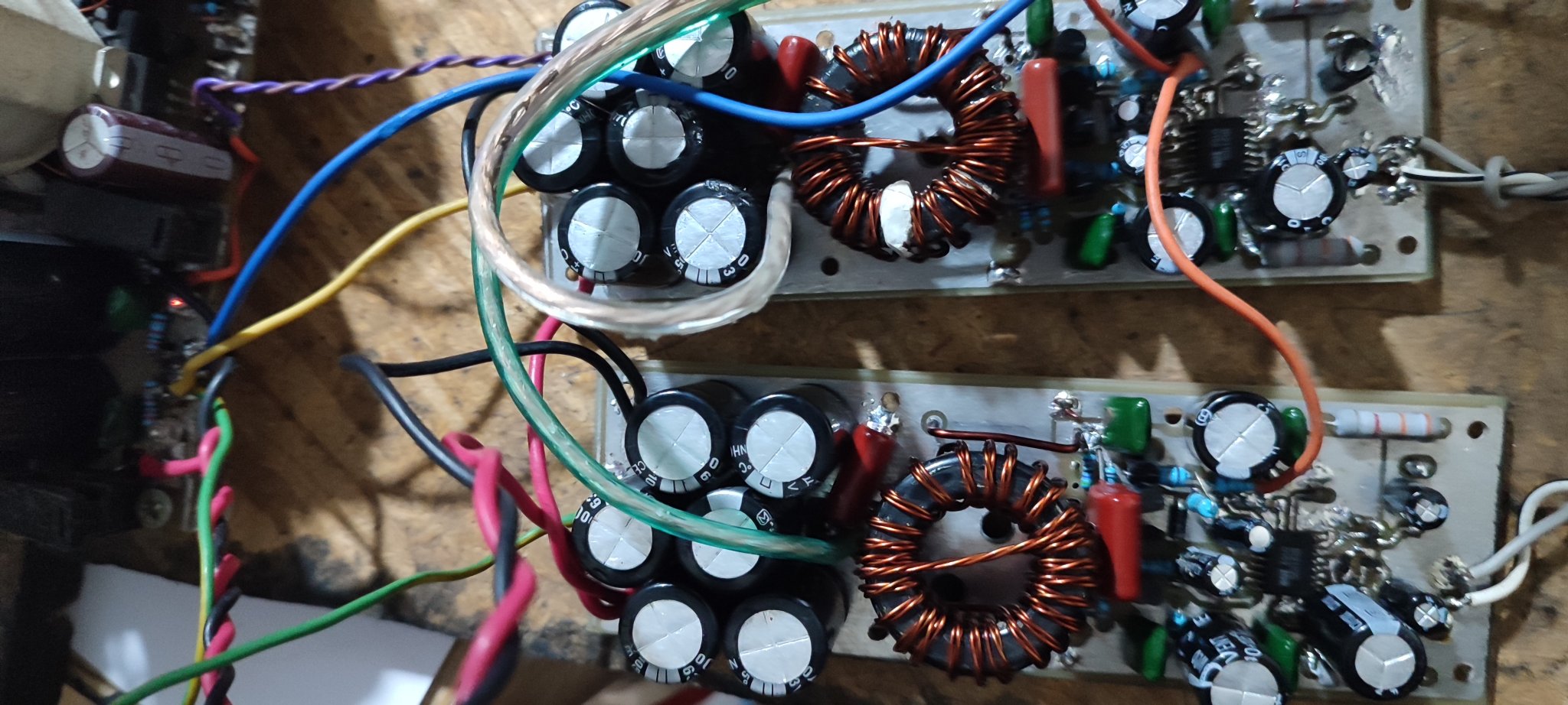

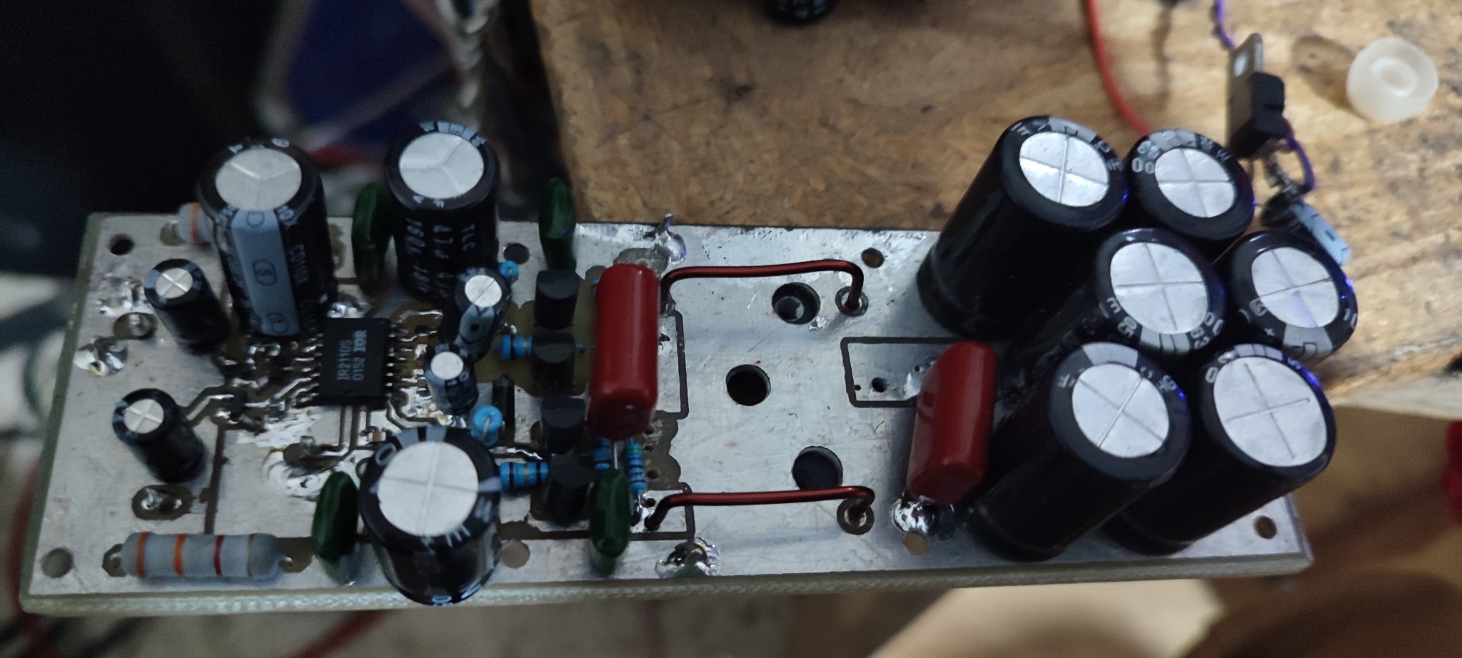

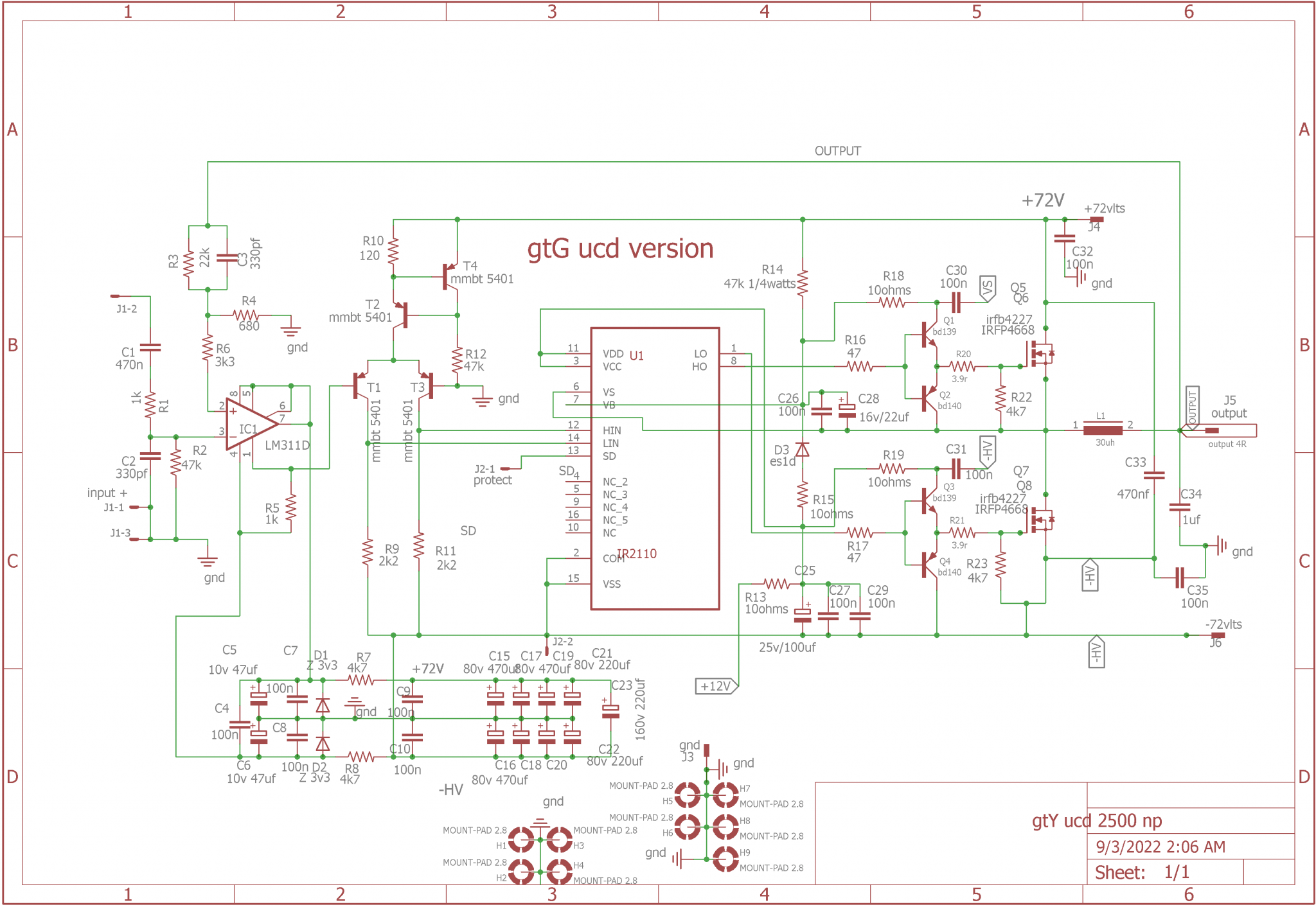

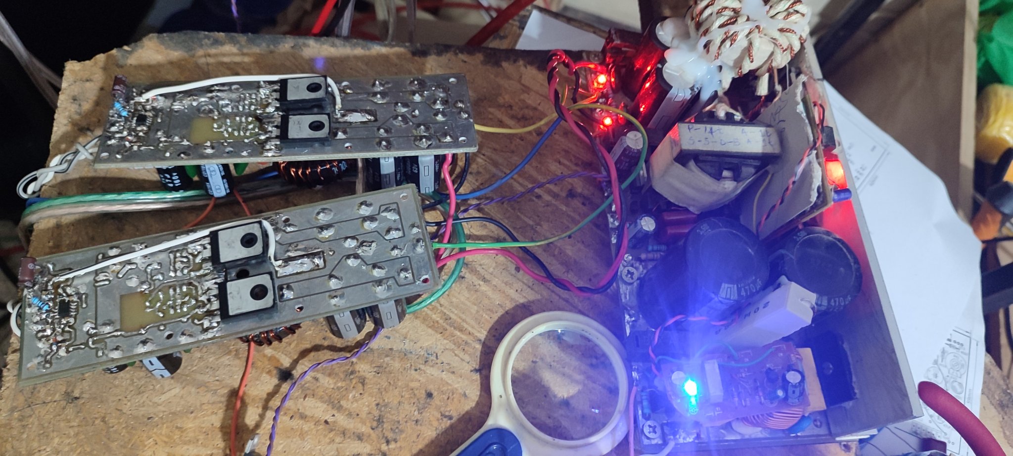

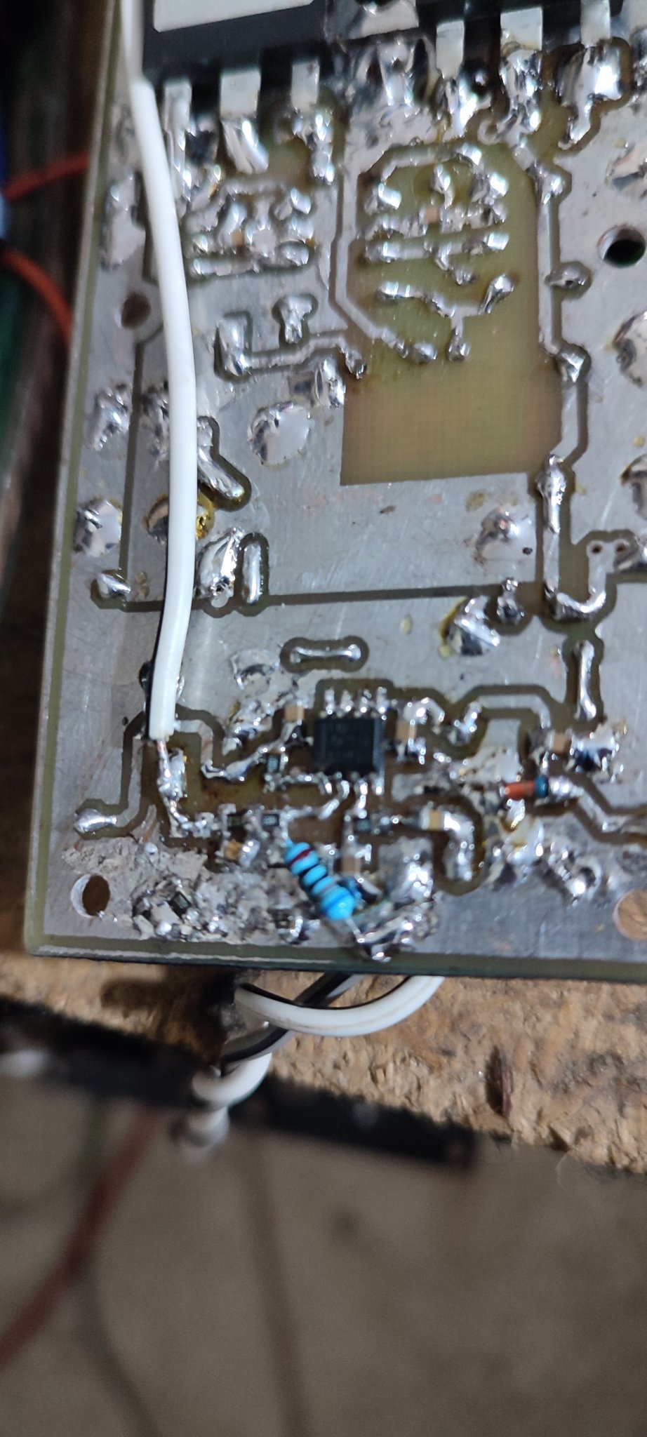

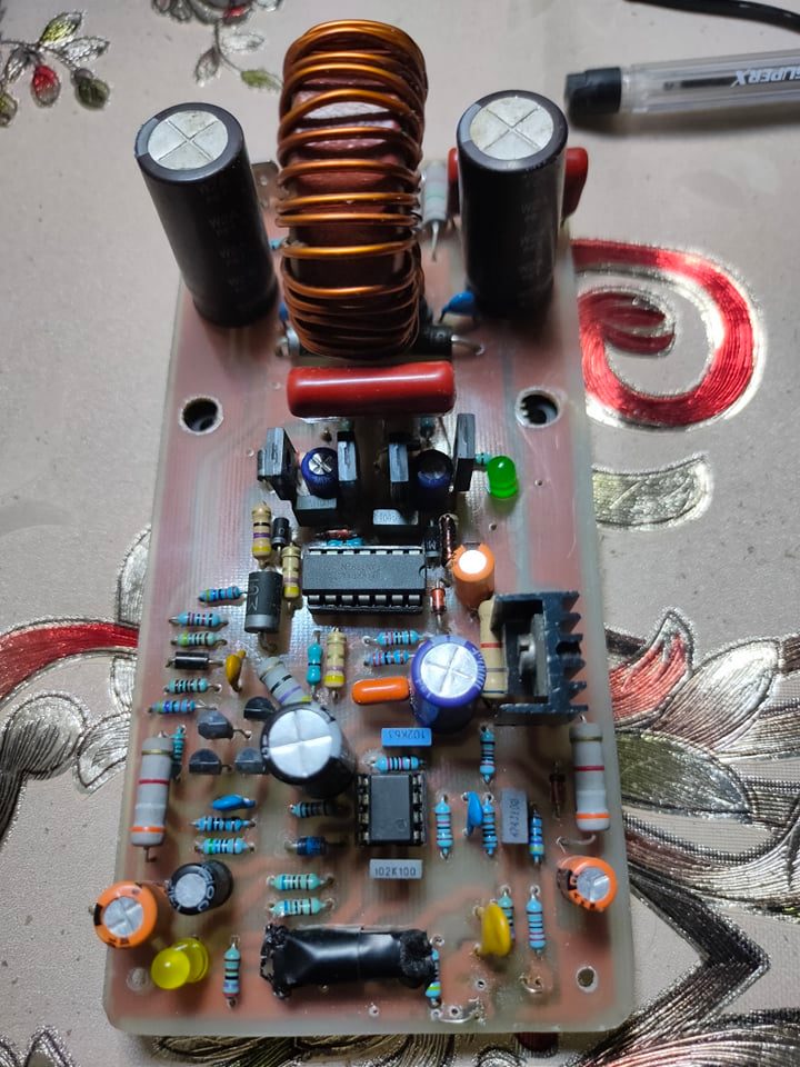

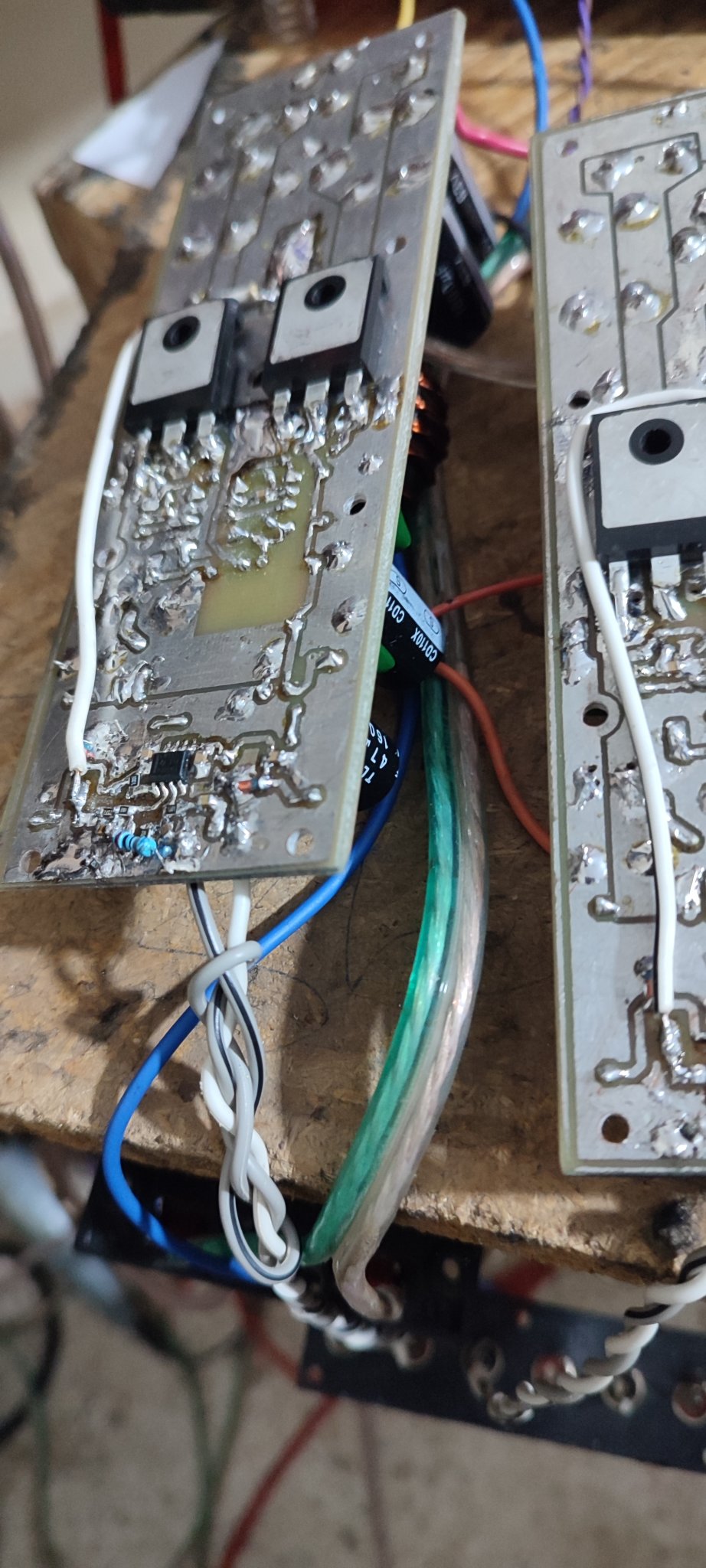

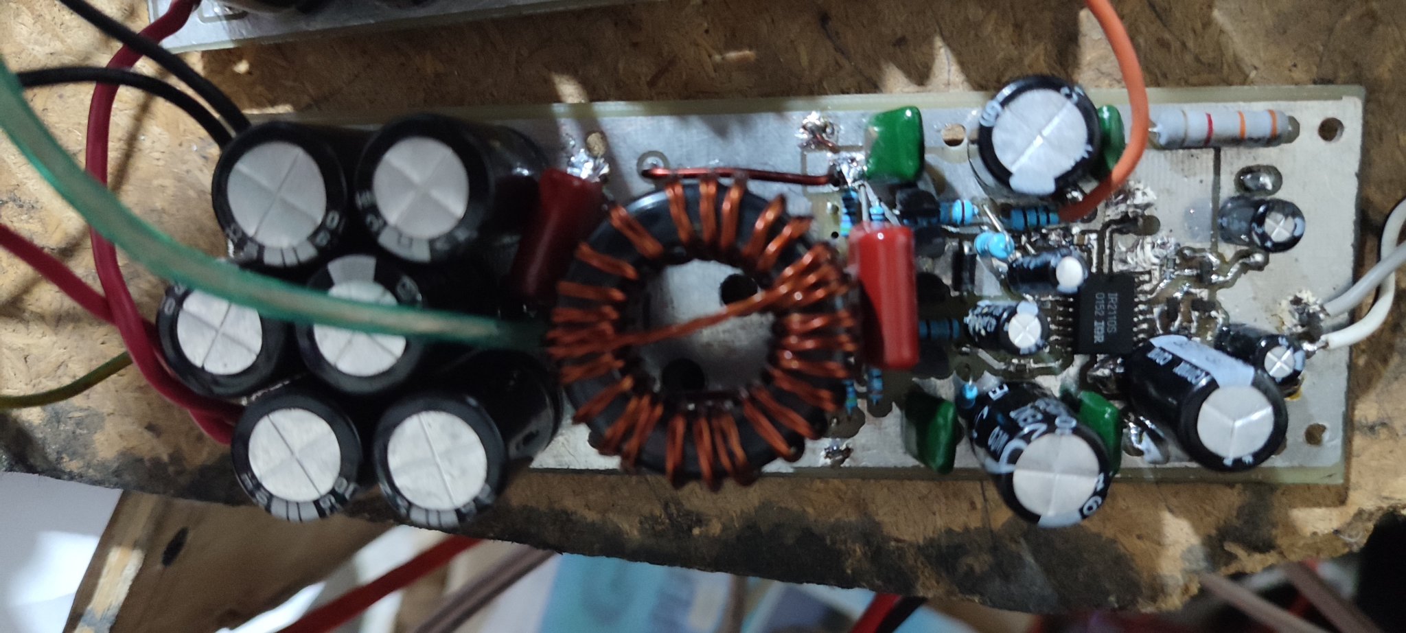

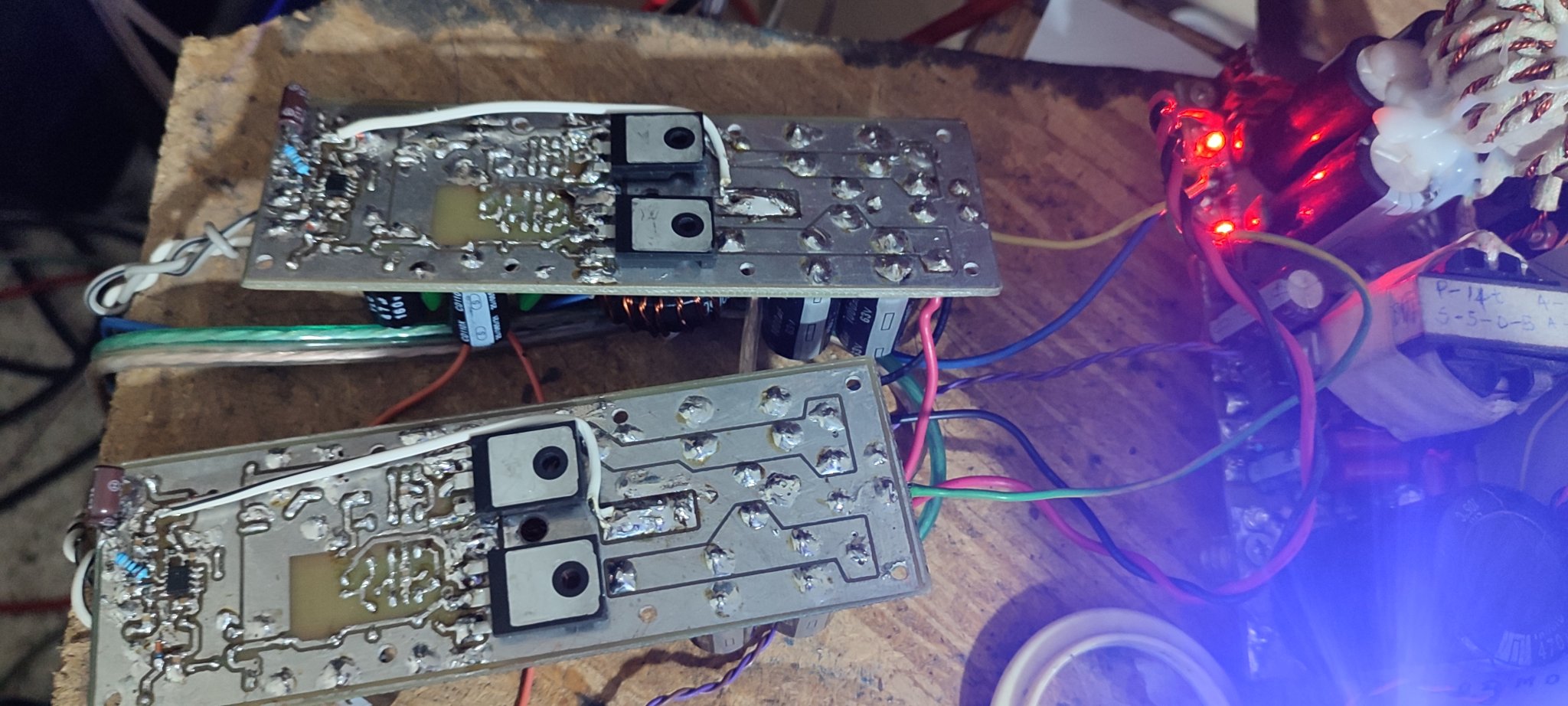

hi all , i have gone back to basis and made this amp in smd style . also i have added a buffer to assist drive the fets
The amp is working fine , the main issue is the hf hissing noise.
i prefer this amp rather than sigma delta because it is stable even with no load while woking.
kindly any opinion will be appreciated .

thanks bro for the reply, the amp is ucd ,Buffers were unnecessary. Remove it its inducing noise. And its is ucd. Its use single bit comparator i dont know if its delta sigma oscillator. But i think it is. But nice pcb
the reason i have included buffers is to assist the ir2110 ,. in the previous versions i used without buffer and the ir2110 used to heat alot
even though i had used 22ohms resistor gate drive.
also i wanted to drive multiple fets to be able to drive 1ohm to 0.8ohm load like car amplifiers . e.g taramps or many latest car amplifiers which use +/-70vlts to +/-160vlts fullbridge and supports up to 0.5ohms .
