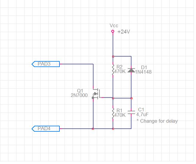

Today i built a little circuit that provides a delayed turnon to let the caps charge before the amp goes active.

can you provide schematic for delay turn on ?

I'm curious to know ... tr1 puts down pin SD IR210? If so, there was no need to use transformer IC + bjet +parts🙂
AP2, i used the enable/disable in the current source like in the philips ucd schematic: http://www.nxp.com/documents/user_manual/UM10155.pdf
pad 3 and 4 in my schematic, tho i guess using the sd pin on the IR2010 would yield similar results, i chose what i chose because i dident feel like digging up the ground plane around the SD pin.
And here are two new pics of the updated startup delay:
Amp in standby, no oscillation:
Amp active:
The white led was supposed to be yellow, picked the wrong bag.😱

well i use not only a delayed poweron but a more or less instant power off rather than having it keep oscillating as the psu drains out with a pop of squeek as the end result.

Hi Tekko,
I did not completely read the posts but try these;
i) put an electrolitic cap parallel to R6 for delayed turn on, also disconnecting R2 from gnd can be used as disable function.
ii)Or put an electrolytic cap from vdd to SD pin of IR2112 and let the SD pin go to -24v with a resistor. For both i&ii you need to make some calculation for cap and/or resistor values.
iii)To adjust the offset use offset balance fuction already supplied on LM311 (pins 5,6).
