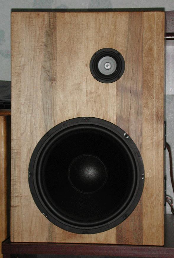

Hello all,
Can anyone help me out here.
If i'm using the same woofers on a normal baffle say 2x4 feet and not using a bass boost, how low will they go?
Free Air 28.00 HZ
QES .328
QMS 3.130
QTS .298
VAS 7.200 CF
RE 13.000 OH
XMAX 5.000 MM

correction...
I geuss a normal baffle will be about 3 feet wide.
Im geussing you will still be f-3 will be about 30-35 Hz.

Qts
Ive been modeling the woofer in software and the lowest octave doesnt look too good compared to some other higher Qts drivers.
I get -3db at 90 Hz and -10db at 30 Hz so its a shallow roll off but i think -10 will not be very audible so maby effective to 40 Hz or so.
(modeled with a sealed 100000 liter enclosure)
If i add a little mass can it be improved any?
There are other drivers ofcourse but ive found the mcm very cheap.
Any input?
Thanks, CO
