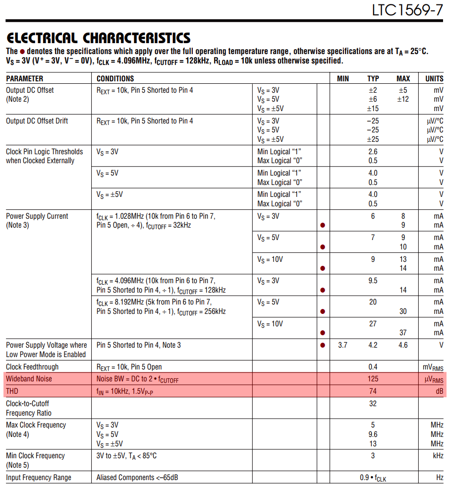

Both filter ICs are not really needed.
I remember the hype when they came out, but there were not many applications, certainly not in the audio world, in fact never saw them used anywhere.
Oversampling, delta-sigma and filtering on the digital side do not require 10th order analogue filters on the output.

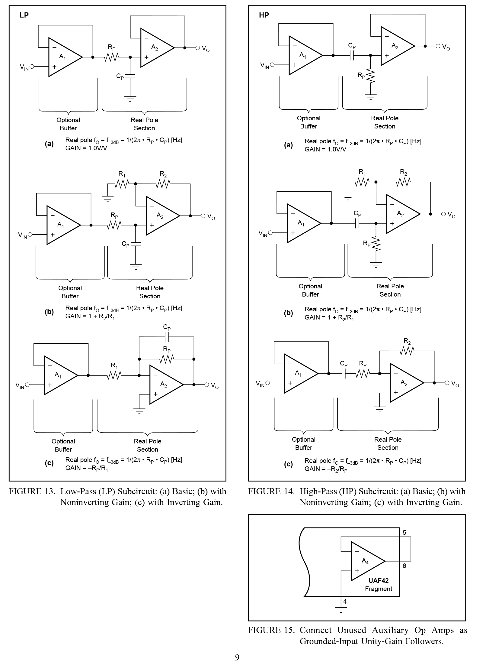

A 2nd order filter LP/HP is done with 2Rs, 2Cs and an opamp, no need for clock circuits interfering with digital converters in the signal chain, a dual pot makes them adjustable in case.

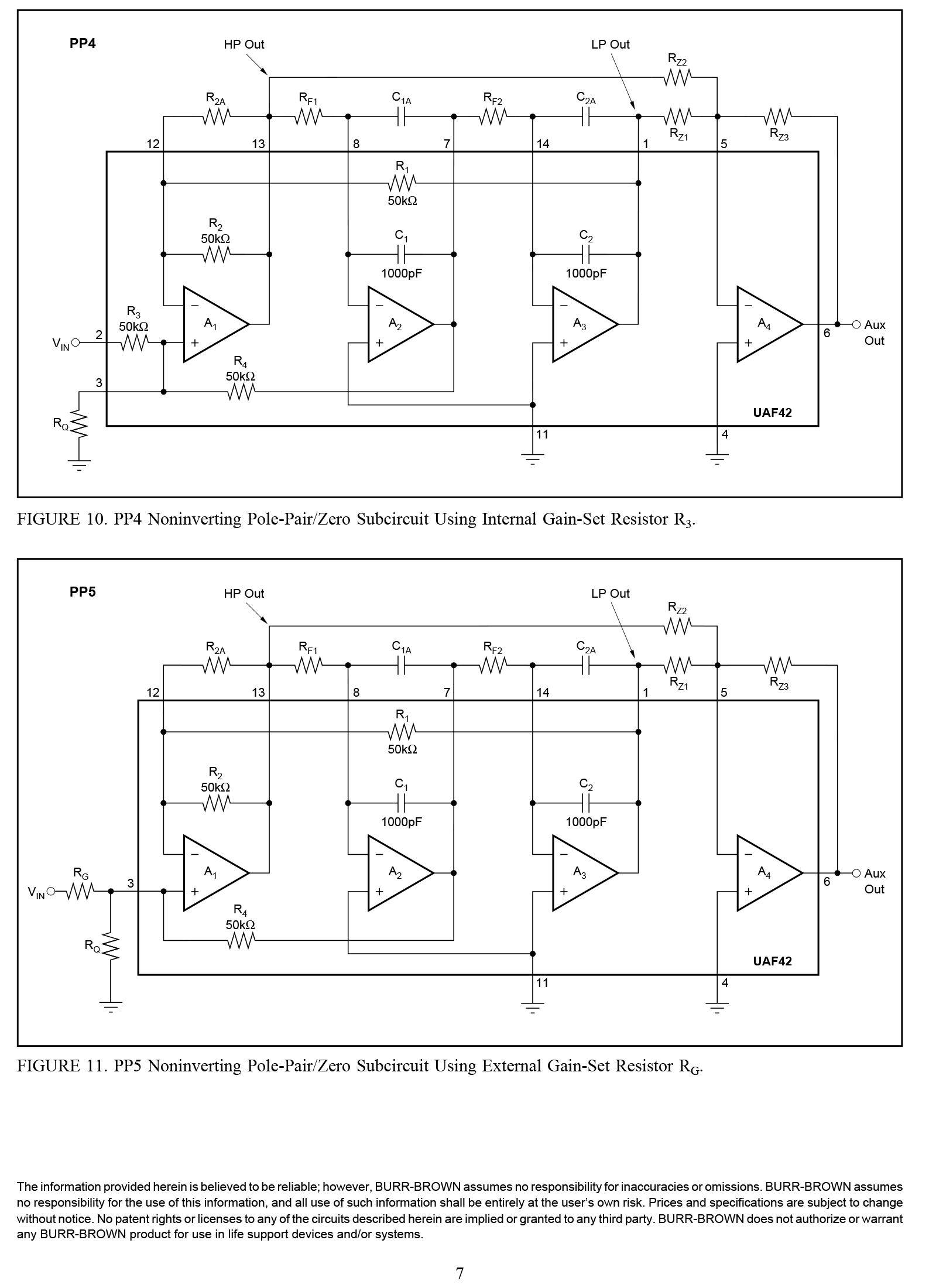

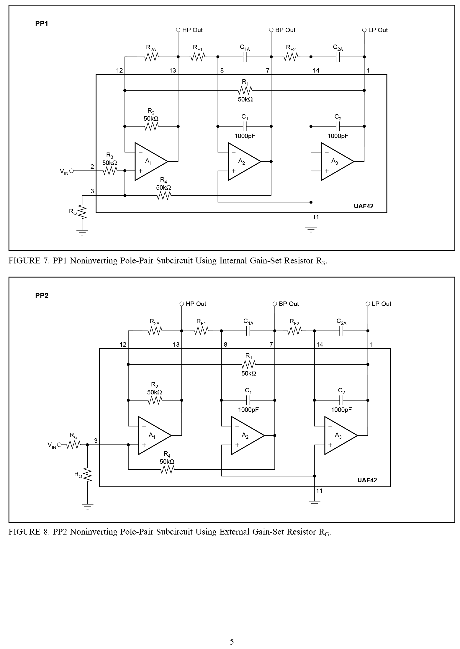

I know this is old, but I want to use a lpf @1kHz with a commercial dac output to use as a signal for some testing in audio circuits. The .1% distortion in this setting shouldn’t matter should it?
Sorry if this is a stupid question.
I suppose the signal could have higher distortion after the filter than the bare dac signal.
1k series resistor and 0.15uFd cap to ground is about 1kHz first-order filter. Is that not enough?

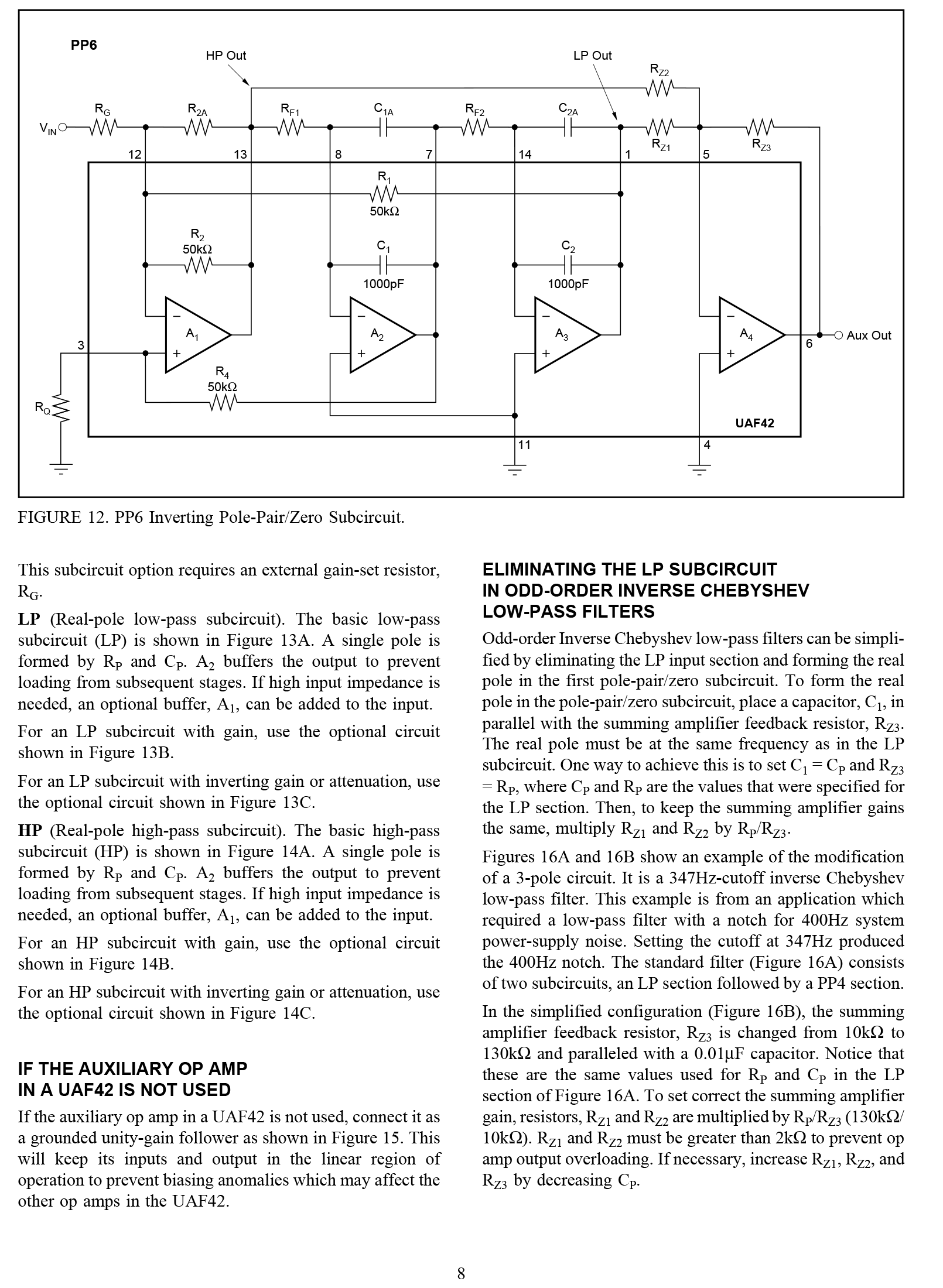

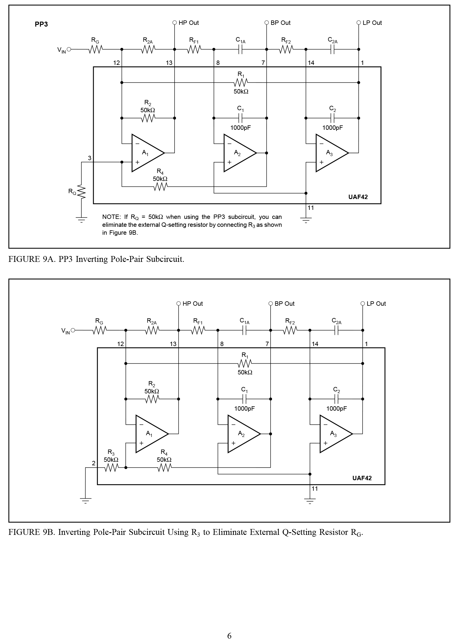

The UAF42 vanished because it was just a few 19-cent opamps and resistors, which you could as well build yourself, even using the charts in the UAF42 sales-sheet.

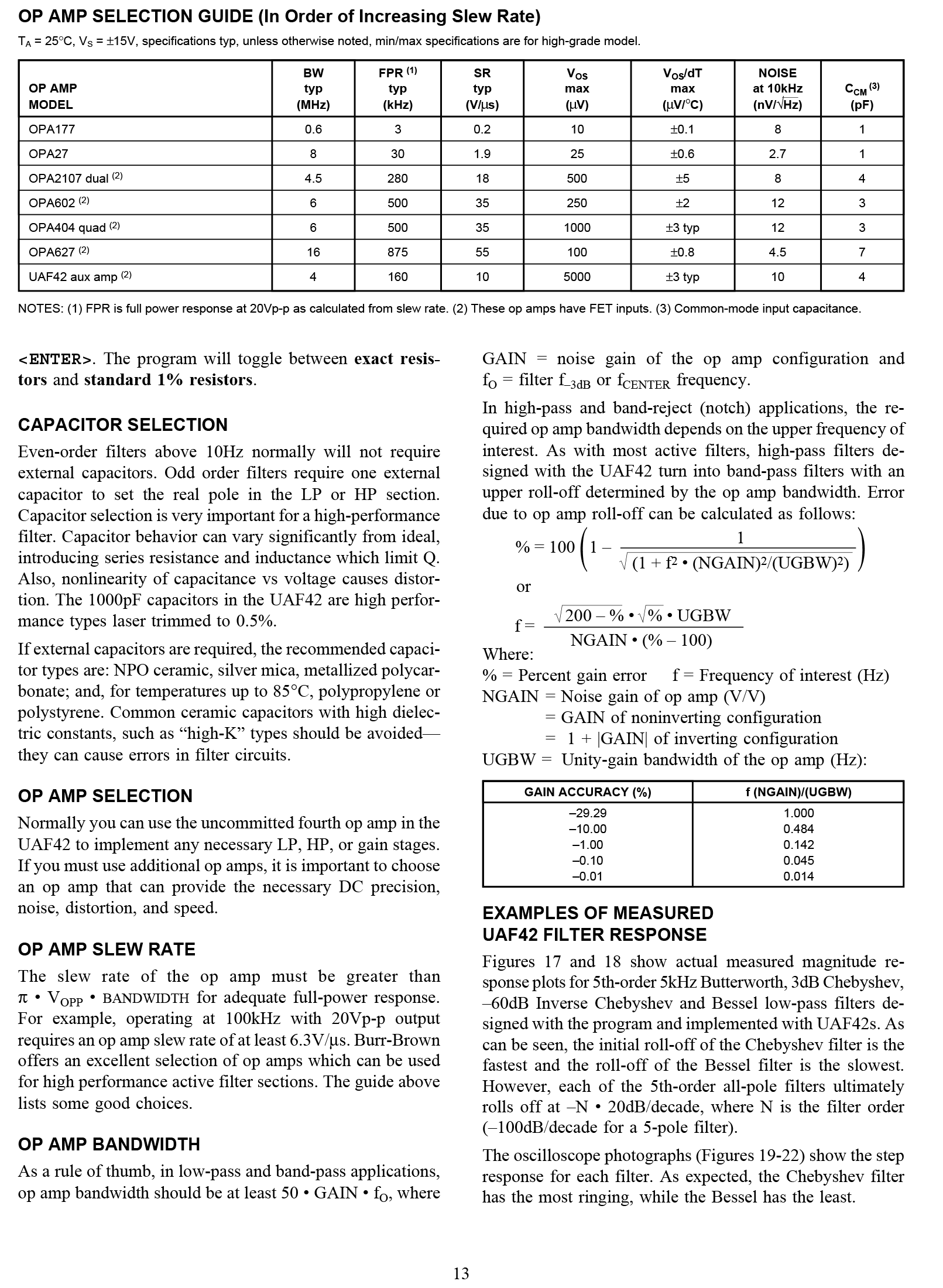

I thought I might get away with less noise because I saw what must have been an outdated Burr Brown data sheet that said .004% thd+n. I looked at the later TI one and it says.1%. Waste of time as you suggest.

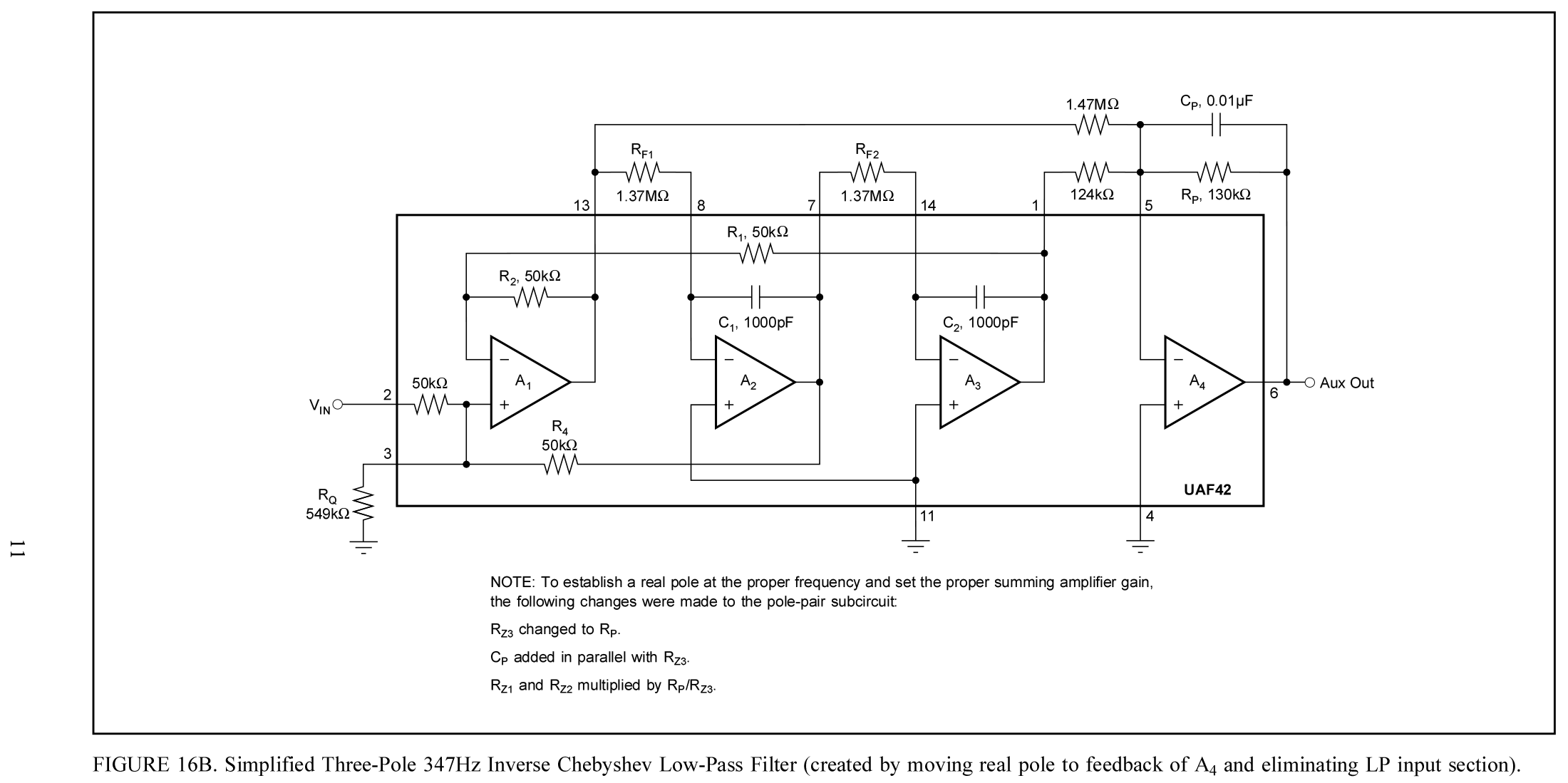

I need a low noise lpf to use with a good dac to generate a 1kHz signal to calibrate an adc.
