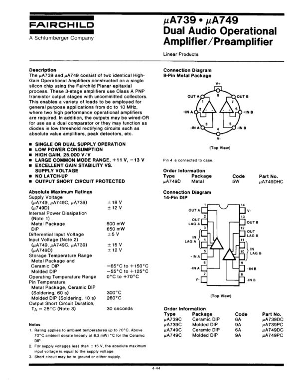

ua739 internal diagram
Does anyone have the internal diagram for the ua 739? I have two 300a amps. I also have two D60 amps
UA739
Take a look at
http://www.alldatasheet.com/datasheet-pdf/pdf/113482/FAIRCHILD/UA739.html
Maybe I can get the UA´s here in Mexico, let me know if needed.
Regards
Take a look at
Regards

UA739/749
The replacement part in metal can from NTE, 949 www.nteinc.com
See the att.
Best regards, R Amandi
See the att.
