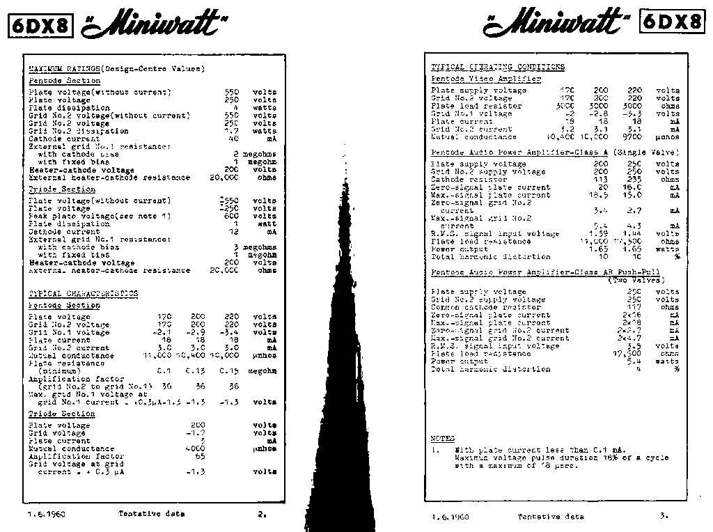

Fidelity, in the UK, produced a record player with a UY85 rectifier and UCL84 pre-amp/output stage circa 1960. Equivalent to ECL84 with 100mA heaters.
That makes me curious. Are you sure about that, as the ECL84/PCL84 weren't exactly designed as AF power output tubes?
Best regards!
...That makes me curious. Are you sure about that, as the ECL84/PCL84 weren't exactly designed as AF power output tubes?
Best regards!
ECL84 is the same tube as ECL84!
Best regards!
The pentode section of the ECL84 looks to have nice curves, every bit as clean as most of the popular sweep tubes, even if dissipation is limited. I can't find curves for the triode section, other than the single trace on some of the sheets for 200 volts plate.
As in all things audio, original intent is not nearly as important as the actual measurements and performance, there are plenty of tubes that were not meant for audio that have fantastic curves and linearity. Take the 6SN7 for instance, it was a multi-purpose type that even saw use in vertical deflection or computer circuitry, but just so happened to be common enough and suitable for audio 🙂
