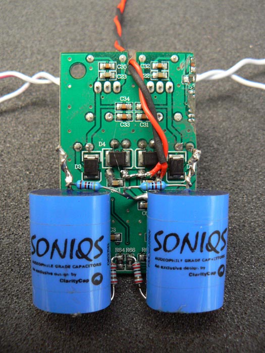

(form Puffin). After messing with my amp I seem to have a short somewhere. The stock SMPS has a fault facility and the LED flashes and seems to only supply about 2-3 volts. The supply is not stable and is constantly rising and falling. I have not done anything apart from hard-wiring the inductors to the diodes, where the original tracks disintegrated. Any ideas anyone ?
I'll post a pic if it helps, but the thing looks anything but pretty now!
The inductors are from Farnell, http://uk.farnell.com/jsp/Passive+C...splayProduct.jsp?sku=200694&_requestid=92239. They have 18 turns of 22swg or 24swg wire.

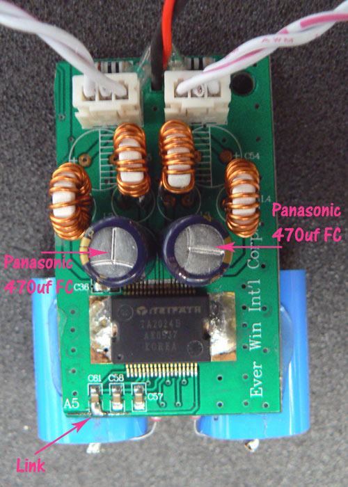

Hi Audio1st, I dont know if it makes a difference but the ferites I used last time were these:
Fair-rite
Dont know the ferroxcube ones at all but I remember seeing them on an old thread about tripath inductors.... are they as good as the Fair-rites?
Hi Lee, that's why I couldn't find them at Farnells, it was RS that I must have got the last lot from
I am just running it in at the moment with old speakers, so I have no idea if it is better yet.
The old ferrites needed 12 turns and the new ones need 18, I have no idea if it is better to have more or less turns for the desired 10uH. It's all trial and error for me 😕
Ahhhh😀
Well I'm no expert but that could mean they will saturate easier at higher currents... having a lower permeability... . hope not mate
Anyway, that link I posted seems to go astray so if you look for fair-rite, 5961000201 on RS then those are the ones.
If you can fit them in then go for the 5961000301 it's perfect for a sonic but may be a little big for this board..
In fact, on my Charlize I changed them to larger cores (5961004901 same material) to ensure there is no saturation at higher listening levels. probably overkill
