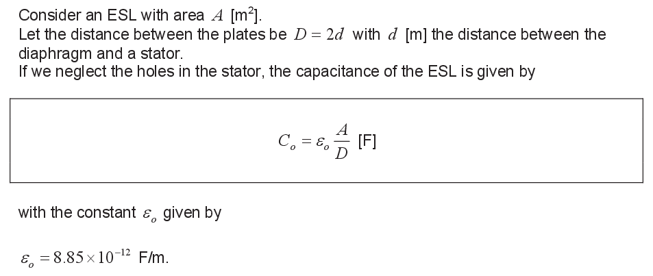

silly question. Does anyone actually know what the impedance of an ESL without the step up transformer is? Obviously capacitive but by how much, and does it change with drive level as the film moves?
It's about a nF for a square meter at the usual spacing. My design goal is 1.5nF at 1500Vrms..
Edit: the way I interpret this is that you have two caps, since the stator between the moving diaphragms is grounded for AC. So this equation gives the total capacitance of two caps, one on each side of the stator. This is the cap reflected trough the usual xformer to the driving amp.
With direct drive, each cap is driven out of phase from a separate output stage so each output stage sees half the cap value from the equation. Have I got that right?

With the dual-stator ESLs you have the correct notion regarding the capacitance seen by each amplifier.
