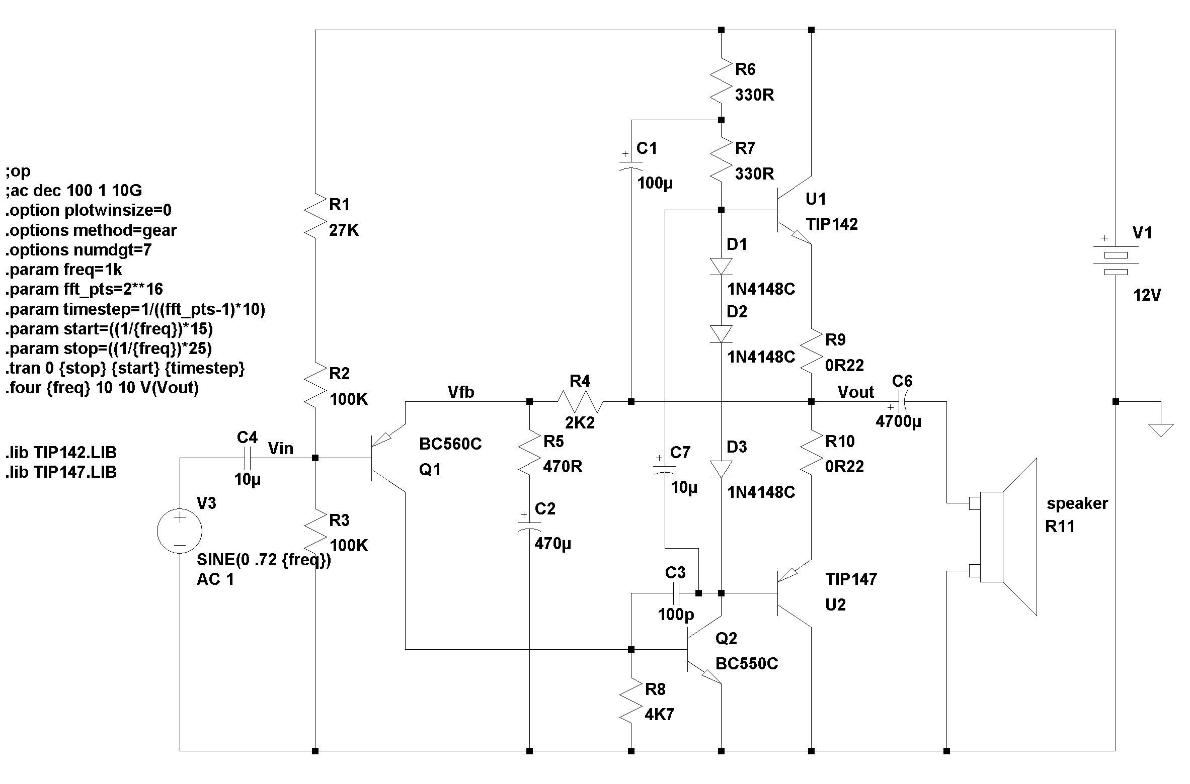

Do you know when we refer to the various terminals, such as base, collector and emitter, exactly what these are for? I'm not sure I'm clear on wether you are having difficulty identifying these leads on a given device, say by looking at the data sheet, or if you don't know what the terminals do on the devices.
I'm more than happy to provide a little guidance, and I'm sure some others would as well, but we need to get a better idea of what your current level of knowledge is. Many folks here expect a certain minimum level of understanding to already be present in someone when they respond and can get put off when that minimum doesn't seem to be met.
I know you have been provided several links to decent websites that cover some basics, have you read and understood at least some of that? Give us some sense of what level we need to operate at.
i do know how to make a simple single transistor 2 capacitor with 2 resistors amplifier with low wattage from a 5.0 volt power supply that is no problem for me but anything more get's confusing as to not knowing which wire goes to which lead

For learning without burning anything, I highly recommend also downloading and using the free LT-Spice software. Within minutes, you can draw a schematic of a simple transistor circuit or amplifier. After that, it's like pure magic. You can run the circuit, in the simulator! Your mouse pointer turns into an oscilloscope probe, and much more. It's like having a whole lab full of equipment and a warehouse of components that are never out of stock, except that you can't accidentally blow up anything or start any fires, or electrocute anyone. (You can still check whether or not anything WOULD have burned: Holding down ALT makes the mouse pointer into a "power dissipation" probe, which works on every kind of component.)
Here's an example of a relatively simple amplifier schematic that in practise should work though I haven't built this particular circuit (see attachment). There are simpler but this shows the typical 'three stage' design.
This is the connection diagram. It shows the power source as a 12V battery and everything it connects to. It shows every connection you need to make to physically build it. There are four transistors and this is in fact a 'Class B' push-pull type of amplifier you have been asking about. I know you have mentioned being of limited means but to step in this direction you will either have to do some scavenging of old electronics or find a way to buy a few components if you seek to make anything like this. For a conventional type of design that will drive an actual speaker this is about as easy as they come.
This was created using LTSpice from Linear Technology available here. The software is absolutely safe and free, many people here, including myself, use it to verify an idea before building a circuit. As Gootee mentioned you can play all day and just see what happens.
Look at it and tell us what you see or recognize in the diagram.
