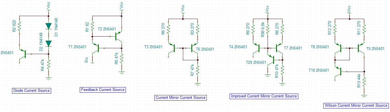

Types of current sources for audio amplifier applications

Hi Jan,
I have just read those articles, and, more importantly, the correspondance that followed.
I am afraid I disagree with Jung's conclusion in respect of, in particular, the amplified negative feedback current source, which he calls, rather inadequately, the "one Vbe" current source.
I know for a fact that the amplified negative feedback current source possesses a significantly higher output impedance than, for example, what Jung calls the "two diode" current source. This is also the view held by no less a luminary than the late Hans Camenzind on pg 77 of his book here:
http://www.designinganalogchips.com/_count/countdown.pl?designinganalogchips.pdf
Its noteworthy that Walt Jung was taken to task in this regard by Thomas Bohley in the correspondance section of AudioExpress of September 2007. Folk are incouraged to read his rebuttal.

Further in his response to Whitney (Audioxpress 09/07), Jung unwittingly demonstrates the incorrectness of relaying on the supply rejection of the current source to deduce its output impedance.
He realises that by splitting the reference resistor into two and connecting a capacitor from the mid point of the resistors to the supply rail, as recommended by Douglas Self, the supply rejection increases drastically.
This fact should have indicated to Jung that the inclusion of this capacitor in no way increases the output impedance of the current source even though supply rejection is increased, and, therefore, that using supply rail rejection to estimate output impedance for a current source gives completely erroneous results.
Additionally, Jung suggests that the amplified negative feedback current source, which he calls the "one Vbe current source", requires a small resistor in series with the base of the control transistor for stability.
This is completely untrue at least in audio amplifier applications as can be deduced by simulating the ANF current source's loop gain in SPICE. This should demonstrate that said ANF current source possesses completely innocuous LHP singularities giving a phase margin in excess of 90 degrees.
