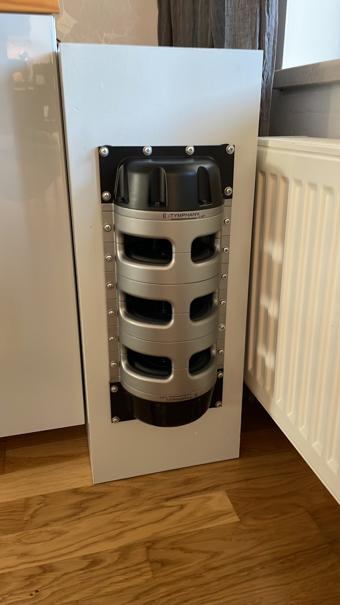

Hello.
Just purchased this “thing” almost mint condition for 43U$D
Don’t know if it was overpriced or a super deal.
So what shall I do with this? Been googling around but actually do not think I can find anything really useful. Anyone have som suggestions. There is some pictures around the net with this “thing” fitted in different enclosures. I have never before built any sub. Only normal loudspeakers. So this is totally unknown knowledge. I think it looks pretty cool. Well if you have any ideas, suggestions or experience. Please share your thoughts.
Thanks / Sander.

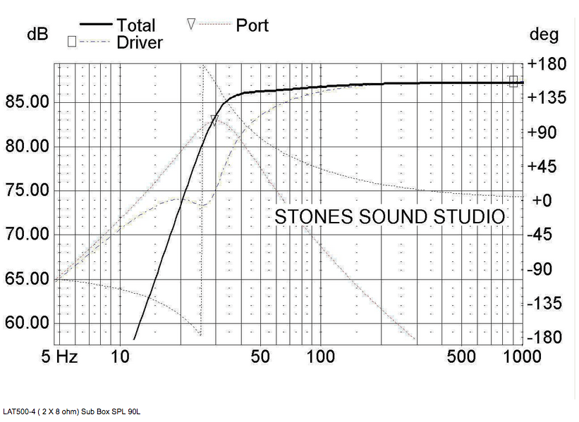

This site has the (simulated?) response in various ported cabinet sizes:
http://www.stonessoundstudio.com.au/stone/tymphany_lat_250_500_700_subwoofer_applications.htm
Below the Fb (box tuning) of 30Hz, the excursion could easily reach Xmech with far less than it's rated power, a HP (low cut) filter would be more important using this driver than the usual modern "sub" which has far more Xmech.

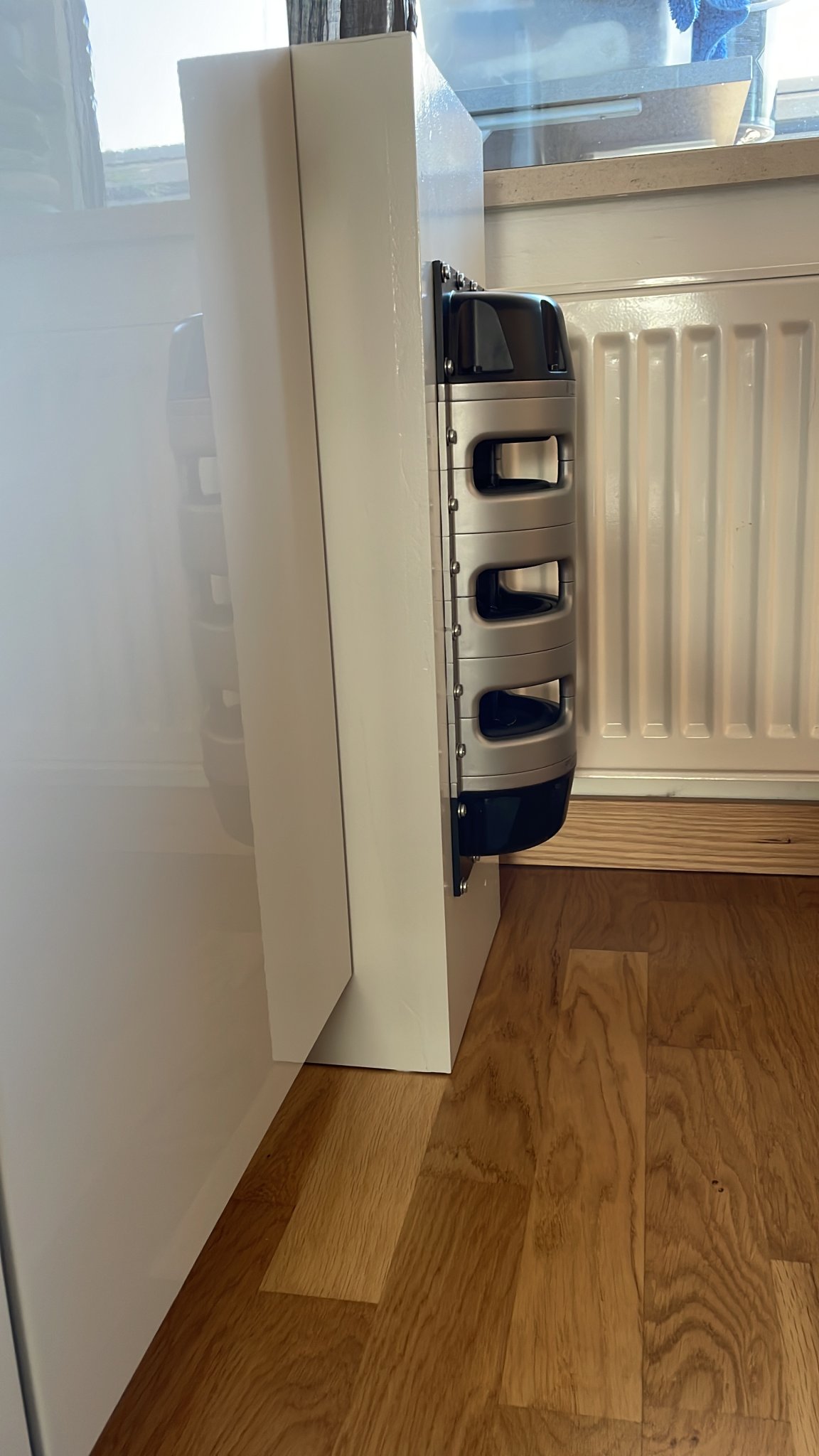

Well sound. Not flappy or so. I had I big party and playing “ around the world” daft punk. Then I realized, very snappy. We played loud the whole evening. Hehe. My neighbor loved me. Anyhow my friend was there and he has built a ton of loudspeakers. He gave approval as well. Surprised by the small box vs output.
I have a separate amplifier just for the box.

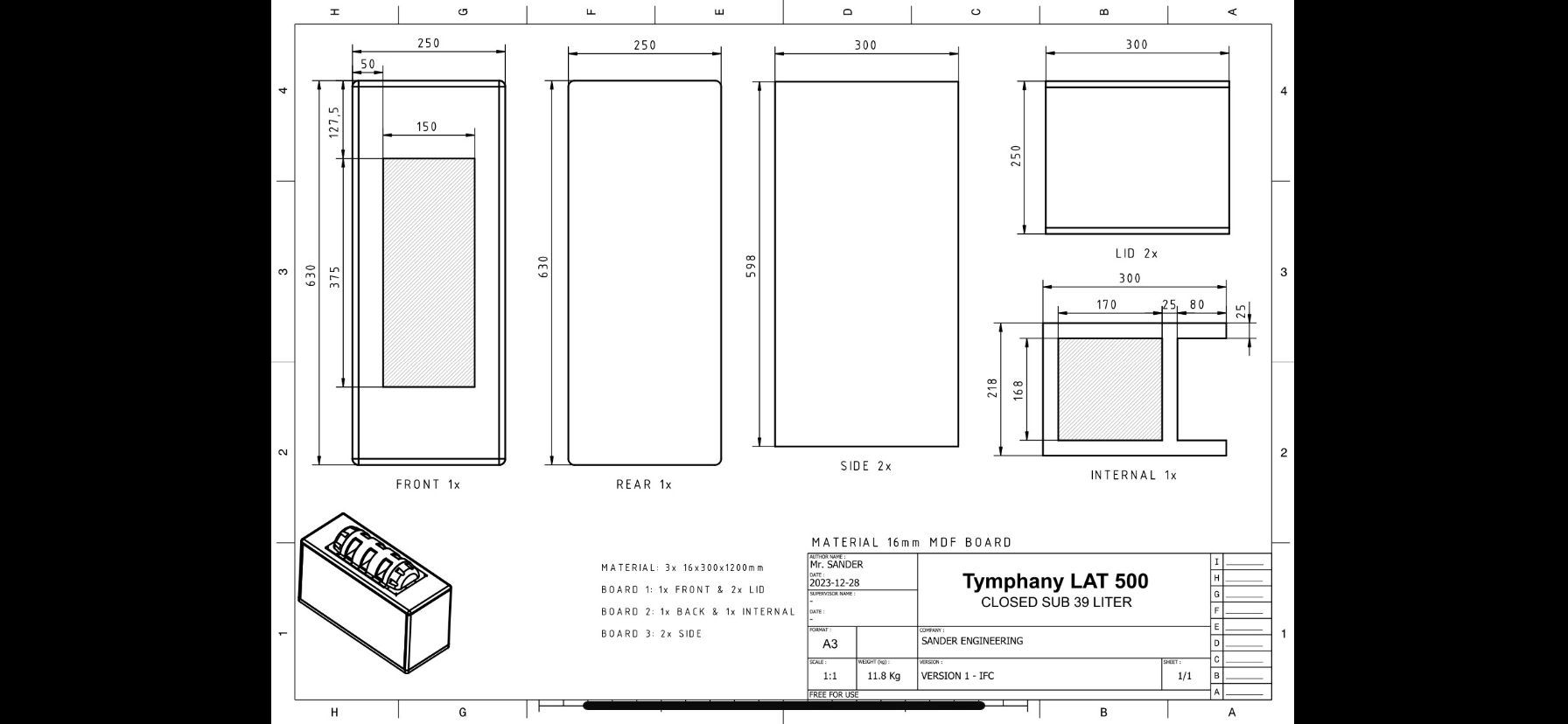

I’m not an expert, so I used thile and small parameters software. Compared o couple of settings.
Made a 3D drawing in freecad.
Files is available to anyone. If interested. Sharing is caring.
