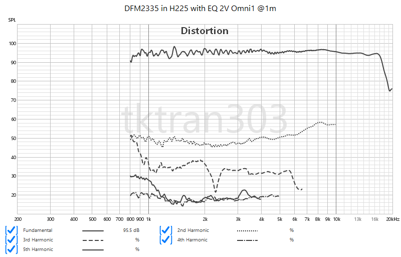

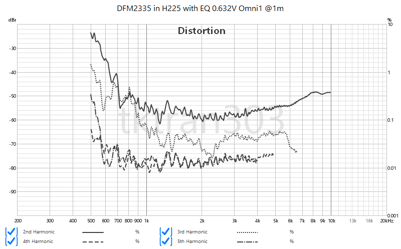

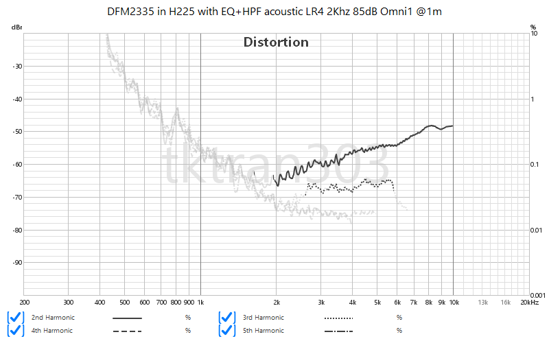

Tymphany DFM-2535-R00-08 in SB Audience H225 90x60 degree constant directivity horn

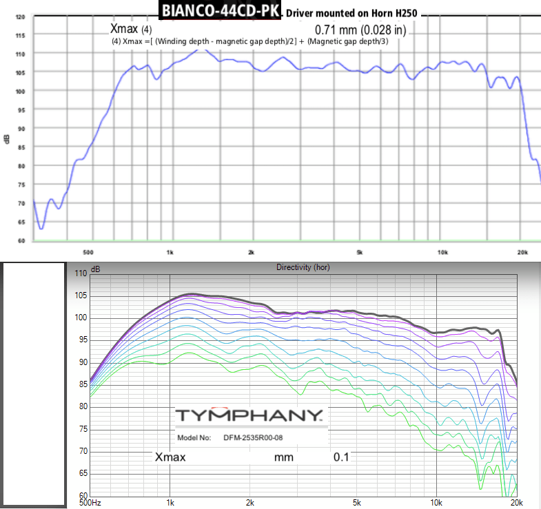

Thanks. And can I ask again what may a passive XO look like.? As regards flattening the response.

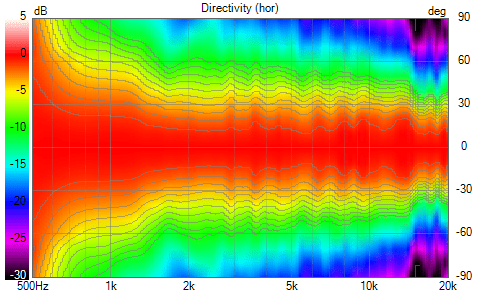

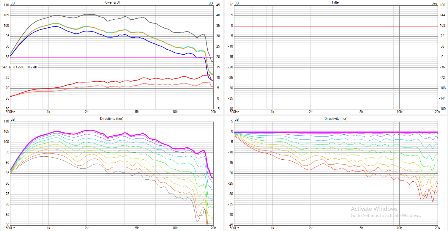

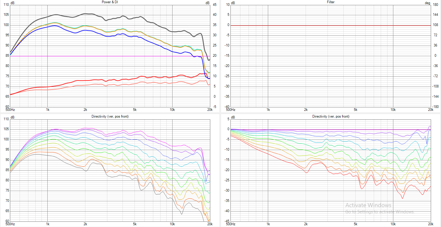

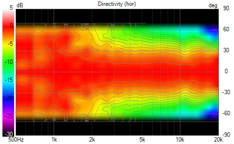

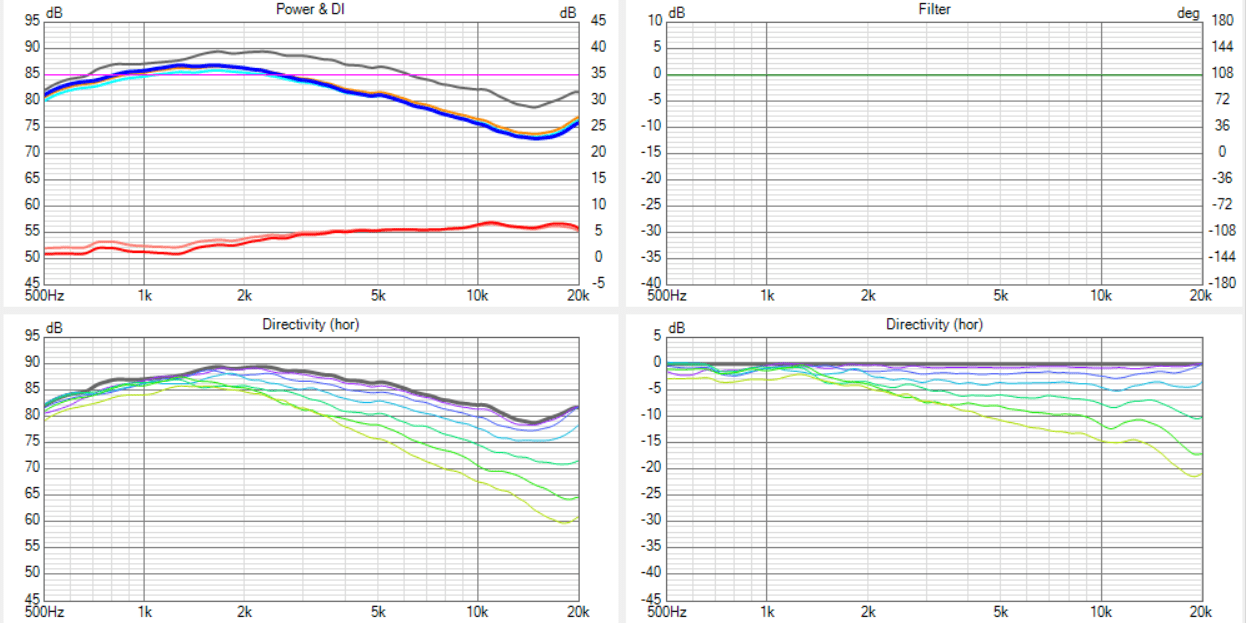

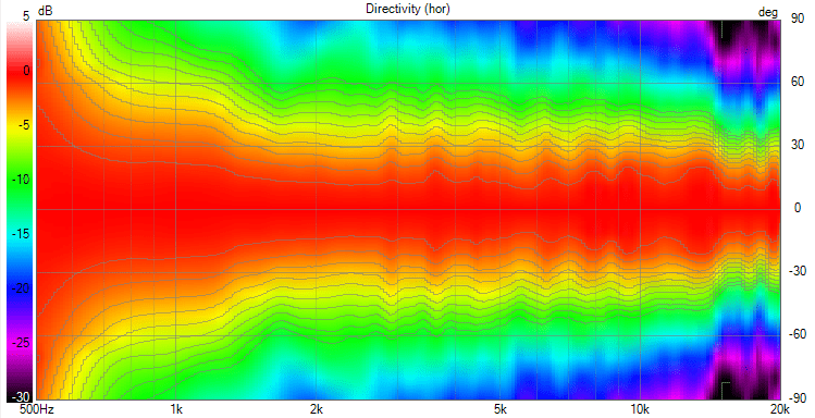

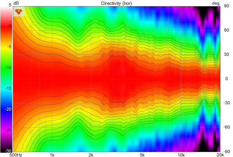

The polars as shown by miero above have a nice natural fall with frequency along with increasing DI. Sometimes that sounds OK as is. On the other hand the direct answer to your question probably involves a series resistor with a capacitor across it.
But that has not yet been measured with the DFM 2335.

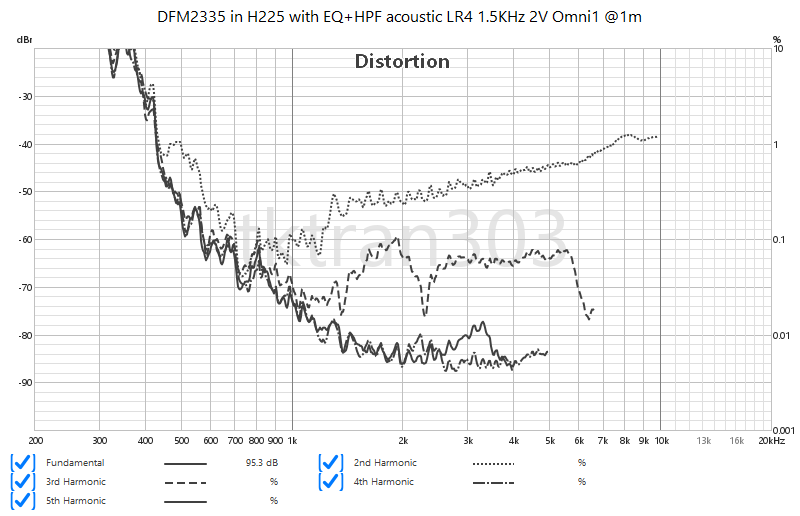

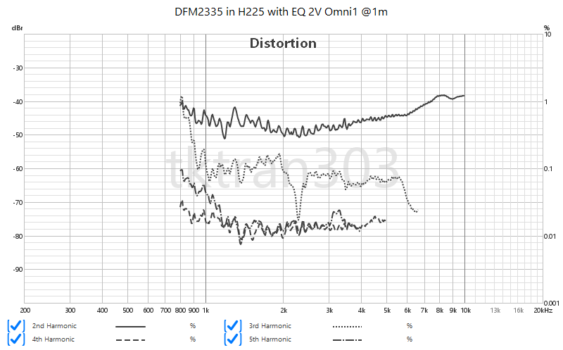

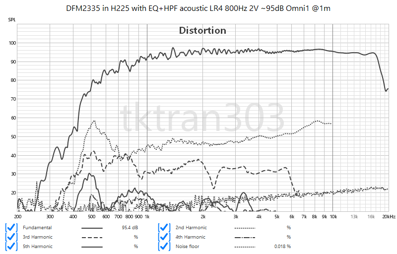

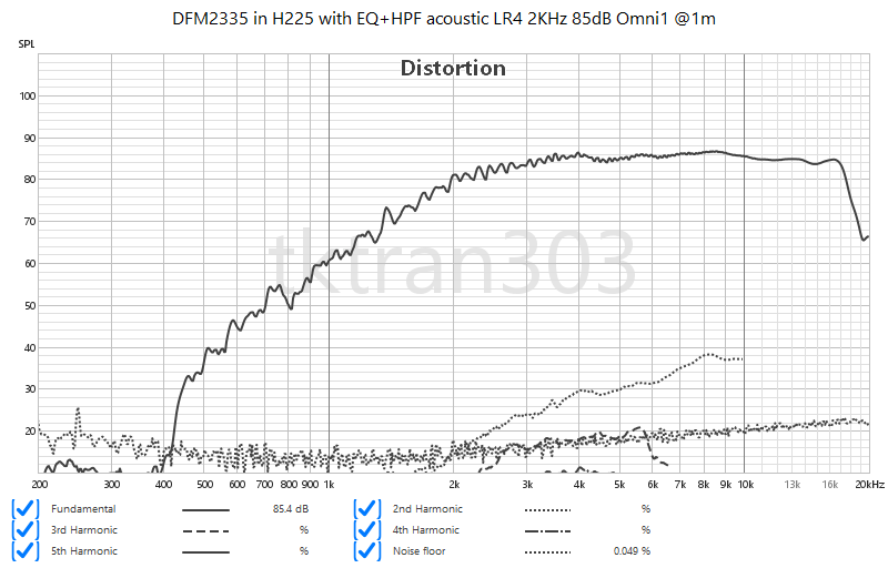

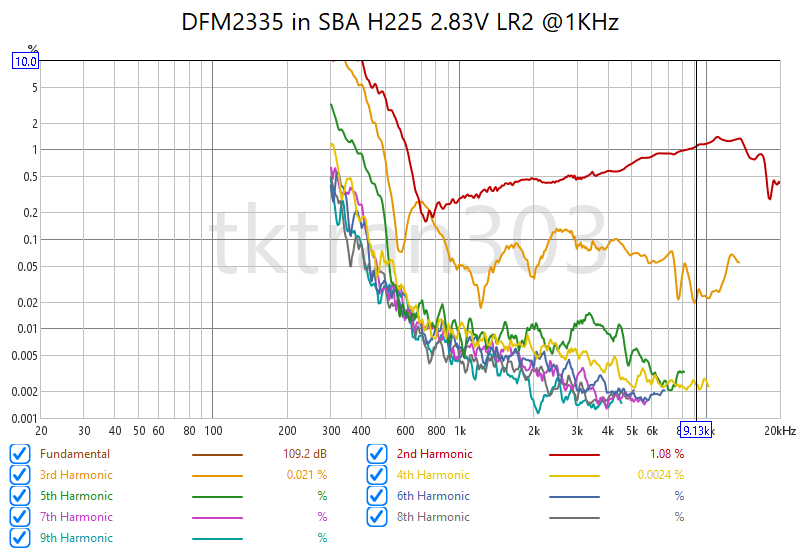

I got confused by incorrect model number in the thread subject. There are measurements of A460D with DFM 2353.
- https://www.diyaudio.com/community/...-design-the-easy-way-ath4.338806/post-7826267
1729868168631-png.1372347
Reactions: Zvu and mabat
Very much home/hifi and not PA. Modest size UK room. 3m listening distance or so

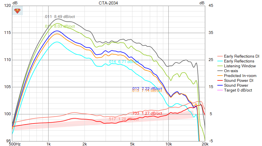

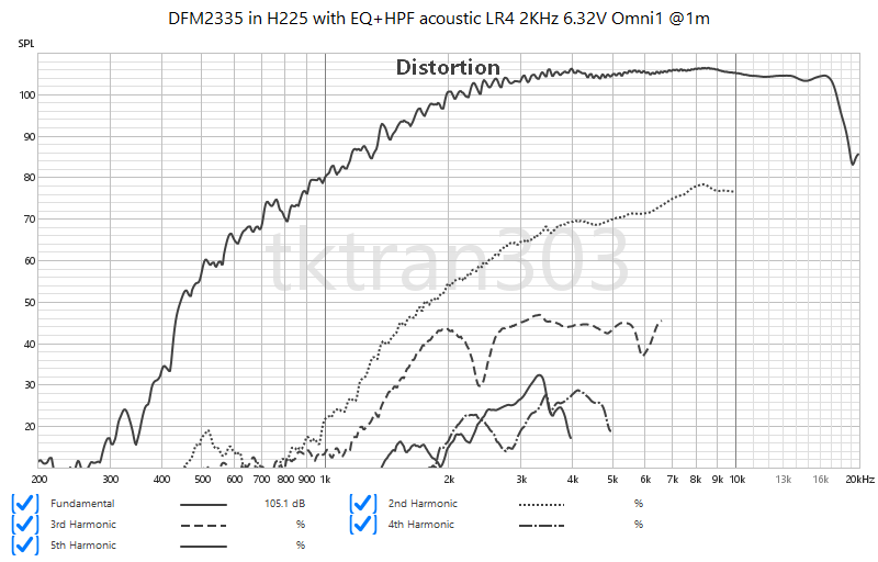

If you are referring to SPL, I agree that 111dB/1m is a bit limited for PA. For a small solo singer/guitarist in a cafe it’s perhaps ok.
For home hifi, single unit just meets THX/Atmos spec for 85dB at -20dBFS @2m
For larger spaces and listening at 8+ metres, an extra 10dB would be welcome.
I can start to see why PA line arrays have supplanted point sources for large venues Eg. Stadiums

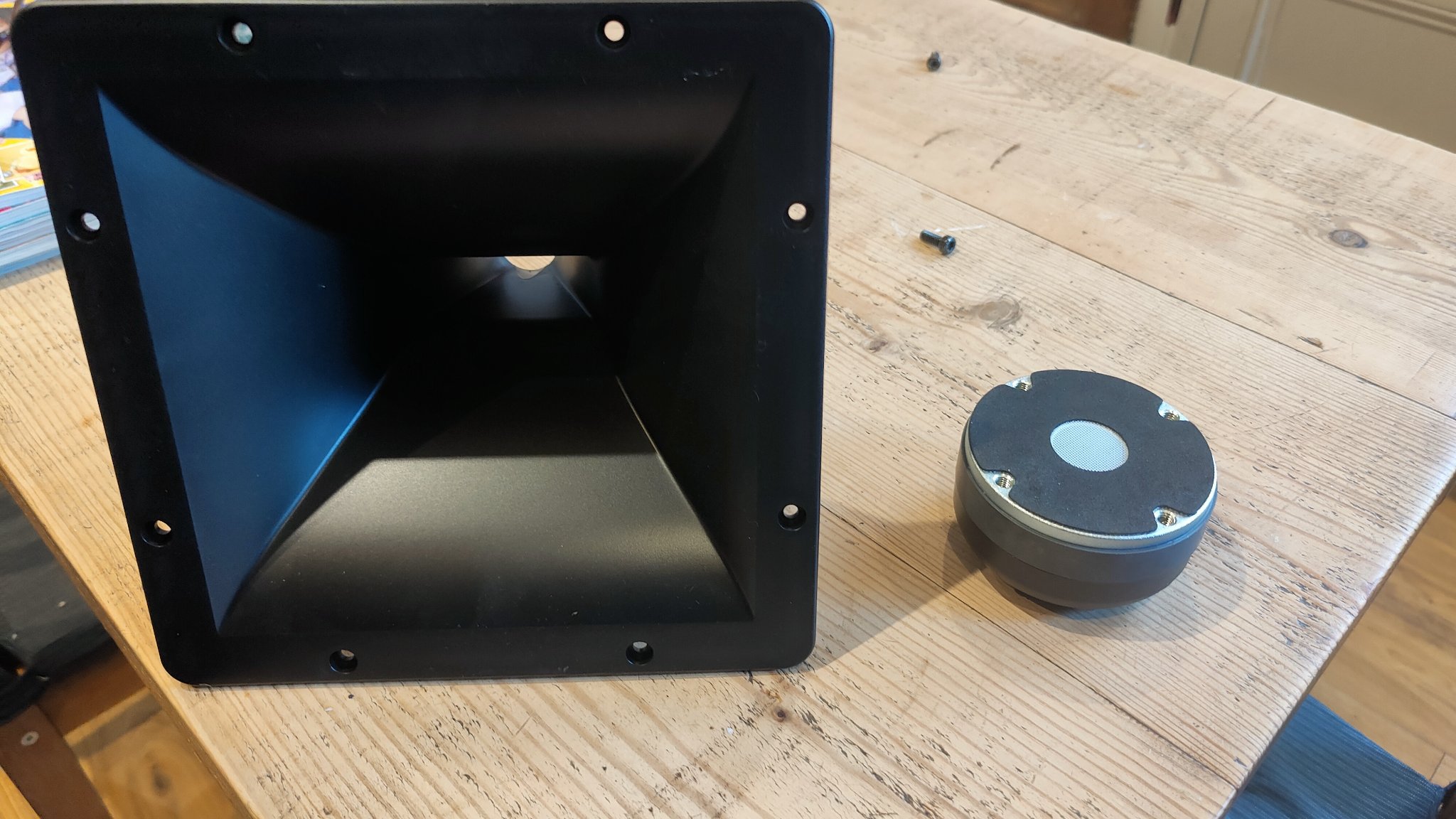

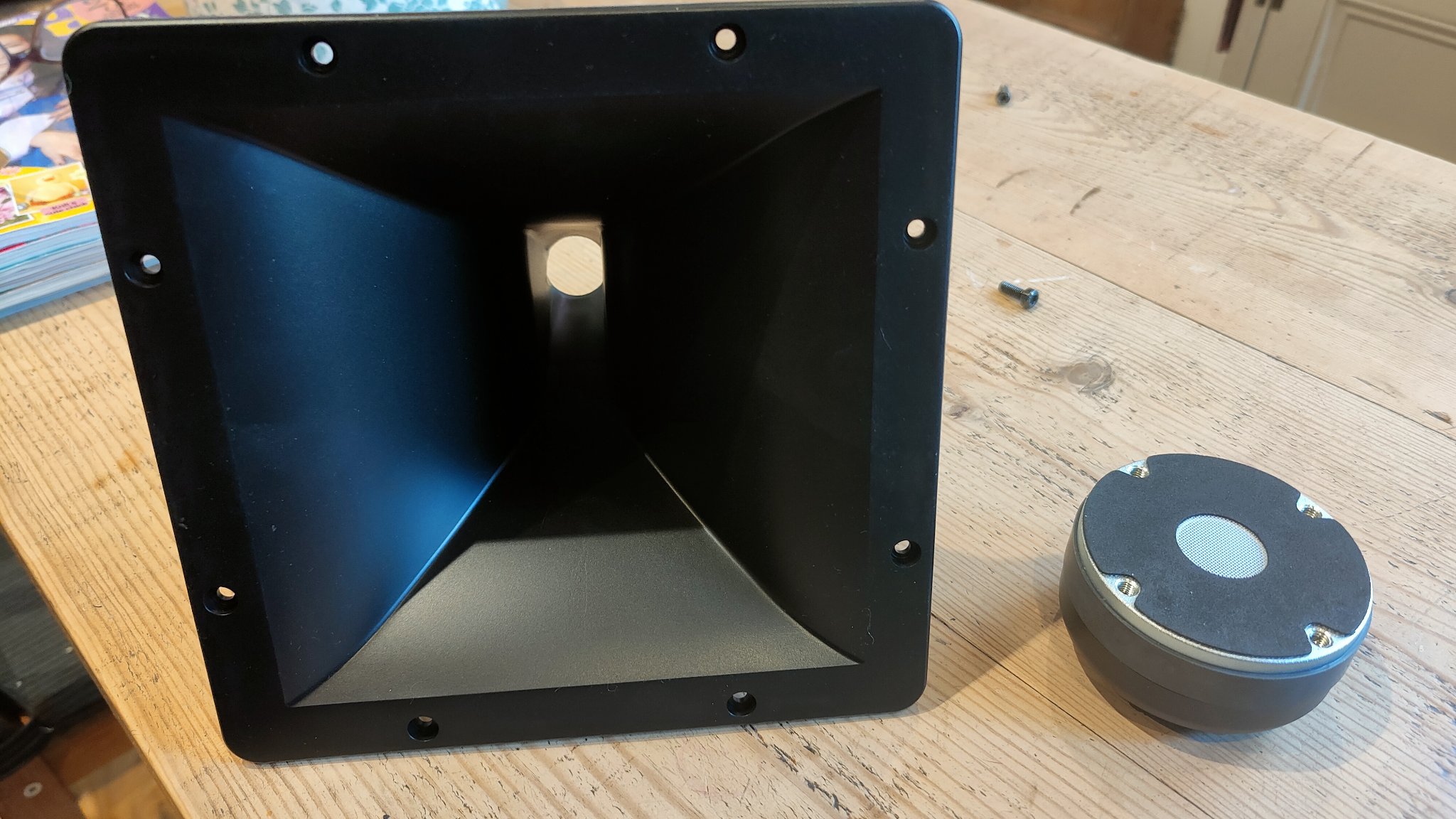

I opened up the holes in the H225 a little to ease fitment. The PCD is 0.5mm different between horn and DFM and there isn't much clearance in the holes.

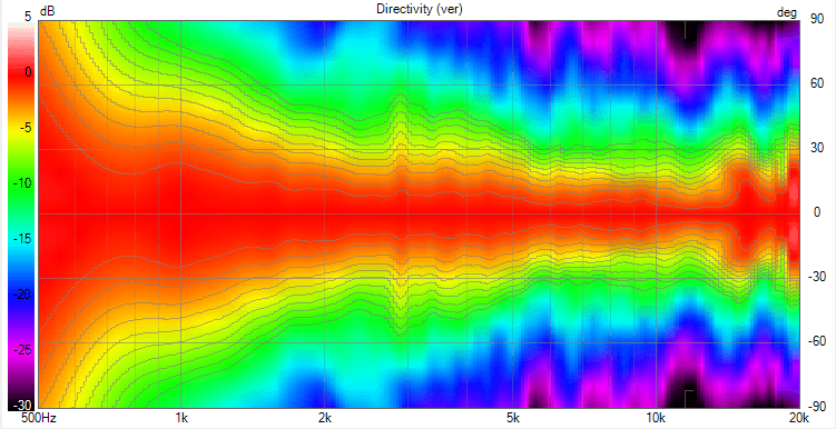

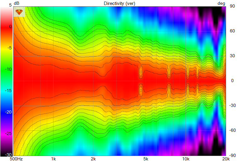

Can I ask what is the orientation of the horn assuming we want more horizontal than vertical dispersion.IMG20250306091237.jpg
Hope it's easy to see from the images.
F6- terminus/mouth/baffle size:
F6- = 10^6/(baffle*wall angle) inches
F6- = (2.54*10^6)/(baffle*wall angle) cm
The higher the aspect ratio (taller) the wider its horizontal polar response and vice versa.
