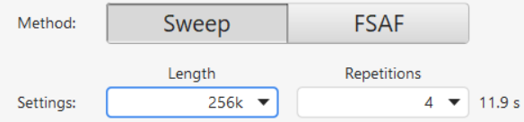

REW's method of the exponential since sweep got an update recently (5.40 beta). Depending on your room, if you take a long sweep eg. 1M samples, or 256K samples x4 repetitions, you reduce the noise floor, thus better revealing the harmonics. Right now your environmental noise seems a bit high, but it's not clear if the SPL is calibrated or approximated.

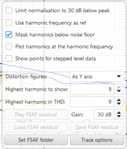

The harmonics in REW fade to white - I am not sure what that means, if REW is indicating they are of low confidence. I see traces below the noise floor, and wonder how REW knows they're there if they are below the noise floor. Probably they have a help page that explains if I find the right place to look. I have just taken it at face value up to now.

How REW knows is beyond my undergrad math knowledge...The harmonics in REW fade to white - I am not sure what that means, if REW is indicating they are of low confidence. I see traces below the noise floor, and wonder how REW knows they're there if they are below the noise floor.
You have to turn off "Mask harmonics below noise floor" - which is in the Controls function...
When there's plenty of background noise (measuring in the garden, carpark, outdoors.. try 4 or 8 repetitions of sweeps at a shorter length eg.)
