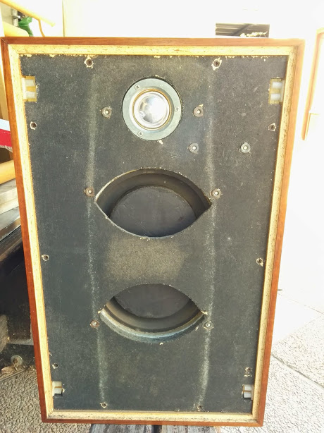

Well one for all is the famous Snell that was dissected by Troels Gravesen, the other can be some vintage Bang & Olufsen units, I believe..Can anyone give examples of OP's options 1 & 2? Option 1 is to use filler mid, and option 2 is to use wideband mid. I wonder what successful designs actually used these approaches.
