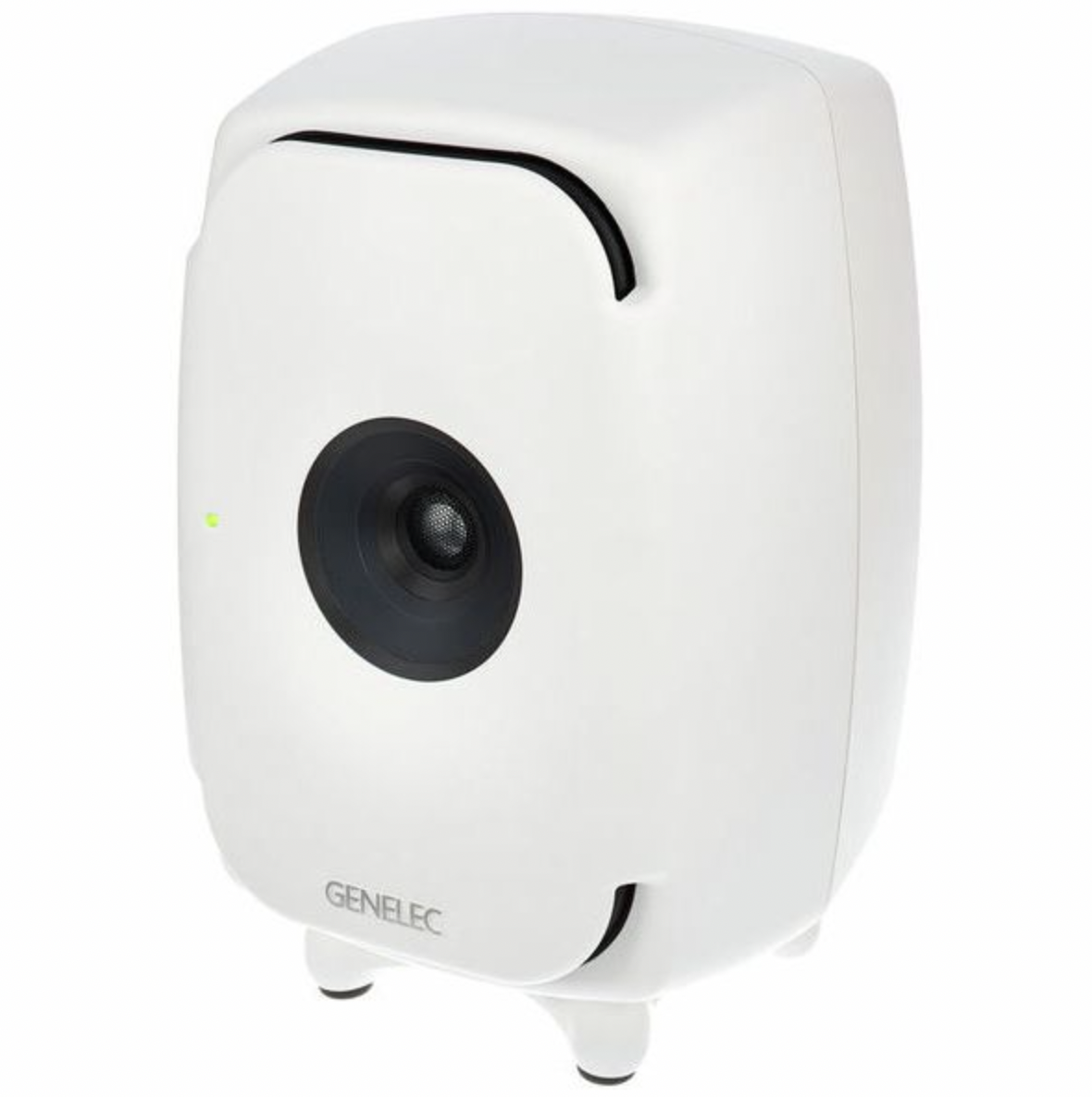

Thanks for posting that!. It took me a few seconds too recognize what I was looking at because of the darkness of the horn picture and I was using my phone. That isn't a synergy, it breaks all the rules. The woofers are as far from the throat as possible instead of as close.
Its a waveguide with woofers around its rim - exactly what I've been simulating towards the end of this thread
misnamed line array....look back from end for relative content
If you put the woofers out at the mouth of the horn you don't get 1/4 summation like a synergy but the results are substantially the same across a listening window at a distance. You can do the trigonometry for the change in distance from CD diaphragm to LP vs woofer cone to LP when the LP is moved from on axis at say 3m to some distance off axis and see you can move quite far before it results in 90 degrees of phase change at woofer XO.
I simulated a lot of these with promising results but never built one. I was concerned about how much of the woofer energy would go back down the throat and return to create a null. From these results I would say not much. That is really helpful to know.
Perhaps you're right, it's more like an Genelec 83xx
Nice! I wonder what the price is - and I saw they are made in Latvia, so no import fees. There is also quite a lot of information useful for building one's own version.

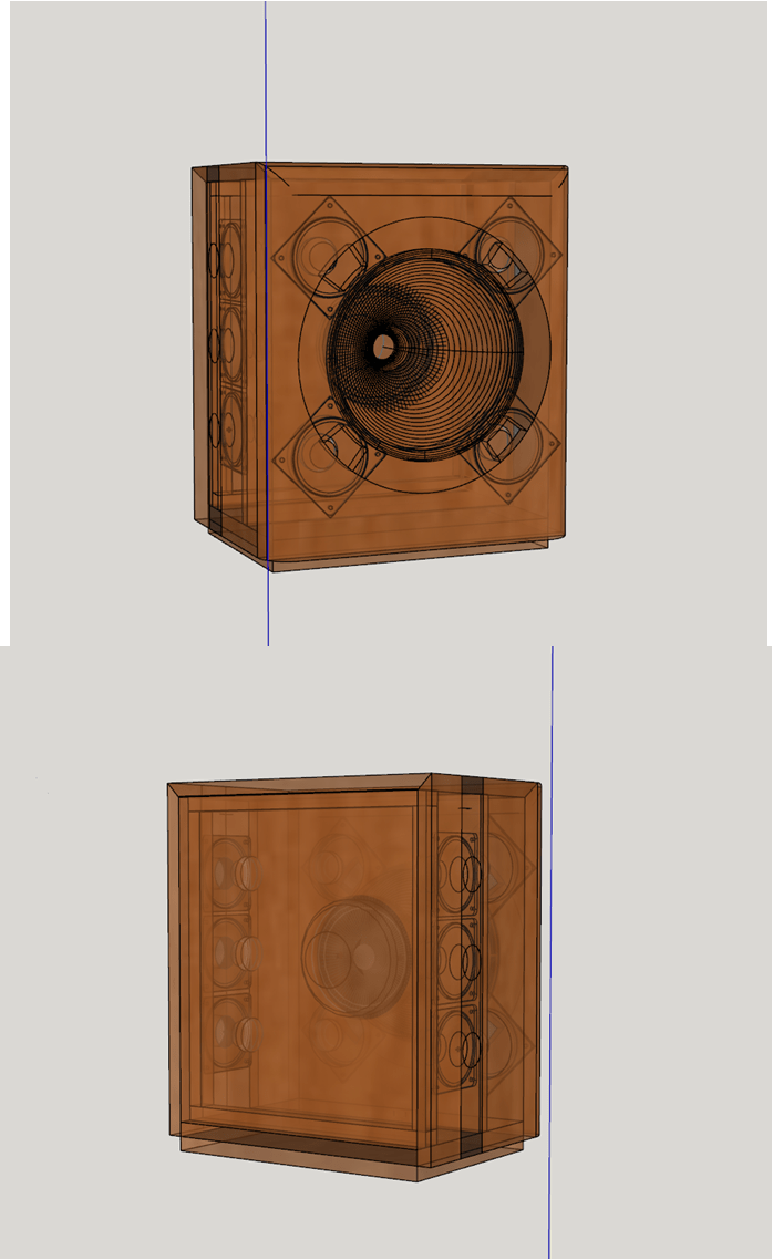

Its easy enough to make your own if you are into 3D printing. Use ATH to make an axisymmetric waveguide that terminates in a baffle Surround the waveguide with 3" drivers on the back side of the baffle feeding through bandpass holes at the rim. Sound easy? It is now with this proof of concept. I confess not quite easy enough for me since I didn't do it. I was all set to go but got caught up in a non-audio project... I have a fairly complete design in Vituix and Sketchup if anyone wants to see it.

I certainly am. Cheers.I have a fairly complete design in Vituix and Sketchup if anyone wants to see it.

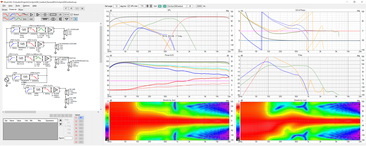

Vituix and sketchup screenshots are attached. The Vituix shows a near ideal response. The first row of the schematic shows the DSP equalized response of a 200mm diameter ATH generated 1" exit waveguide crossed over at 1200 Hz. I would use BMS4550 with this.I certainly am. Cheers.
The next row of the waveguide is an array of 4 DMA80 3" drivers that play through bandpass holes at diagonal corner edges of the waveguide. You can see this in the xray view.

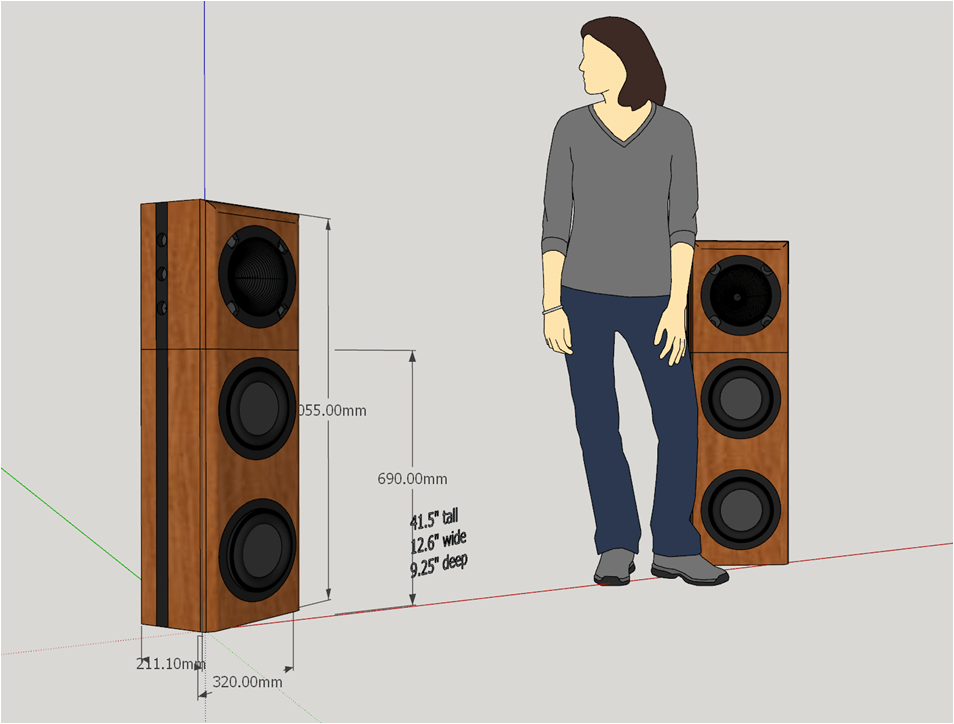

The next row is the two side arrays. Each side array is 3 DM80s playing through bandpass holes disguised by the black vertical stripes on the cabinet. You can see in the xray back view that a vertical partition separates the top cabinet into front and rear volumes.
The next row is global equalization. I first dial in a textbook LR4 XO between CD and rim drivers. I next add the side arrays with the same equalization as the rim drivers but delayed and inverted for cardioid. To shape/optimize the cardioid response there is one PEQ in this chain. It is high passed at 100 Hz so side and rear rejection extend down to there.
Finally, on the bottom row is a stack of 2 UM8-22 8" subwoofers which provide enough bass for full range music up to 105 db peak SPL. The waveguide has a trim ring to hide/disguise the bandpass holes. The UM8 has a matching trim ring to match.
