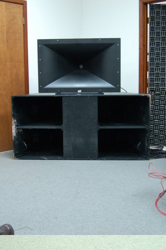

If you refer to the drivers in the Jubilee, it used to use the K31 driver which is the same woofer used in the KLF-30 (in the event you can find a pair of those). Something happened with the vendor of that driver and Klipsch now gets a similar driver from someone else.
Here's Rigma's build DIY Klipsch Jubilee
I will say this... I've heard him say after building them that had he known how much work was involved, he would have simply bought them and been done with it. As a side note, he has since bought 5 more factory bass bins.
Yeah I understand they will be a lot of work. But thats part of this project to me...will be a challenge. good LORD! 5 more?! That is some system...so i take it he likes them!
I will check out the link you sent! The klipsch drivers will be a problem...however if I can find the thiele measuremnts, I am sure there are drivers around that can do the job.
This won't be a quick job... but I think the results in my space could be spectacular.
Cheers and thanks!!!
A
Oh! Coytee!
Do you know where he got the plans?
I have found some revised ones on the Klipsch forum after doing a search. I think they must be ok but sometimes they are really hard to read. The angles will be fine and measurements and cutting also no probs... the glueing will tricky though!
He's a mechanical engineer and had a CAD/CAM (or whatever it's called) software package. I think he took the measurements he could find and slapped them into his program knowing that it would not allow open measurments.
Also... from what I understand, if you get everything "close enough" you will have similar sound. I do not know how close 'enough' is.

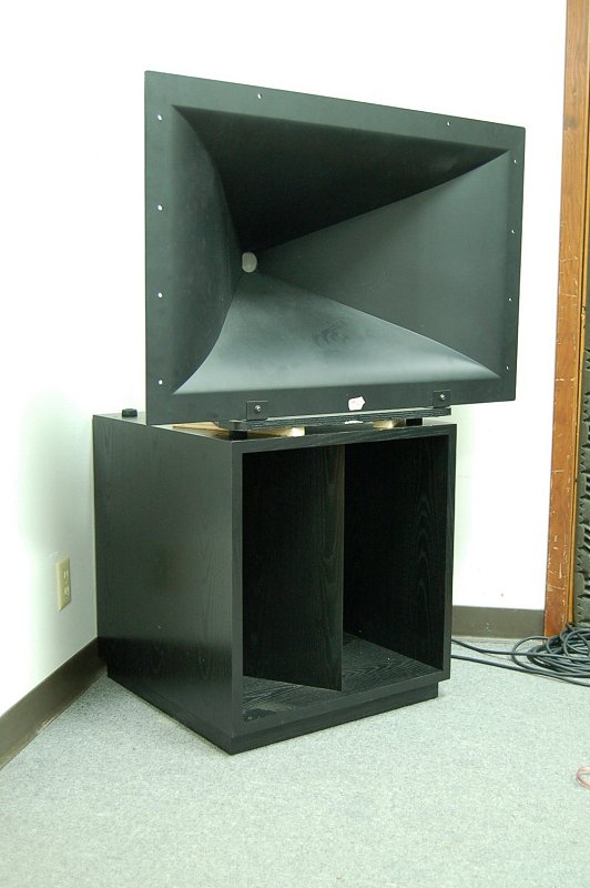

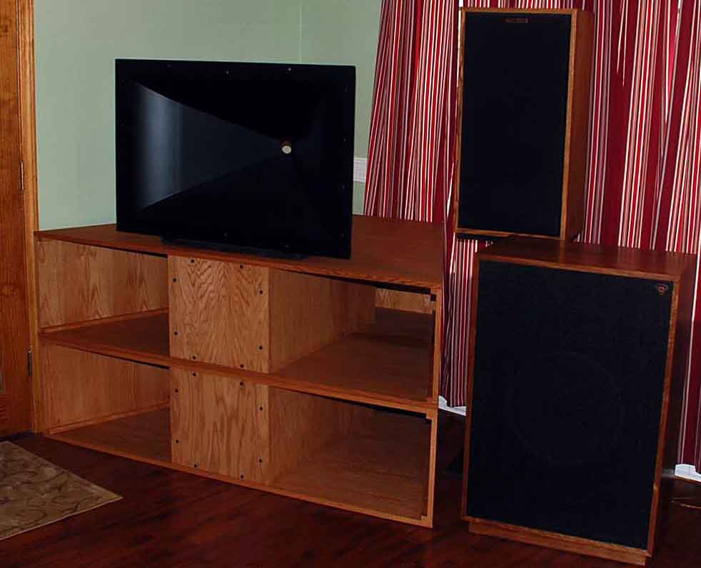

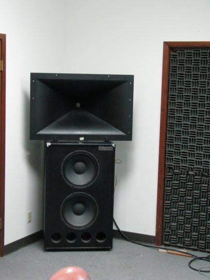

I will say this... I think the real secret sauce to the speaker is the huge horn on top. I've heard that horn on top of their MWM, Jubilee, LaScala and one of their cinema (415?) bass bins. The cinema bass bin had four 15" direct/radiator drivers and the Jubilee with two 12" drivers pretty much went toe to toe with it.
The K402 is the star performer in my book (though I admit it's a package that goes well together)

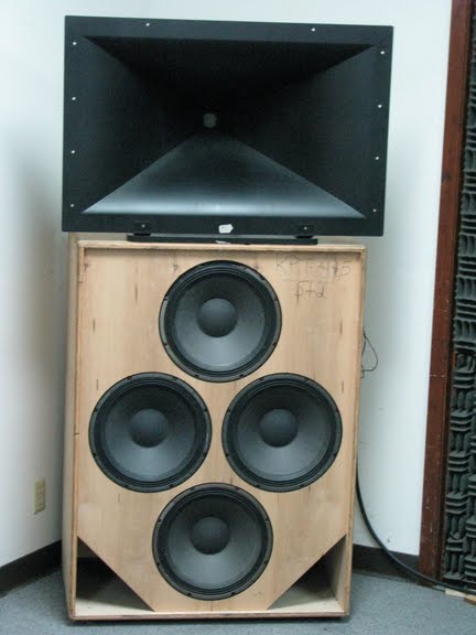

Here's some pictures.

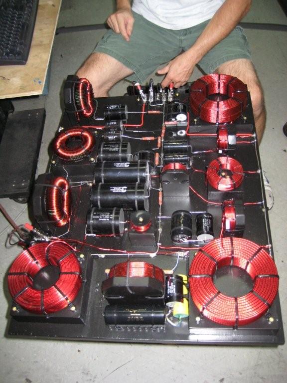

The picture of the passive is what the engineer built. My understanding is he used the design as provided by the factory and bought the best parts he could buy. He's got something like $3K in parts alone in that bad boy (pair of them). It weighs something like 40 pounds (I helped carry it at one time)

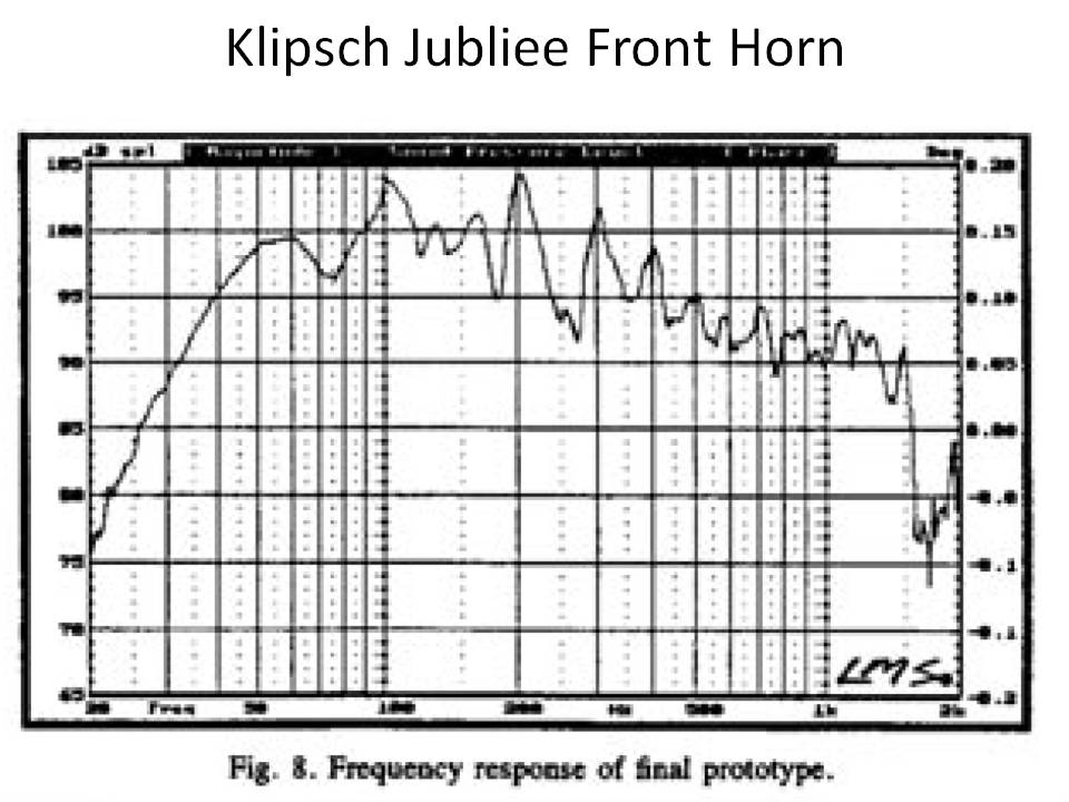

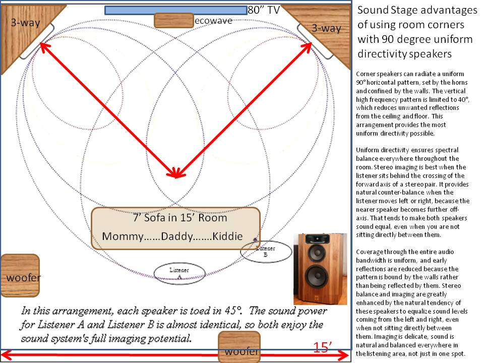

A review of the SPL vs. Freq curve for the Jubilee Corner Horn Woofer helps support Dr. Geddes work on multiple sealed woofer room swarms. A sealed or ported woofer also gets the ~5db corner gain and 90 degree controlled directivity. Sealed woofers make sense if digital room equalization and/or digital Xovers are used. A Grand Piano’s low A 27.5Hz is easy to reproduce with low phase shift using a sealed woofer.

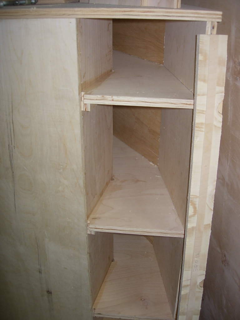

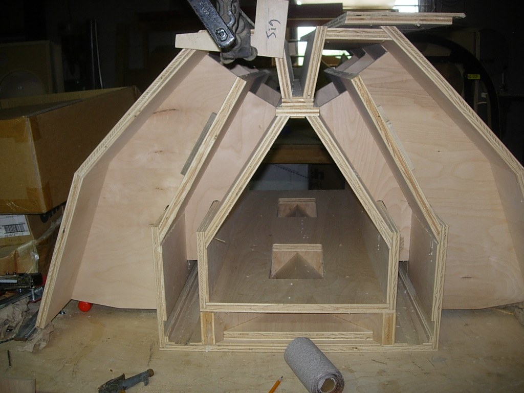

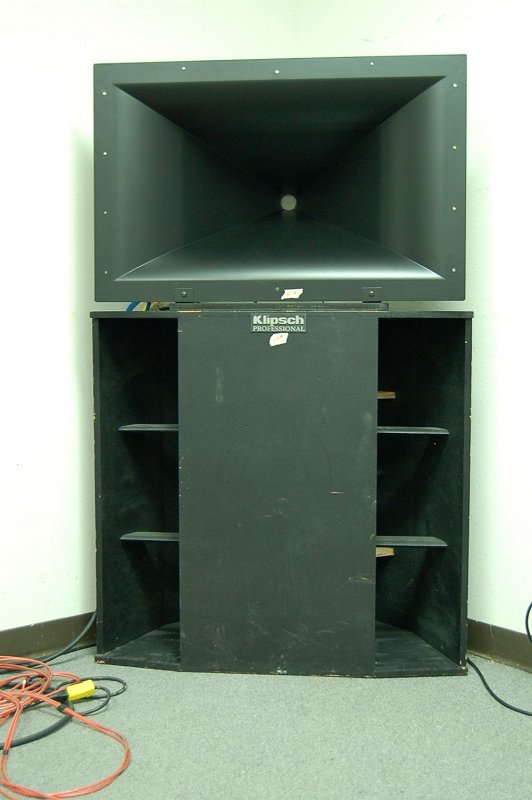

Here's how they're currently building them. Roy (co-designer) wanted to make it an easier and stronger build. The box itself is essentially the same with the big difference being the "shelves" instead of braces on the inside of the bin.
