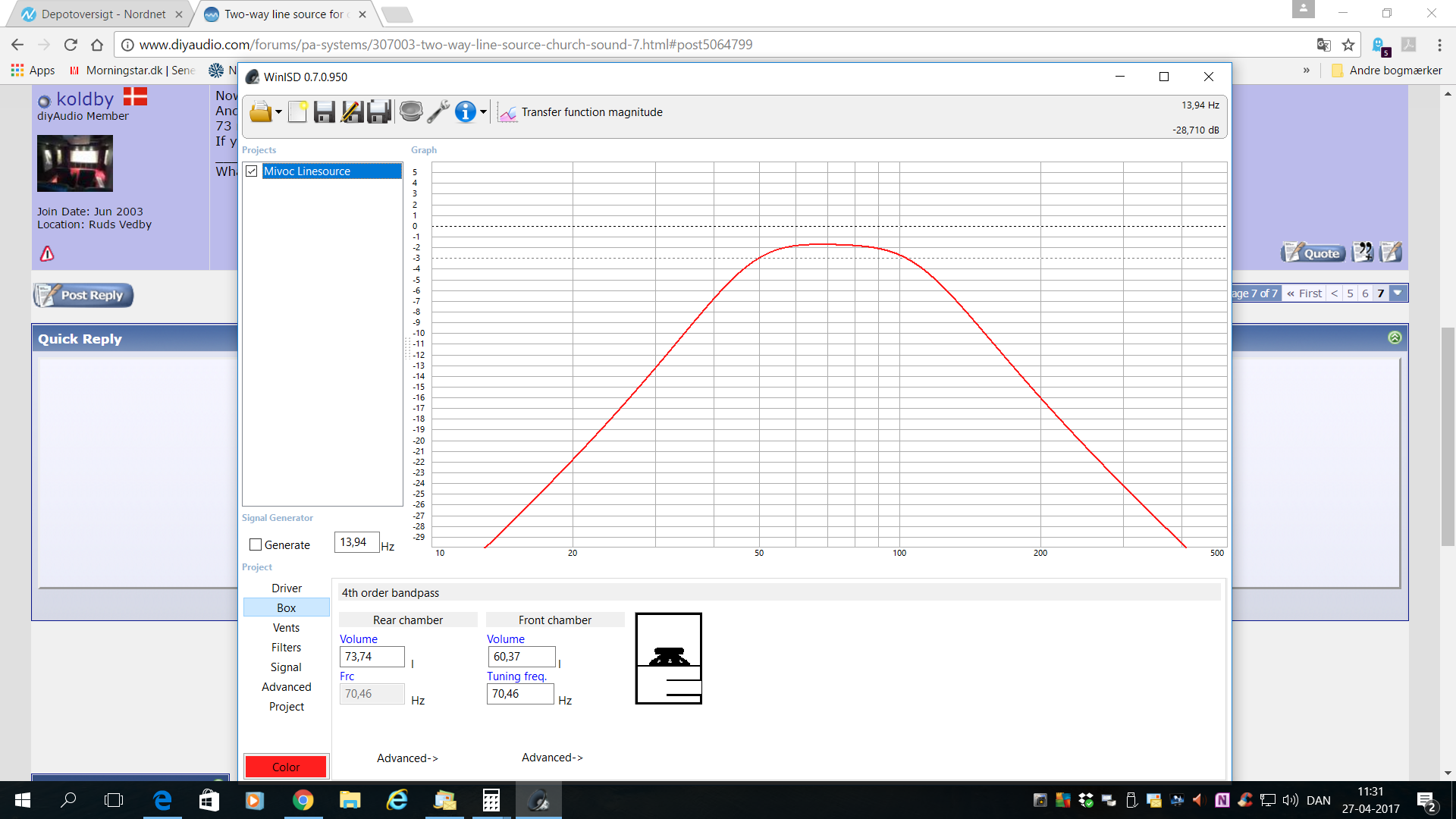

So in order to get more area where the sound comes out, here is another idea.
Back chamber is now in front of the Mivoc´s and front chamber in the back. Vents are behind the cabinet and opens at the top and bottom.
Now the area is 1176 cm´2

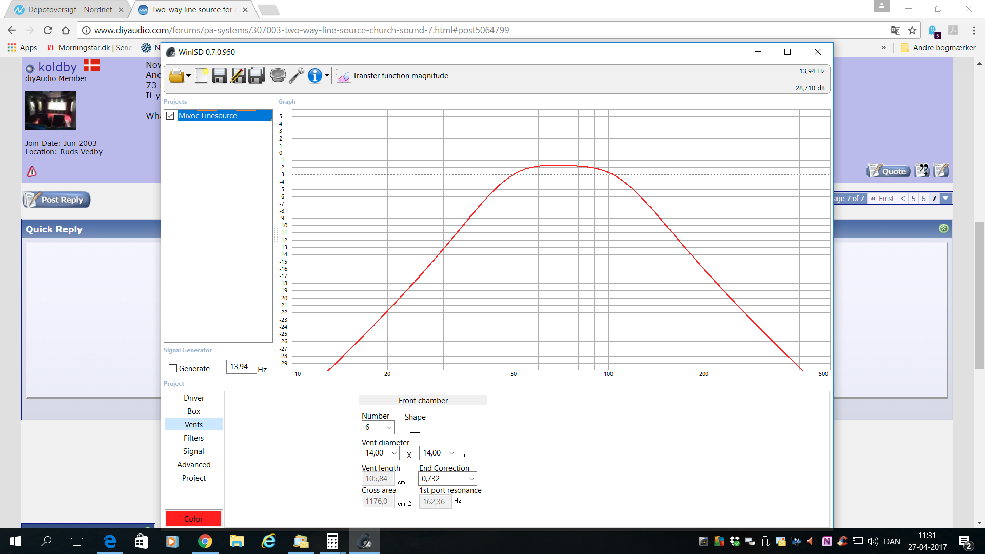

The Sd of one woofer is 214cm2 so 81 is about 40% of that. Synergy style ports use 20% of Sd and upwards to keep the velocity under control. 81 per driver is actually quite a lot of vent.Oh - ok I see now. Great.
I think I might have a little reservation concerning this design. The mouth area of the 4 vents is pretty small. Even though WinISD says the velocity is ok small, the combined area of the vents is only 81 sq.cm!
In order to move the air in a big room there has to come a LOT of air out (and in) of these vents.
I think it will work better if you vent each woofer separately otherwise you lose the array effect in the bass frequencies.

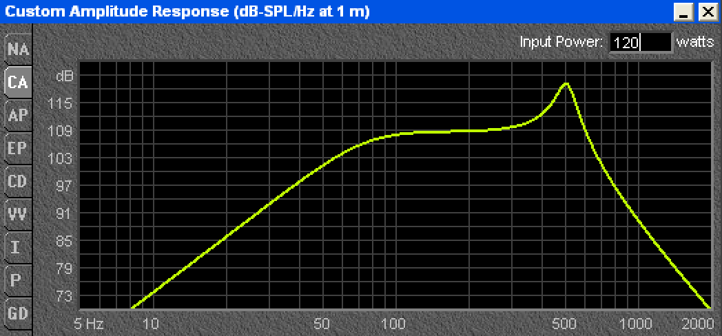

I ran another sim for a single mivoc in a synergy style baffle mounted face down with two 40mm holes cut in a 19mm baffle as ports. They can take the rated power without reaching xmax so there is room to EQ the bottom end particularly when you have 9 together.
7 litre rear and 0.6 front which is more realistic for the cone volume with a spacer for the surround. Vent velocity is 18 m/s at 120 Watts.
OK well that is very small then, I only saw one woofer in your drawing probably explains why the sim didn't match I don't bother with modelling more than one or two drivers because all that happens is that the output goes up by 3dB in the graph which doesn't always help get a better picture.But 81 was for 9 units!

Re vent opening: although the CSA has risen significantly, it still seems rather small. But, I can't get a reasonable result from ISD too. So, BP may be out of the game?
Re line array effect: that's what I wondered all the time - when having the low end section in a BP enclosure, where goes the desired line arry effect?

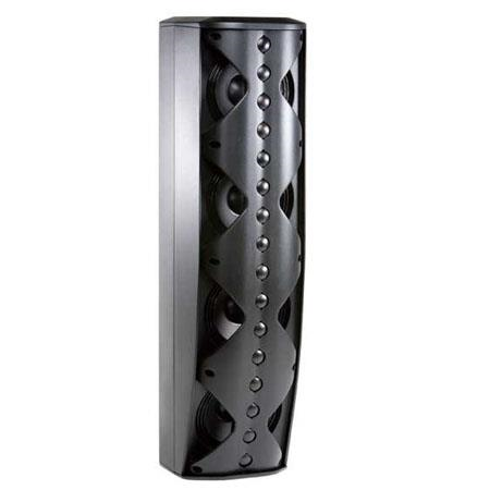

Which is why I still think even the first proposition would work. Kind of makes me think of the CBT line arrays from JBL:
Though our tweeters are way bigger here .

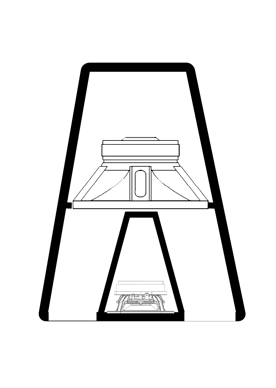

Wesayso's drawing is a good example where the white line is across the front you could put a vent hole on each side of the TC9, it can be as big as you want but 2 x 60mm will get you above 20% of the cone area and keep the vent speed down. Put a separator between each driver and the front volume of the horn becomes the chamber volume.
Or you can just leave it open.
Wesayso's drawing is in fact the first sketch I posted in #2
The difference is in the transparency which makes it look like there is a baffle across the front in white which is where I would put the vents.
I would build a test cab for one woofer with the area for the TC9 cabinet included. Measure it without the baffle then add a baffle over the front with the vents.
Then you will know what the difference is between the options that fit your wish for a slim tower.
