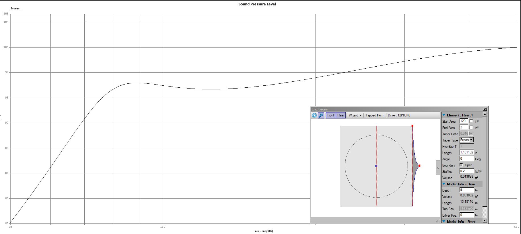

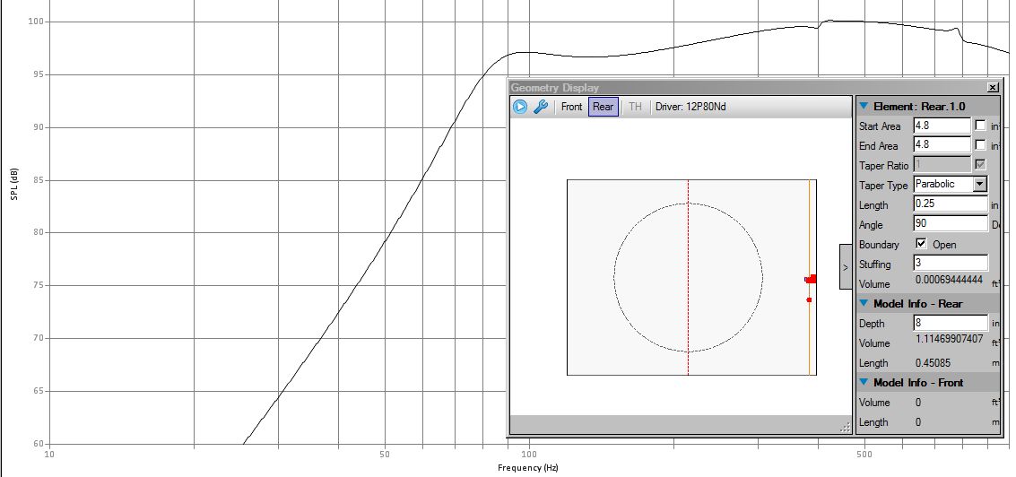

Leonard Audio Transmission Line simulator is a good tool to model aperiodic loading options for the 12P80Nd.
~80Hz F3 aperiodic
~200Hz F3 sealed
You will need a woofer with either design. You can always plug the aperiodic port after listening/Xover experiments.
~80Hz F3 aperiodic
~200Hz F3 sealed

I am very interested in your aperiodic design for the 12P80Nd. I downloaded Leonard Audio's TL sim software but I didn't find it very intuitive. Could you elaborate a bit more on such an enclosure please?
Line Source,
Attached sims for Beyma 12P80Nd midbass with a short-exponential stuffed aperiodic port, and with a long-expontial stuffed tapered tube. Hope this helps you with LeonardA TL tool.
3-way. Putting the 12P80Nd in a clever shaped small volume, well stuffed box will have an F3 ~210Hz and typically produces the best transients. A 43"H x 22"W cabinet baffle would have a baffle step around 210Hz, which could provide smooth blending of the sealed 12P80Nd with a woofer(18" would fit)
If you plan to use the TPL150(Horn of some kind) you might find useful info or measurements in other threads on a 60H x 40V custom horn that should match the narrow polar of the 12P80ND at 1500-1600Hz for a smooth directivity transistion function.
