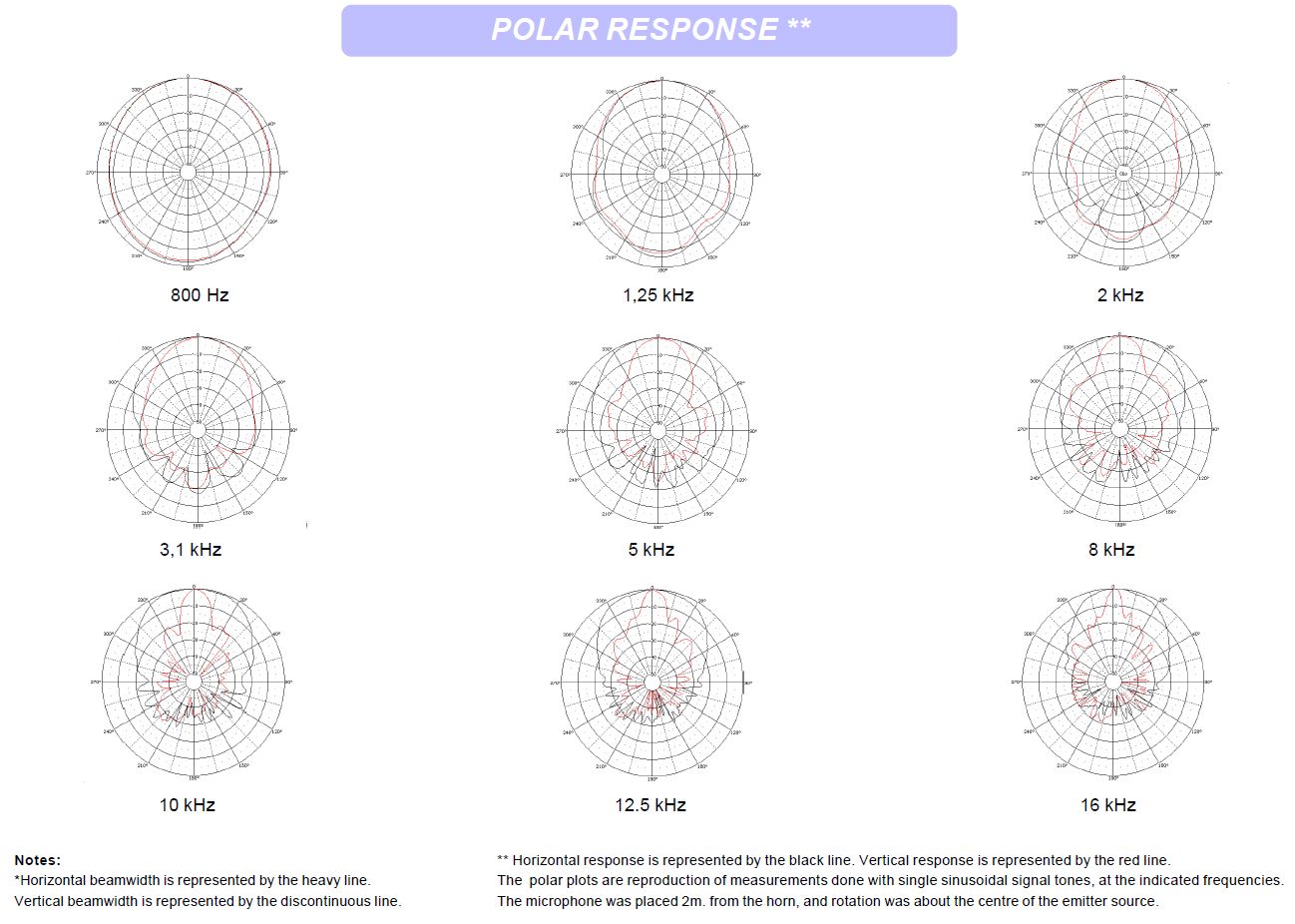

A 15" JBL 2226H cone is too large for a great TPL150H marriage. A 15" woofer cannot reach the required 1400-1600Hz without severe beaming, cone break-up and SPL droop from cone mass.
It has been well established that a smooth controlled directivity function is necessary for great sound. An abrupt change in directivity between two drivers changes the ratio of room direct/indirect energy, which changes the sound stage at the listener.
IF you are set on purchasing the Beyma TPL150(H) AMT tweeter, you will want to study the polar response vs. frequency, and select a midbass which matches this polar map at the crossover frequency. The standard TPL150H Horn has an 80H x 40V polar response.
TPL150H mates easiest to 8" - 10" midbass with ~1600Hz Xover and 80 degree polar response pattern. Naturally, smaller midbass drivers reduce the SPL/watt efficiency.
DIYaudio TPL150 users favor 1600Hz Xover, and some accept 1400Hz Xover at low home SPLs. Challenges/solutions with Beyma 12P80Nd integration include: 1400Hz Xover with stock 80x40 horn and accepting low SPLmax, or 1600Hz Xover with custom 60x40 horn. A 12P80Nd in a small sealed box has F3 ~ 210Hz. A 12P80Nd in an aperodic box has F3 ~80Hz. The strong motor and low Qts in the 12P80Nd create a fast and controlled response, at the cost of limited bass. The 12P80Nd is typically used as a large midrange. Its 5.456% efficiency is about 2x a typical 12" woofer. Doppler type IMD starts to become an issue when wide bandwidth is demanded from a large diameter midrange.... you need a woofer.

Okay, polar response vs frequency is something I definitely don't know much about. I have read a little bit about directivity, but is that the same thing?
