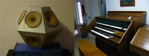

Two Truncated Pentagonal Pyramids for an Enclosure - an interesting Approach to circumventing the intrinsic Disadvantages of Full Range Drivers?
Reactions: MalVeauX

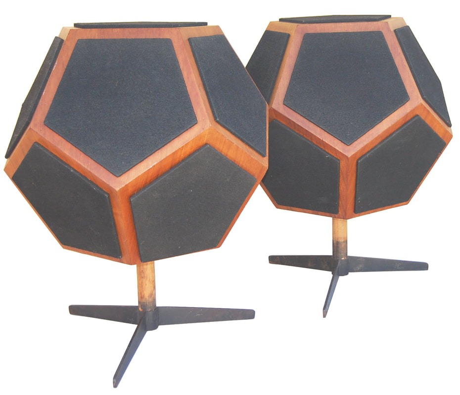

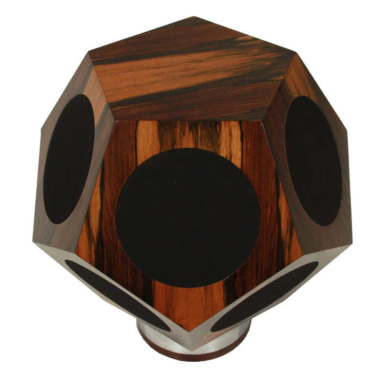

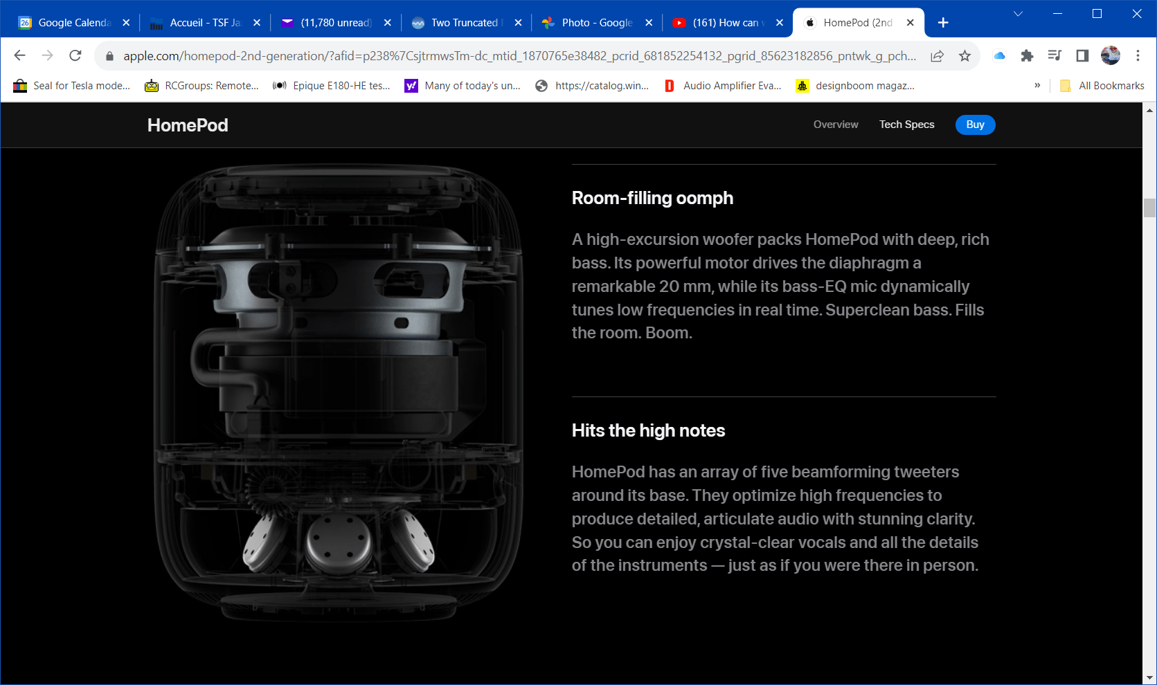

It depends on the goal. The speaker shown will have a smooth omni-directional response up to about 2 kHz and then transition to a repeating directivity pattern with lobes in the response above 2 kHz or so based on the cone size and spacing. It could make for a fun effect. Designing a speaker with a really uniform omni-directional dispersion pattern that is full range into the high frequencies is a challenge. Search this forum for "How to build a spherical speaker?" and "Omni Directional Speakers" to see the efforts of myself and others. There are several commercially available speakers that are omni-directional horizontally. The Beo-90 has a nice white paper that describes the experience of listening to speakers with various radiation patterns, wide, narrow, omni. The mass market HomPod 2, omni-directional speaker, from Apple looks pretty good and very inexpensive for what you get. It uses a ring of folded tweeter horns to get 360 degree dispersion horizontally.

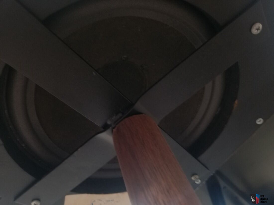

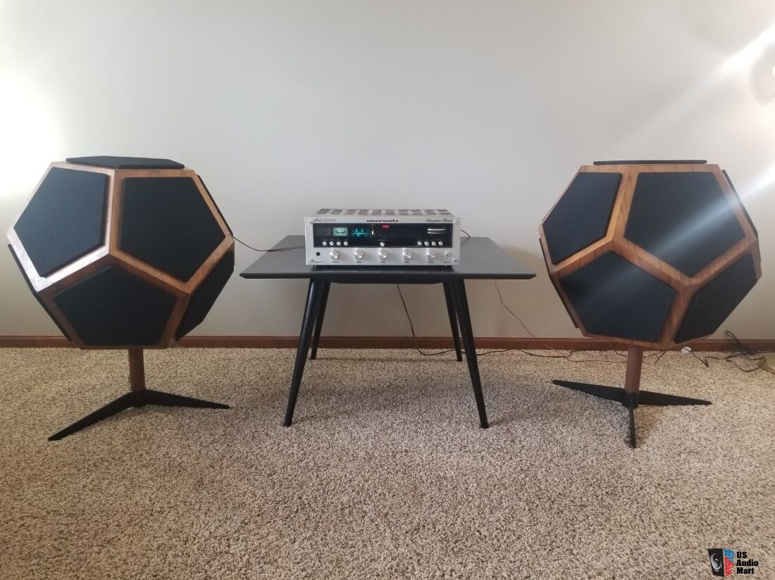

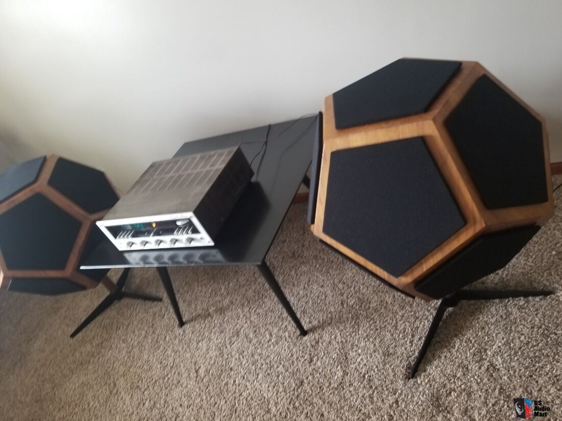

  • 3601565-bfa514cf-design-acoustics-d-12-dodecahedron-omni-directional-loudspeakers-vintage-1970s.jpg
  • 3601573-1a39f7a3-design-acoustics-d-12-dodecahedron-omni-directional-loudspeakers-vintage-1970s.jpg
  • 3601570-1851080a-design-acoustics-d-12-dodecahedron-omni-directional-loudspeakers-vintage-1970s.jpg
  • 3601575-e307c187-design-acoustics-d-12-dodecahedron-omni-directional-loudspeakers-vintage-1970s.jpg
  • 3601571-21f464e0-design-acoustics-d-12-dodecahedron-omni-directional-loudspeakers-vintage-1970s.jpg
  • 3601574-d7c04c30-design-acoustics-d-12-dodecahedron-omni-directional-loudspeakers-vintage-1970s.jpg
in then PDF attachments a test review of DESIGN ACOUSTIC - D12 SPEAKERS
