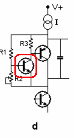

I'm trying to use the Vbe multiplier (d) shown in http://www.renardson-audio.com/B-amp.html but I'm not sure which one is the "sensor" transistor.

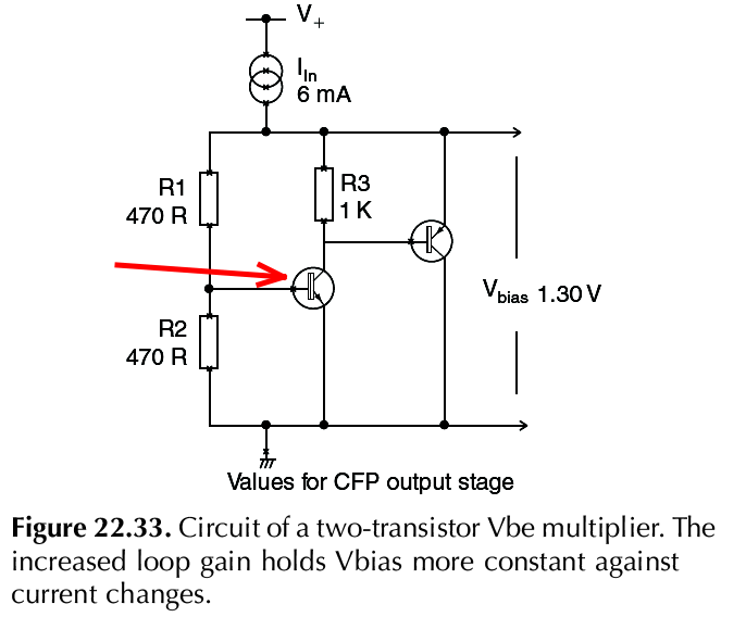

D. Self refers to the same circuit in his "Audio Power Amplifier design" 6th edition book: "The first transistor is the sensor." But cant say which is the "first".
I would appreciate some help.
Thanks.

Agree with Tom. Q2 is inside Q1's NFB loop, and obeys Q1's commands.

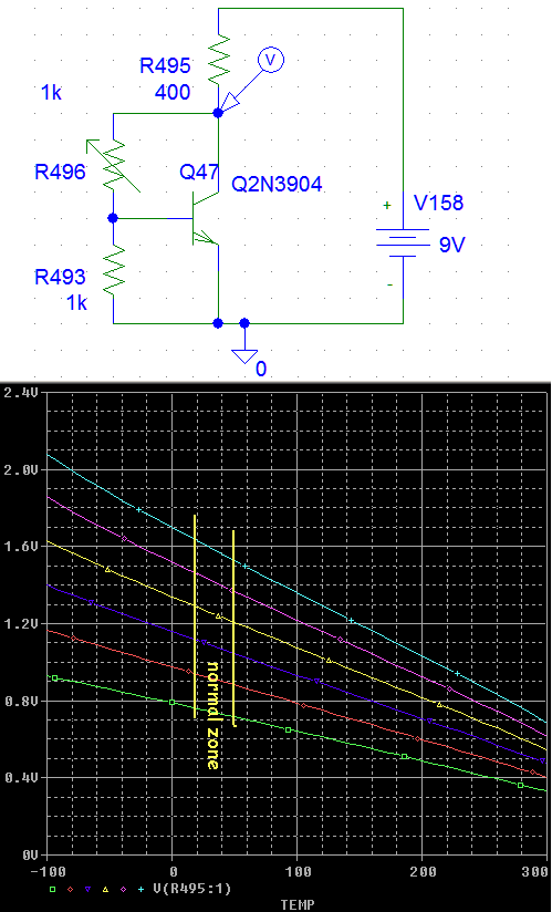

Don't believe me? I wouldn't. EXPERIMENT. But simplify. 9V battery, 3k resistor. Creme Brulee Torch (or lighter, or soldering iron...)
Meter the "??" point to ground/0V. Does it drop when you cook Q1? Q2? Hypothesis: Q1 has the most effect, Q2 almost none except by blow-by heat getting to Q1 (some heat deflector may clear this up).

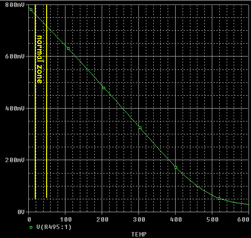

I've never been particularly happy with conventional Vbe multipliers. It would seem that the adjustment pot alters the "volts per degree" slope, and the volts setting is secondary. IOW it is changing the gain rather than the offset. The setting might be right for the temp you set it at, but as it heats up it might either dig in too hard or dry out, depending on the pot setting. Thoughts?
The voltage gain determines the voltage drop per degree. For the emitter base junction this is about -2mV/K. If the gain is g, the total voltage drop would be -2.g mV/K. The non zero base current is a source of error which is kept low by using transistors with sufficiently high gain.
That is sufficient; in fact is a fair approximation to what is happening in the power devices. Yes the slope changes, as it should; this slope converges to zero, in theory, FAR outside "normal temperatures", somewhere around 500 C.
I don't swear the SPICE plots are "right"; I doubt all the small-effects to 500C have been baked into the model. But the trend will be right to a point.
BTW, FWIW: it is not a good idea, but I have worked a Silicon BJT near 350C for several minutes. It must have been leaking like the Titanic, and similar life expectancy, but for the moment it was working. And when I moved it to a heatsink it worked another few years until the hot-shot Pentium it powered got old and slow.

Yes, it is the one you mount in the heatsink. Of course. As most of you said, it is the one from left to right. I made a circuit on a protoboard to test them with a hot air gun as PRR suggested. The voltage dropped as the air heated it. The second transistor has very little effect or has no effect at all when heated. And it is obvious (now for me) as it is a CFP configuration. There are some variations, with other considerations in this kind of VBE.

In the image is a VBE from Douglas Self. The sensor is the one pointed with the red arrow.
Thank you all.

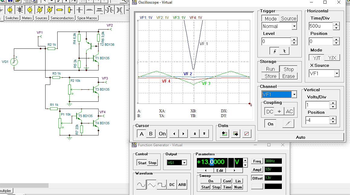

Some moons ago I showed the bias regulator I use. Unlike the circuit in post #12 it is similar, but the variable resistor is used with R3. R1 and R2 are chosen to give the required number of Vbe's which need to be compensated. R3 then adjusts the current in the multiplier transistor so that its Vbe is altered rather than the ratio. I use a 470 ohm plus 10k pot for R3.
And this was posted quite a while ago. Using the exact ratio for a driver+output stage (2 stage EF) it is very stable with e.g. 3k:1k bias resistors but for a 3 stage EF some overcompensation is needed because the output junctions always get hotter than the bias regulator. Still works quite well.
