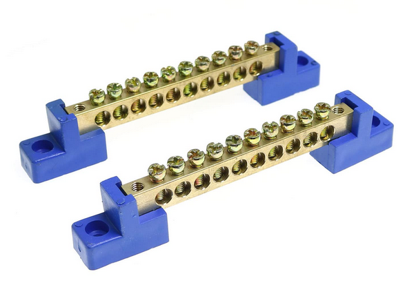

Can some just tell me simply how do I add two Toroidal to one chassis so I only need one power cord? The one I linked has two pairs inputs 115v I believe for one I just tie red red black black for 115v hot and neutral do I do the same with second one...
I share your feeling about all those wires coming together, but to keep it simple, yes, the wiring for the second transformer would be identical to the first. In this case, I would be tempted to use a buss bar just so that there isn't so much copper to deal with at any one point.
