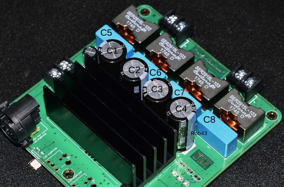

If it were me, I'd Email this company and ask them what caps (C1 to C8) are used plus what Op Amps are used. Upgraded caps are most likely wanted.
Also I'd ask them to install Dip-8 sockets so that you can roll Op Amps in the future.

Thanks for the great questions ROB43.
I will definitely investigate.
The WEB site does state they make each when ordered so hopefully the photo represents a finished design but there is options for higher quality caps and inductors.
Those little IC's you marked got my attention now.
I don't know of any other TPA3255 modules that offer the stereo, mono and 2.1 modes of operation along with the balanced inputs.
The high quality 4 layer PCB sounds very high quality.
$165... I hope the price equates to very high functional quality.
THank you.
C1 to C4 looks like nichicon caps.
Nice, Class-d audio and I have the same thinking to use 4 tank caps, flat copper inductors, and EVM heatsink.
1. Ask them what they've used for linear post regulator, noise floor (THD+N score) mostly depends on it. Using LM2940 will give you same results as EVM (assuming that layout is good)
2. Looks like input capacitors are tantalum?
3. Post filter PBTL Mono mode will just give you capability into 2 ohms load, not performance gain. If you want more hifi and lower THD, 3eaudio approach is better which is Pre-filter PBTL Mono. Which uses only 2 output inductors.
(post filter PBTL not to be confused with post filter feedback, they are different)
4. If I do a layout in 4 layers copper I would have buried most of the traces in the inside layers to avoid copycats haha.

You're welcome.
I like the shielded inductors, so I'd keep them.

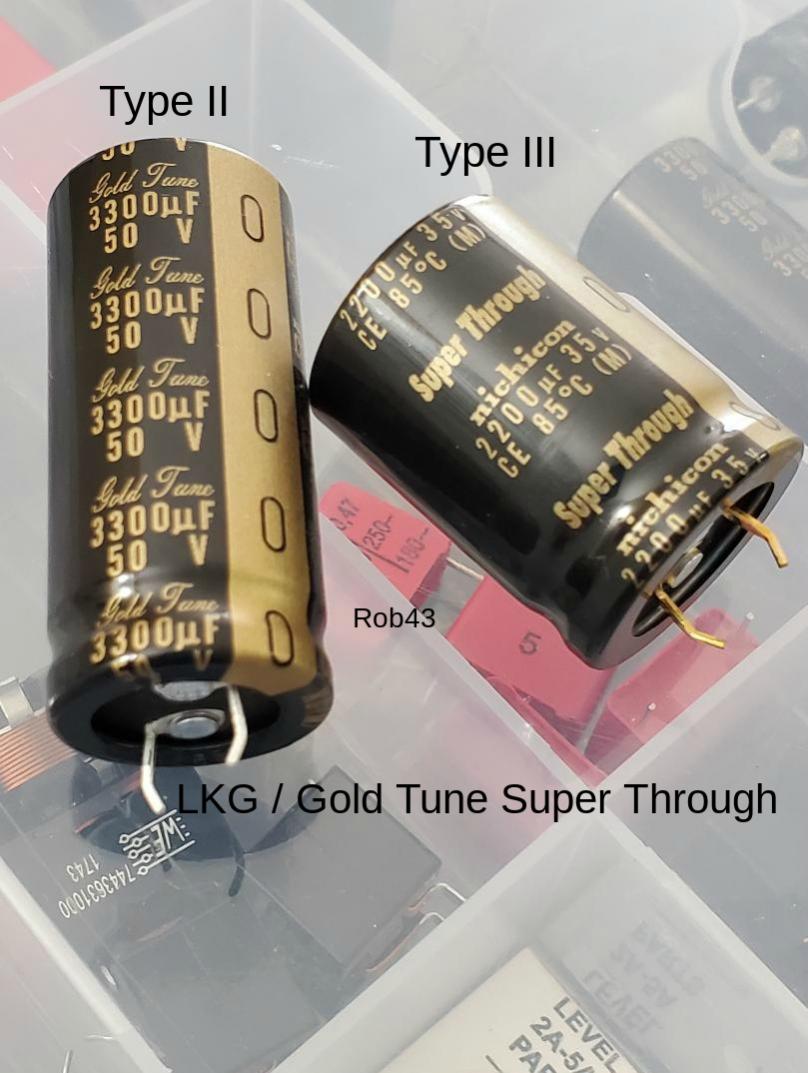

Caps 1,2,3,& 4 "look" like a mid-grade cap, so please inquire about them. If those caps are not to your liking, consider replacing* with the caps in my picture below.
The film caps in position 5,6,7, & 8 look reasonable if they are what I think they are. If you keep them, you could simply put a small bypass cap on each one. For bypass caps I'd consider: Kemet (RIFA) PHE426, Wima MKP 10, or a Russian PIO K40Y-9 all in a 0.01 uF.
If re-capping positions 5,6,7, & 8 I'd probably use either the MKP 10, or the PHE426.
Keep us up to date...
Rob43
* Always take good measurements to make sure any new parts fit properly.
