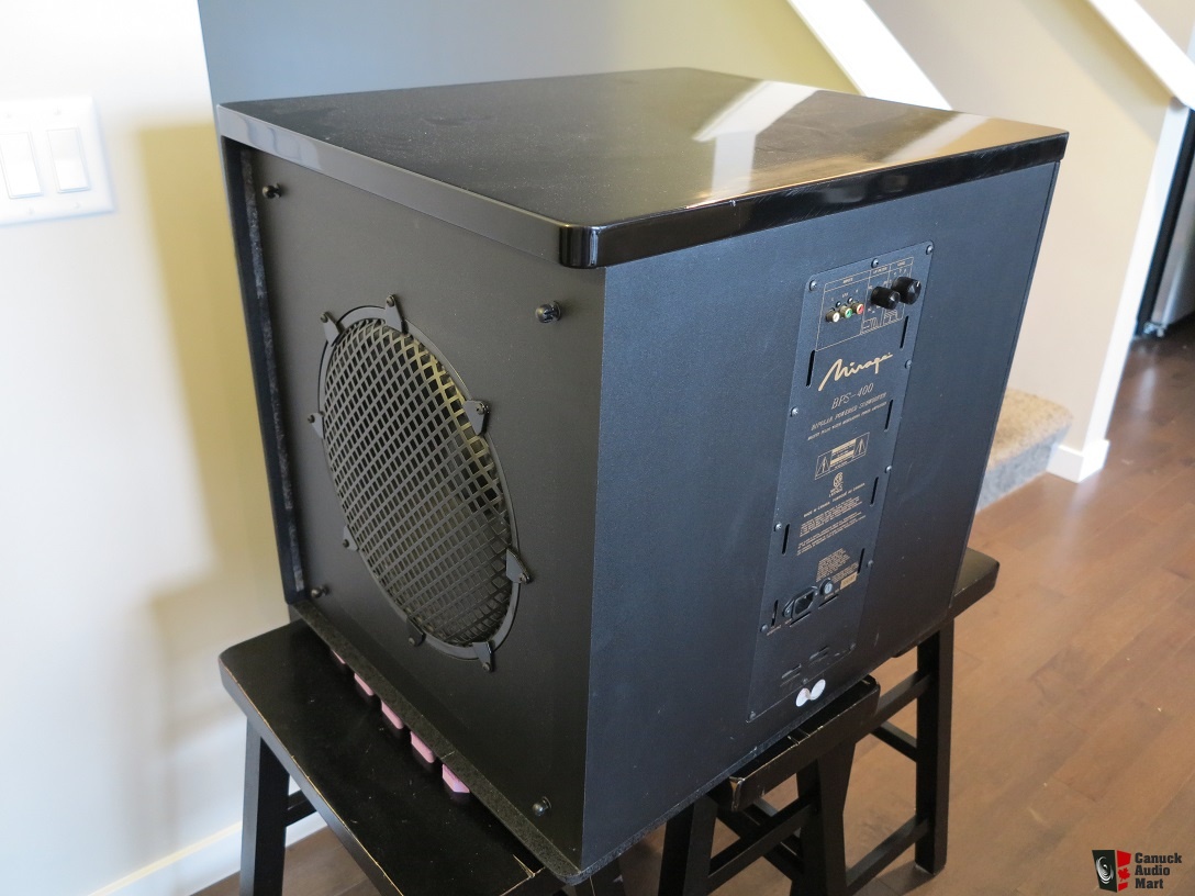

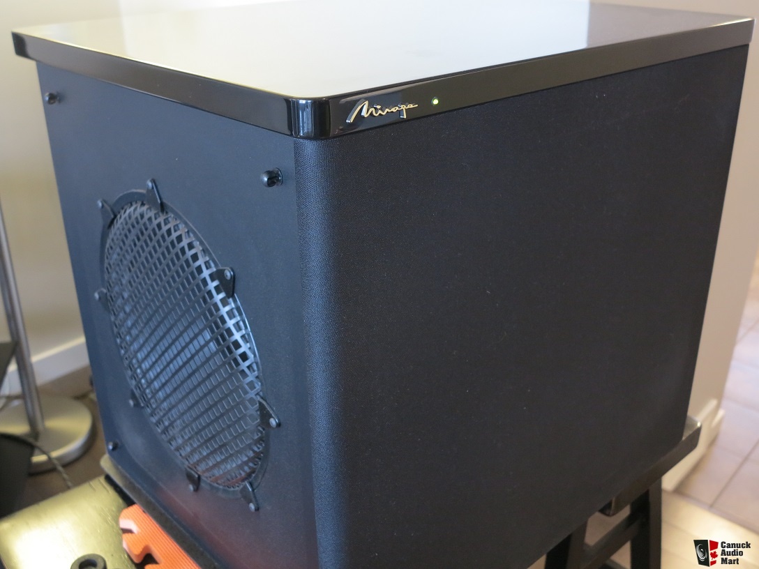

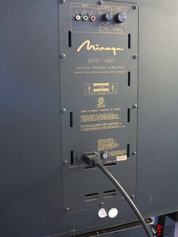

mirage bipolar-400. they stayed with the design through the years.
Maybe some different subs are a good idea? Not all suit all applications as well, or nearly in some cases.
