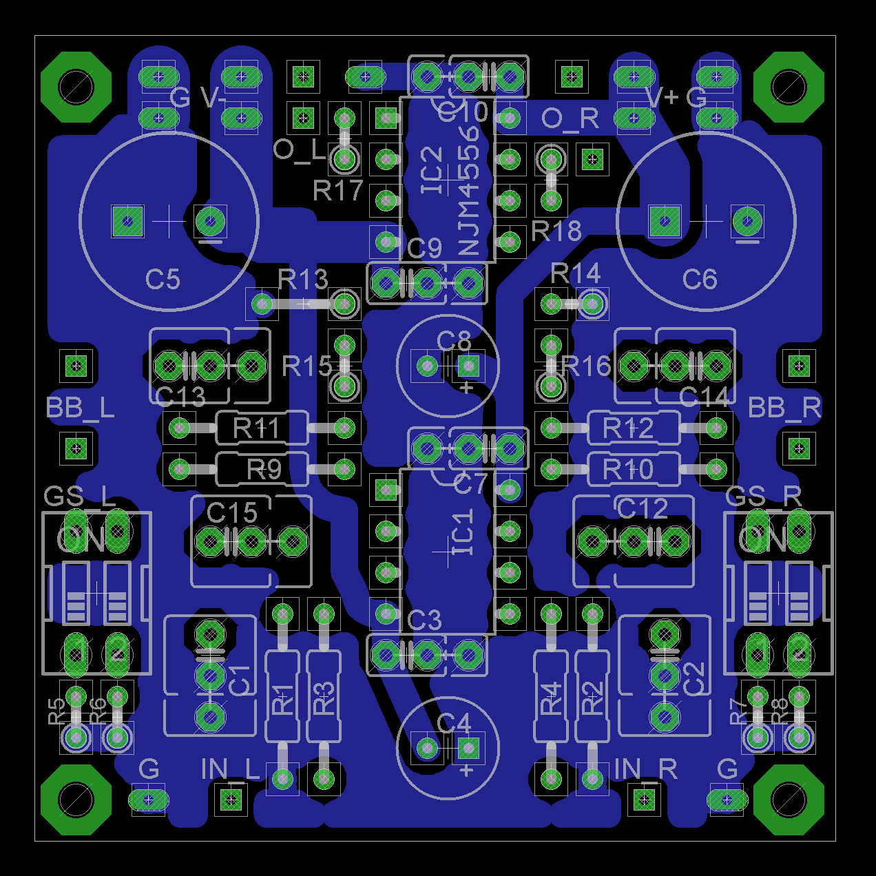

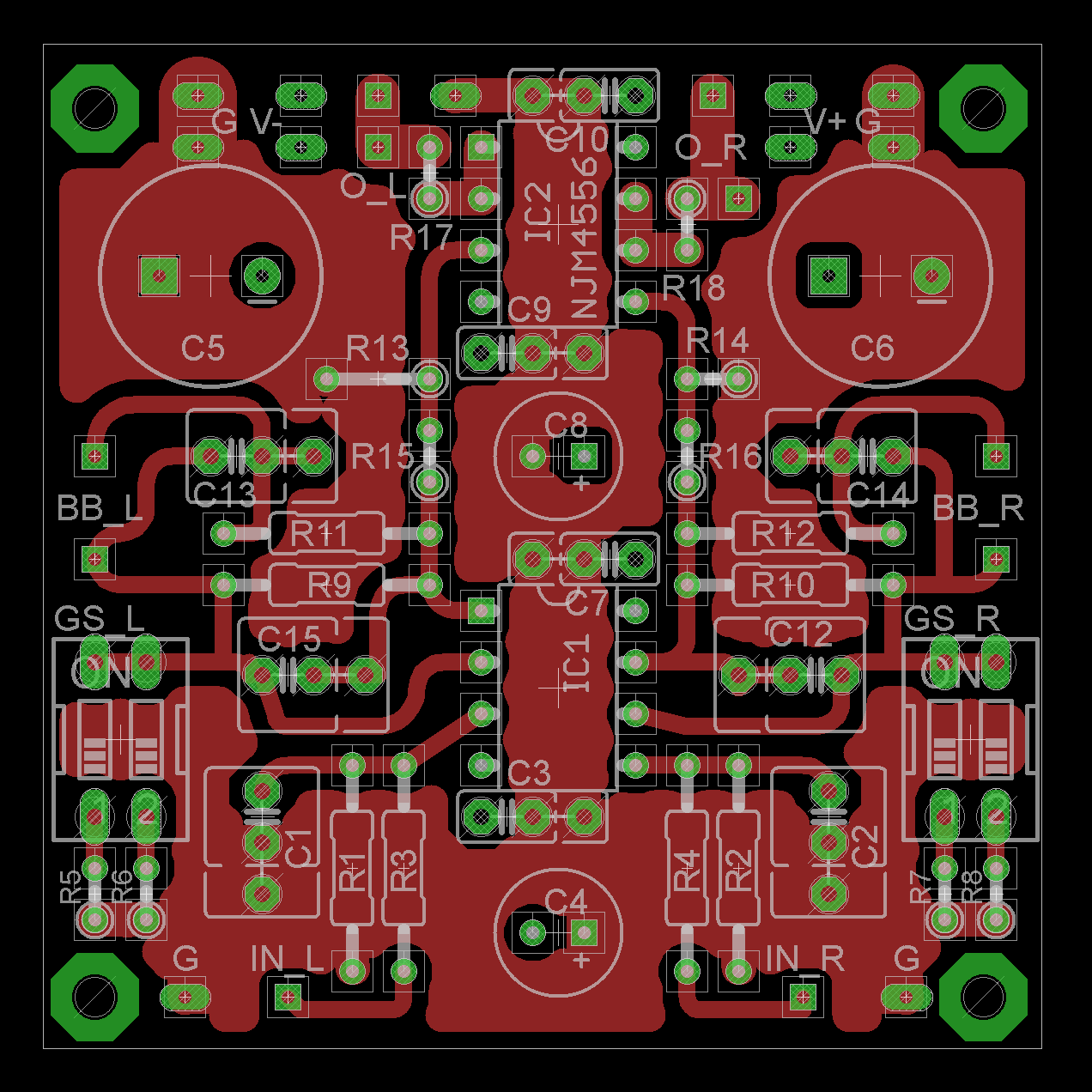

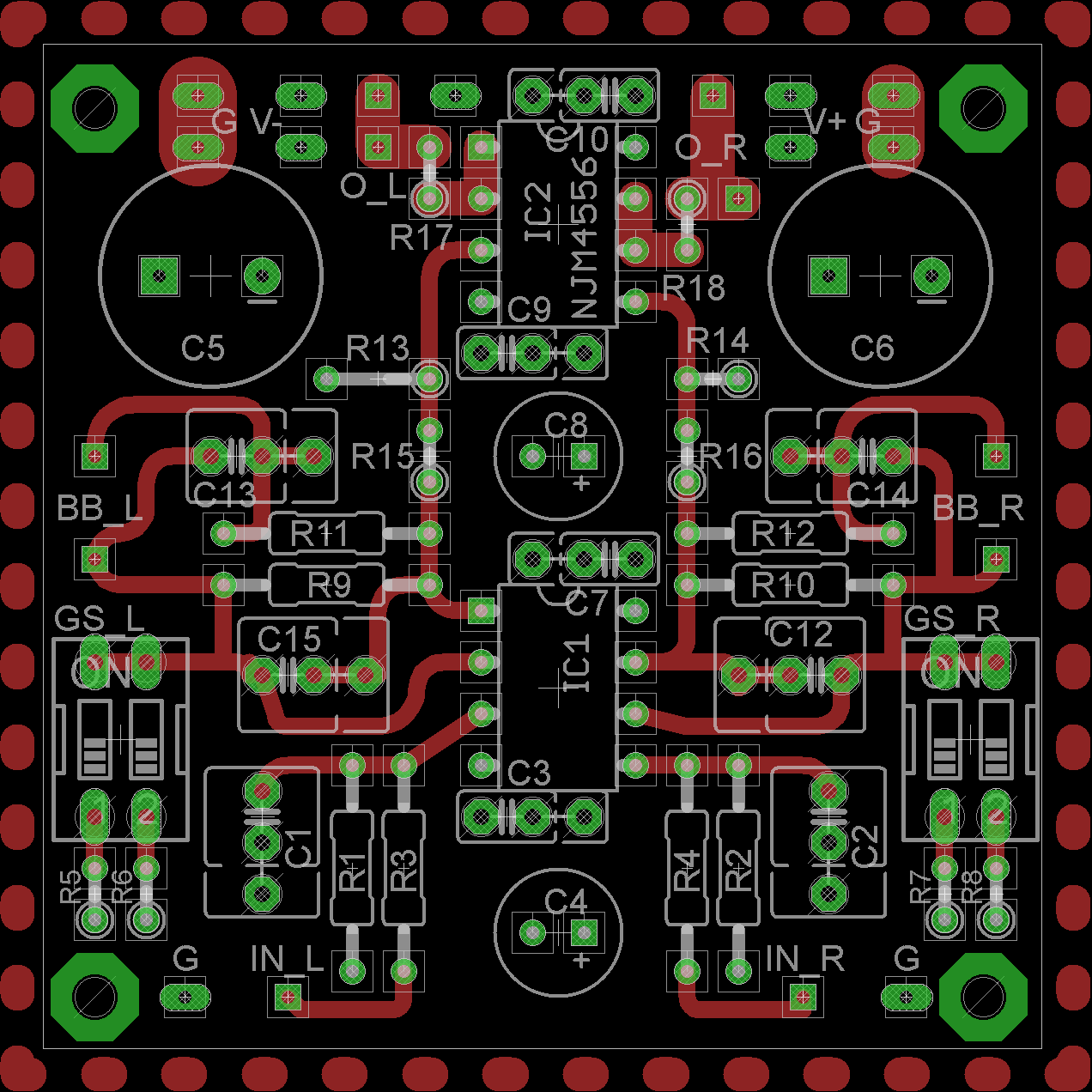

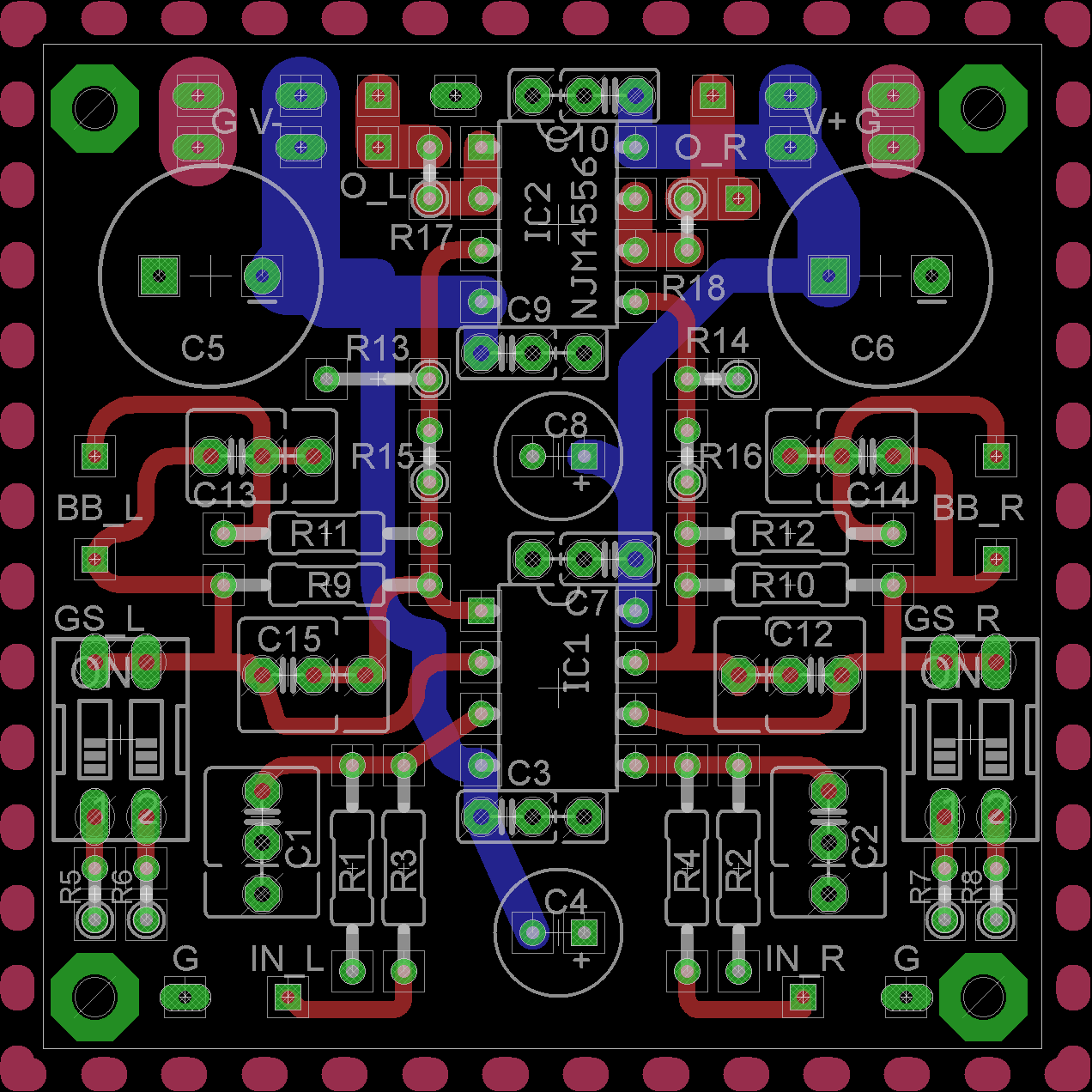

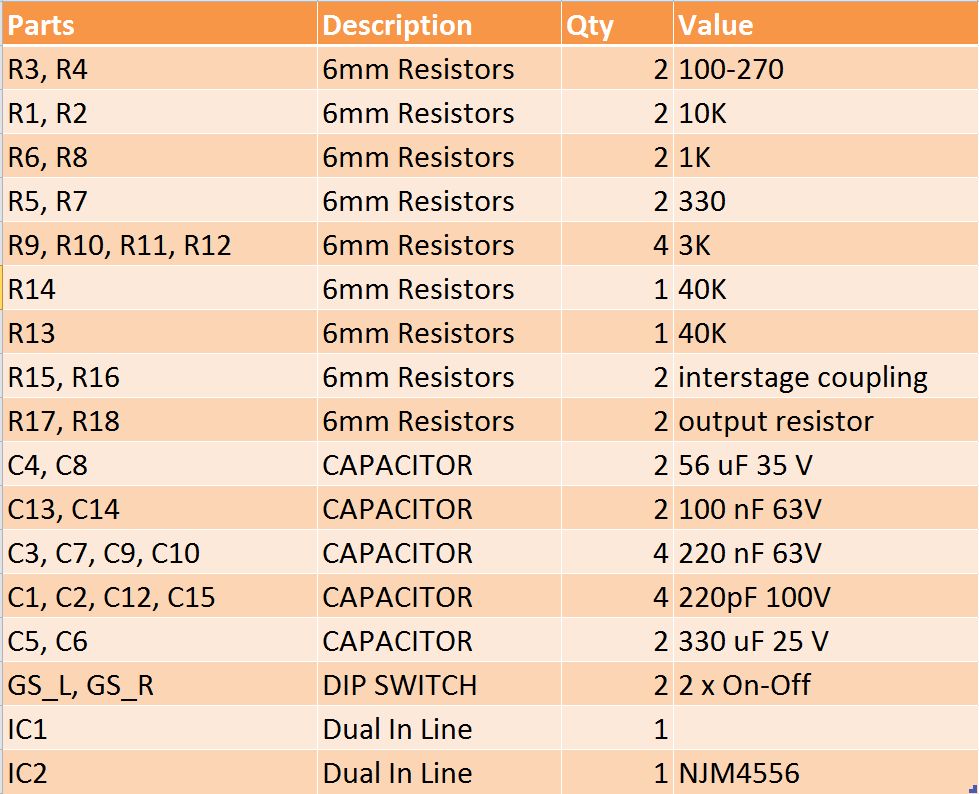

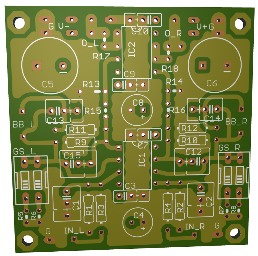

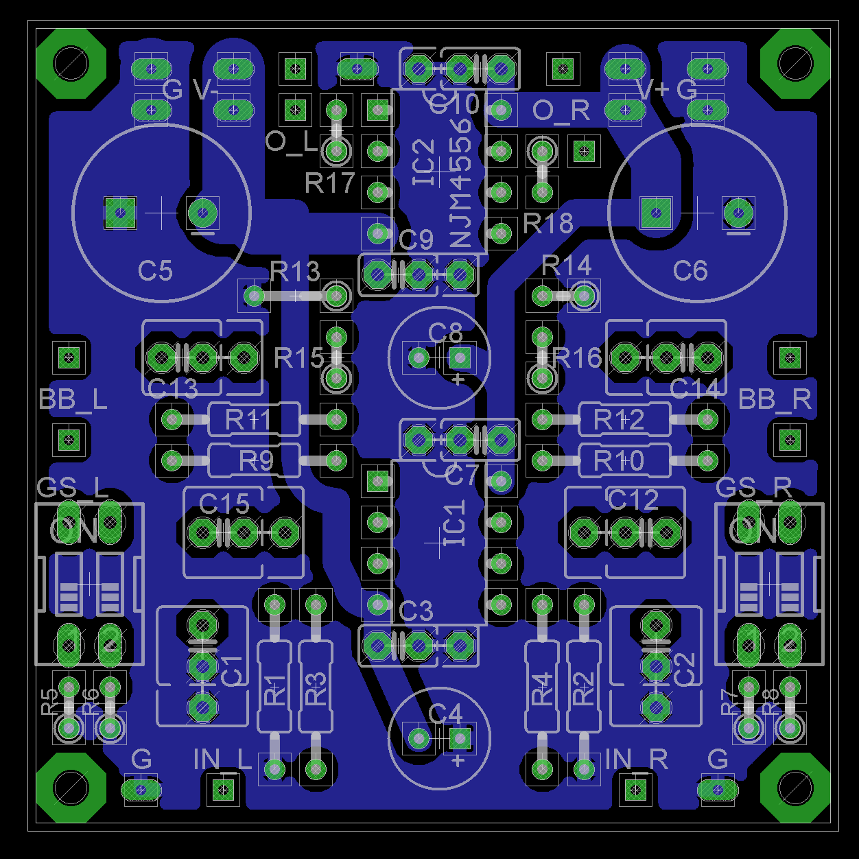

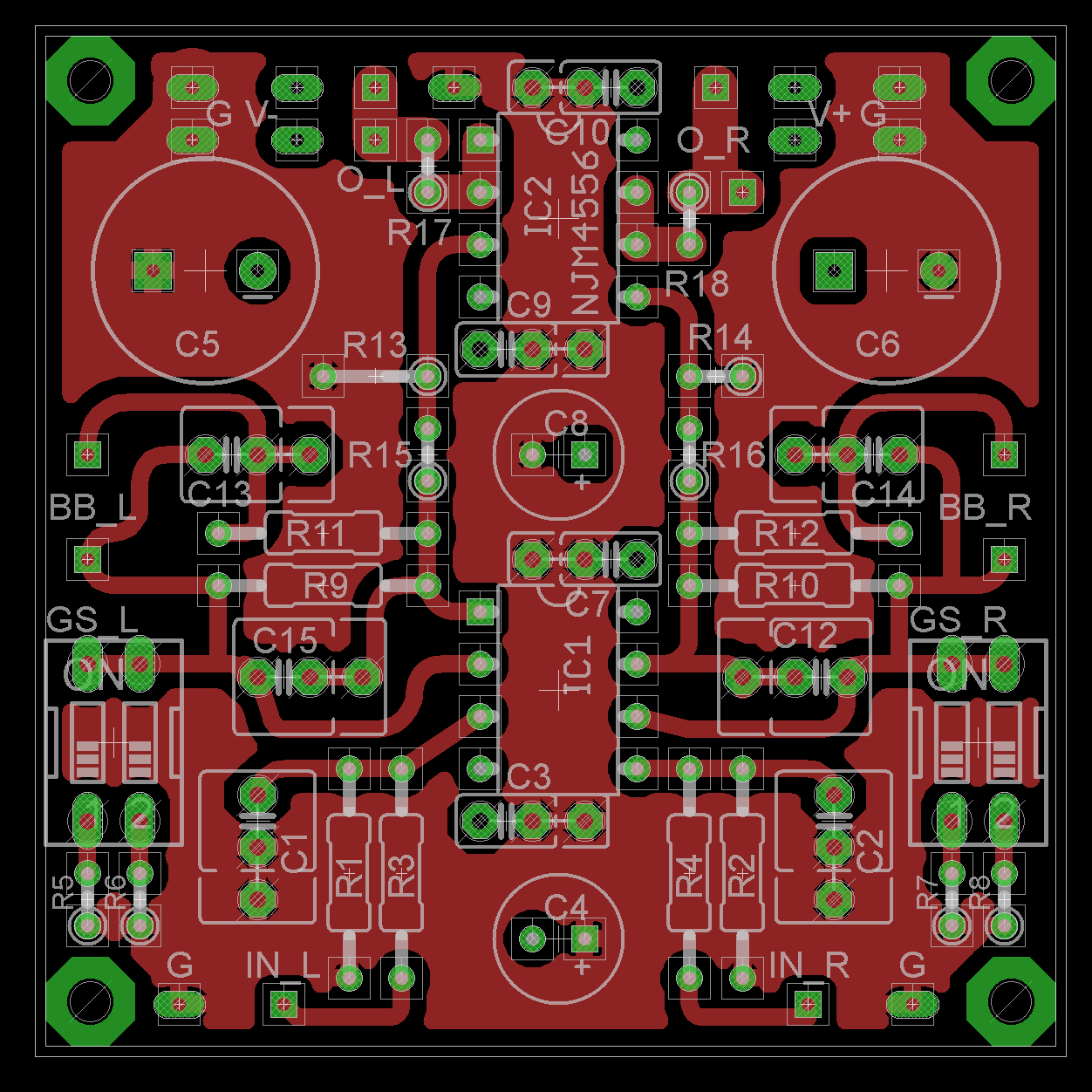

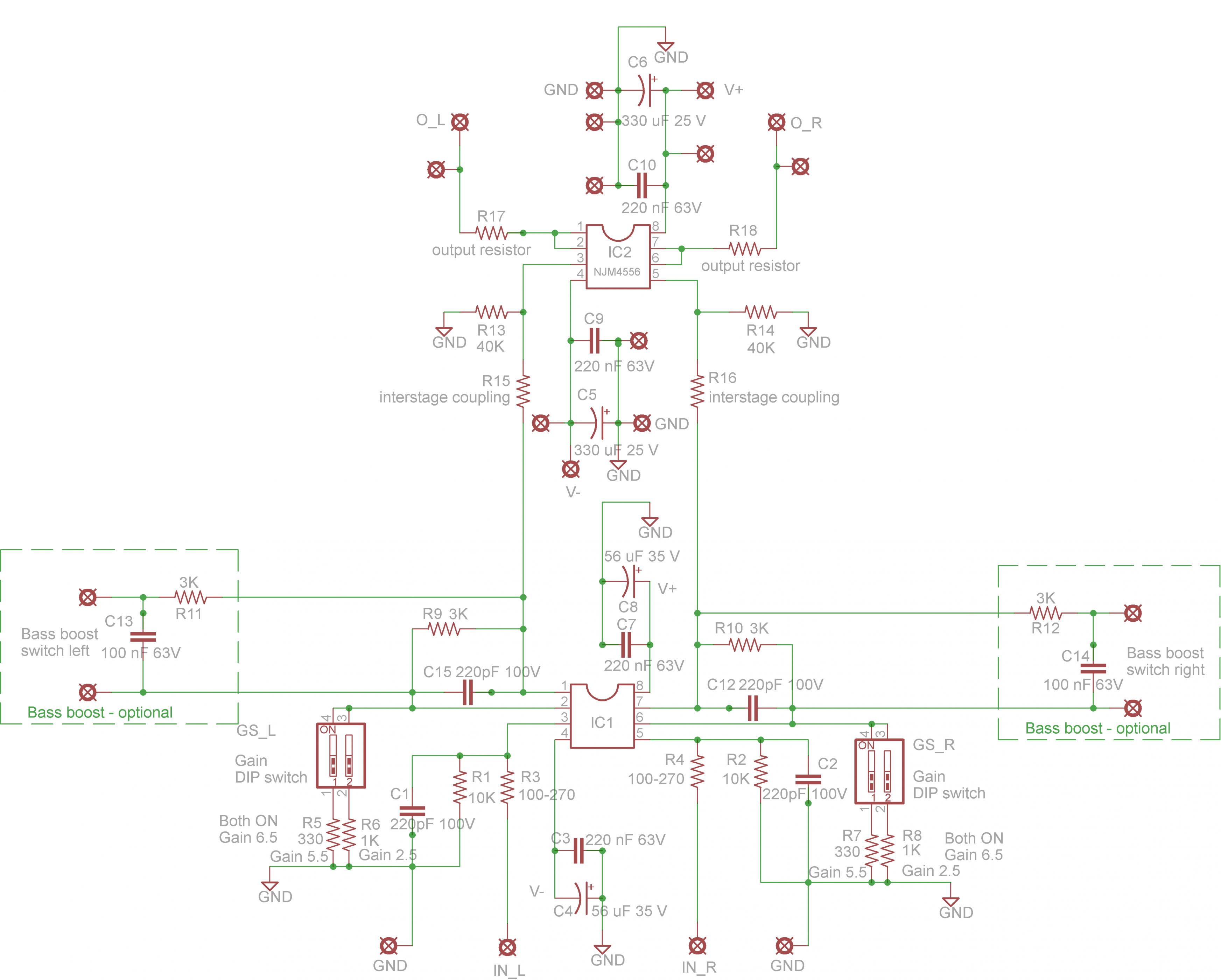

Hi, I am trying to make two stage opamp PCB, non-inverting amp followed by buffer.
I plan to use very small PCB,5x5 cm, and order from Seeed studio, Itead studio or similar.
Features:
• 2-layer board
• Local feedback
• All thru hole components
• Selectable gain via dipswitch
• Input&feedback low pass filters ala O2
• Switchable Bass boost ala AGDR O2
• Caps in signal path (LPF and BB) – multi-footprint 2.5, 5mm Ls, available width 5-6 mm (MLCC or Film Caps possible)
• No power supply on board only rail-to-ground caps
• No jacks or pots on board, pcb connectors possible on some positions
• Component values are like O2
This PCB can be useful as:
• Headphone amplifier
• Preamplifier
• First stage of headphone amplifier for current hungry headphones
I am newbie in Eagle&PCB design, could someone please review this PCB, check for errors and provide tips/suggestions to improve it.
Please, first check schematics and board layout, ignore for the moment component values (not important for board production).

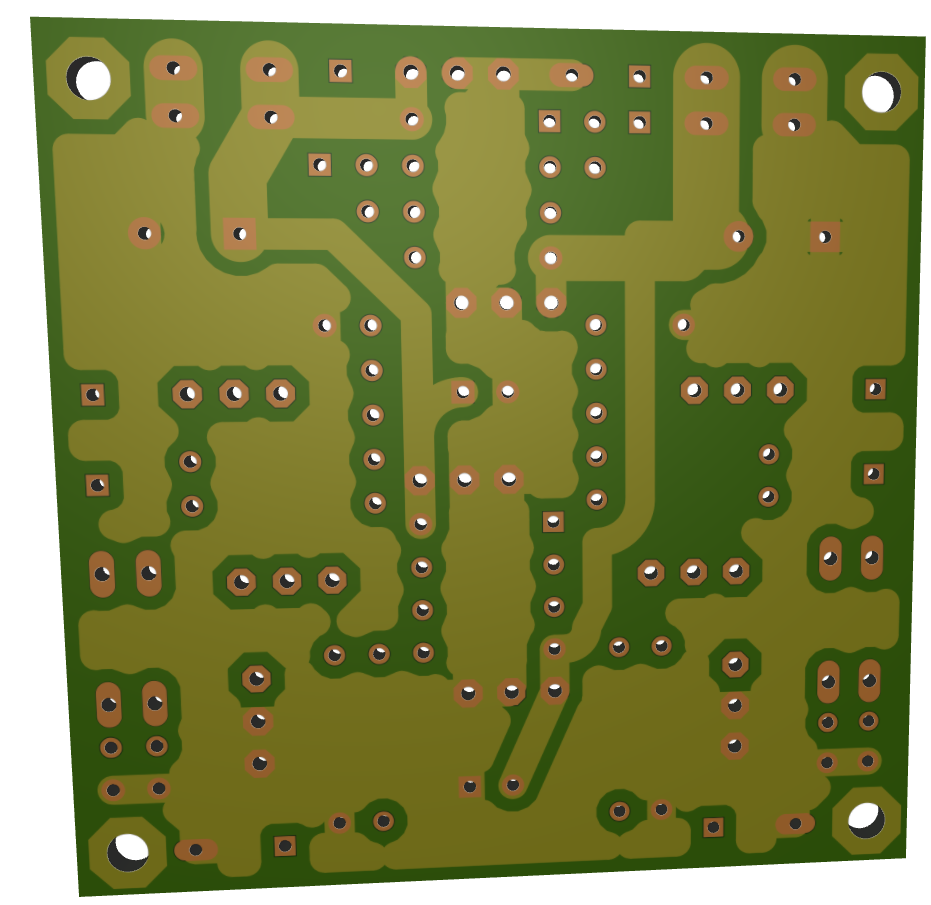

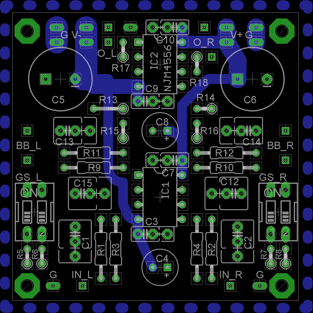

You saved me tons of PCB designing work, I'm still trying to get my feet wet with Eagle. I hope mistakes, if any will be noticed by more exp. diy members

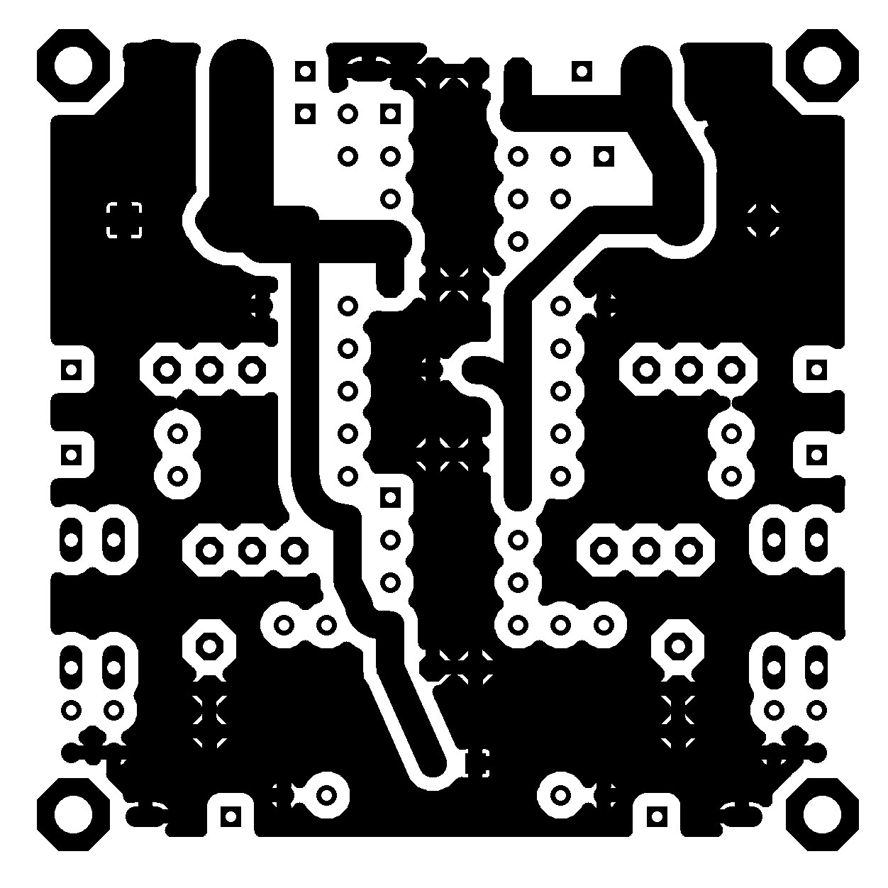

Silly question- How do I get only PCB track layout minus all the components, silk screen,e.t.c. so I can use it for toner transfer method from your attch.?
Hi availlyrics,
I can do it for You from Eagle, only top&bottom PCB traces, I will do it tomorow if You want.
You know for Seeed studio? 10 pieces 5x5cm PCBs with shipping for 14$.
Who needs toner transfer with that prices 🙂.
I will attach gerber files in case You want to order.
Sorry I was unavailable last weekend, thanks a lot!. Toner transfer is useful for one off project, I'm just learning it as a hobby.Though I have to admit, Seeed studio deal is a steal.
