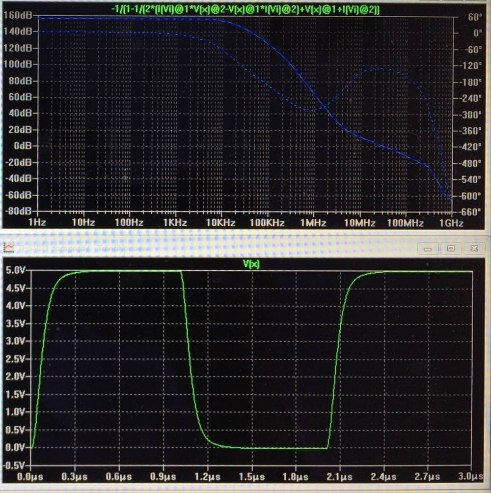

1. Feedback depth at highest audio freq, say 20 kHz for simplicity, combined with unity-gain freq. Now there are no point to design an amp with less than 100 dB at 20k, which paired with 3EF OPS will have straightly unmeasurable distortion. Yes, THD can be measured using compensation methods aka distortion magnifier, but there out of diy interest at those FB depths.
I have not yet designed an amp with Feedback of 100 dB at 20 kHz, but here are LG plots of one of my CFA design, I think it's good enough.🙂
Second one is with some shunt load of the VAS.
