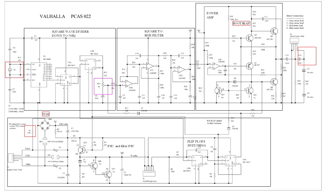

Thanks for the Linn info ! Mine was on paper .
This is a speculation about how to make a better PSU . For UK or USA it is using a higher voltage that can be taken directly form the electricity . +/- 90 V is allowing 10 % for fluctuations and using 100 V capacitors . 4 amplifiers would be required . The 4R7 + 0.1 Zobel circuit can be across the motor phase to phase saving some components ( 2 x 0.1 + 4R7 ) . This should be OK for 110 V rms if bridged . I adapted an old drawing hence the 0R . These transistors are good for 270 V . +/- 135 V if you want to . In bridge that might reach 170 Vrms . This would require a 65 - 0 - 65 transformer for the 90 VDC +/- . Perhaps two in series if buying off the shelf . No output transformer required if so . A phase inverter ( x 2 = 1 x TL074 ) required for the bridge .
Jay . A quick note on the progress .
Best just fit the new crystal and it's relay to your Valhalla . This will help it change to 45 RPM better . Start at 33 1/3 and change over when running .
My tests today found that although fitting the extra capacitor is correct it might just be defeated by the lower voltage . A simpler plan B has emerged .

Repaired my spare Valhalla and fitted parts to go two speed . Forgive photo quality .
R13 shunt turns out to be about 11 K to restore the output ( total 7K33 ) . If not only 40 V rms as compared with 86Vrms at 33 1/3 .
I found as before 0.11 uF to be correct . However vibration is fine if the 0.22 is unchanged .
I had a daft way to changing the output by changing Z1 zener diode . I have restored this one to 7V5 and did R13 mod as suggested . When I did this nearly 20 years ago I had no circuit diagram .
Will give graphs as some of you are in for a surprise . The resistors on the motor terminals are for the measurements . I have to divide by two to protect my scope . Please do not try this at home as they used to say . My scope has an opto-coupler so is able to do it .
One first sight the blue phase looks very distorted . The Valhalla as can be seen is not . The distortion is how the motor draws power as seen earlier ( like a triangle wave ) .
Note that the 45 is almost identical , a good sign ( sine ? ) .

Took a risk and added 2 x 220 uF 250 V . 12 db or 4 fold improvement . Rectifier probably would cope .

I found something easily fixed and cheap to fix . I can forgive the designer of Valhalla never seeing it and say thanks to the Lin rep of the time for saying about it ( Michael Mc C I think ? ) . He said when designing Lingo they noticed the beat between 50 Hz and lets say 50.1 Hz of the mains . To Linn's ears it caused a type of wow .
My guess is they did exactly what I have and saw it for the first time . Lets put it into some perspective . My old Quad 303 has a bit of hum . It would be 35 dB better than the Valhalla .
Last night thinking about is 2 x 220 uF is series is 110 uF . That shouldn't challenge a WO8 rectifier too badly . I used radial ones as they don't take up space . My hunch is 2 x 470 uF ( or 4 x 220 uF ) will take the left hand peak down to - 60 dB , logically it should .

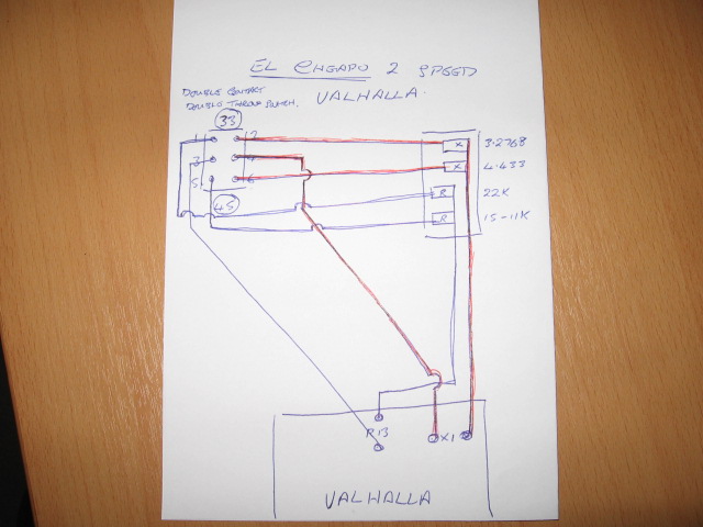

Hi Jay.
The circuits that Nigel has come up with are great, but if all you want is a quick and easy way to add 45 rpm to your Valhalla my 'El Cheapo' version works fine.
From my first photo you will see that I removed the existing resistor at R13 and the crystal at X1 on the circuit board. I just snipped them off close to the crystal and resistor so that a pigtail of wire was left sticking up off the board for easy soldering. 2 crystals ( 3.3276 and 4.433 MHz were soldered to the little circuit board along with 2 50k ohm pots adjusted to 22k and 15k respectively. A double contact double throw switch is then wired up to select either pair. The 3.2768 crystal with the 22k resistor, or the 4.433 crystal with the 15k resistor.
That's it !!!!!
Thanks I think iv'e got it sussed now, & removing the crystal & resistor is straight forward.
I cant see any pic you might of taken with the small add on board. could this board be just a bit of 'chock strip' used in order to hold the added components?
If you could show in schematic form how the pots, crystals & switch are wired together & then into the Valhalla. I could hard wire it to the board.

Here ya go Jay.
In keeping with the El Cheapo theme, here is an CAD ( Completely Amateur Drawing) of the wiring diagram. This works just fine on my AR turntable as the 33 circuit is unchanged and the 45 circuit is OK for the few 45 records that I have anyway.
You could use fixed resistors if you like but I preferred to be able to fine tune the voltage measured at the motor terminals to 85 volts on either speed.
The additional circuit is on the little brown board in the top left of my original photo.
You could even just attach the resistors and crystals to the switch if you preferred.

Thanks Graham for doing the wiring diagram . Thought I would do some voltage checks . Basically you can have 84 / 42 % ( US / UK ) of the mains voltage in your house. That says if you have more than 110 / 220 V rms you could have the modification of C18 replaced with 1uF to create a subsonic filter . Add 180 K to R13 to restore 8 V rms lost. The 11K is still required for 45 RPM in addition . As far as I can see 1 uF C18 does far more than increasing C1 and C2 .
If you feel you would like a bit more initial voltage try a boost transformer as drawn . You will know if you got it wrong as the voltage should increase . 253 V is usually taken as a maximum . 260 ( 130 V ) VAC( rms ) as I tried is about 370 VDC which is 10% below transistor maximum . C1 C2 share the duties and would have a 500 VDC overall rating . C18 is a bit naughty as it will see 170 V +/- 70 V = 240 V peak . A class X 2 cap is generally rated at 390 V peak . The boost transformer would a good idea for Japan . If running Japan equipment in the USA a buck connected transformer is a good idea . You need a secondary current about double the actual . So if 500 watts and 15 V AC bucked that would be 15 V 10 A = 150 VA . Valhalla uses 0.04 / 0.08 A , any transformer will do within reason .
I glued my relay to the PCB with a Sellotape sticky fixer . I have two posts made from resistor wires coming up out of the original crystal holes . I then dead bug solder the crystals to the relay . I uses a DP DT relay . One side crystal and the other R13 shunt resistor .
