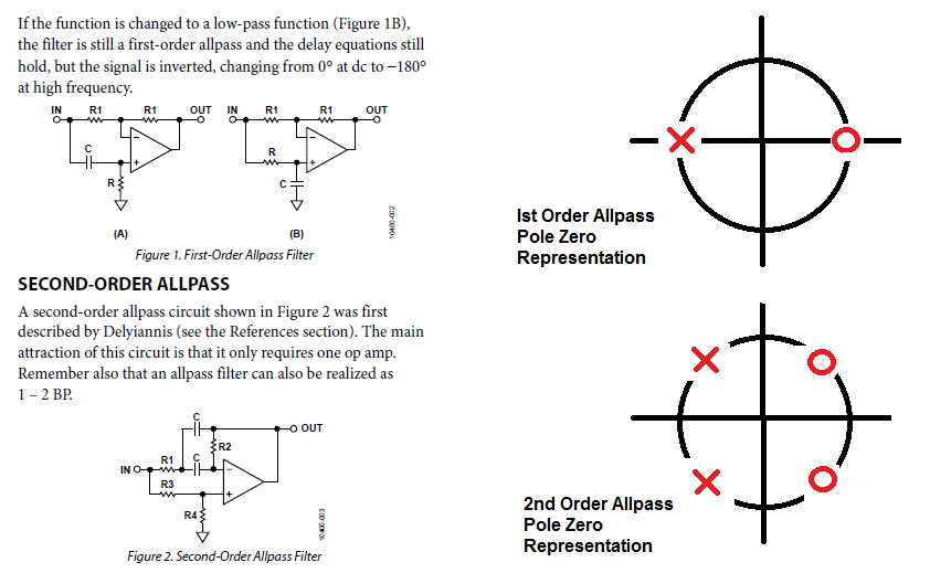

Maybe they mean an all-pass transfer, with poles in the left half s-plane and zeros in the right half s-plane, mirrored in the imaginary axis. Ideally a multiway loudspeaker with Linkwitz-Riley filters has an all-pass transfer from voltage to sound pressure.
Here's a few pictures. Sorry it's quite advanced maths.
Ages since I have done this, but when a filter is pole-zero asymettric left to right, as just mentioned, it means it has group delay or phase change. Poles of the transfer function, the denomnator, are always on the left plane in the usual world. Zeroes of the numerator can be anywhere. This is fourier transform or function of a complex variable.
So although the frequency response is flat, there lurks group delay or phase change overall.

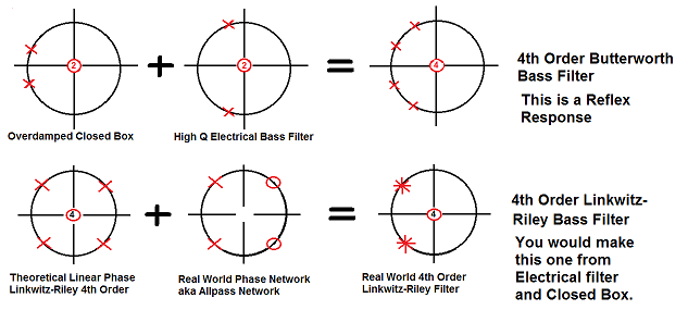

2nd and 4th order filters:
386174d1386407937-audibility-delay-allpass_filters-png
Sixth order filter:
591432d1484097951-flat-impedance-flat-power-response-design-3rd_order_phase_network-jpg
386173d1386407937-audibility-delay-delay-png

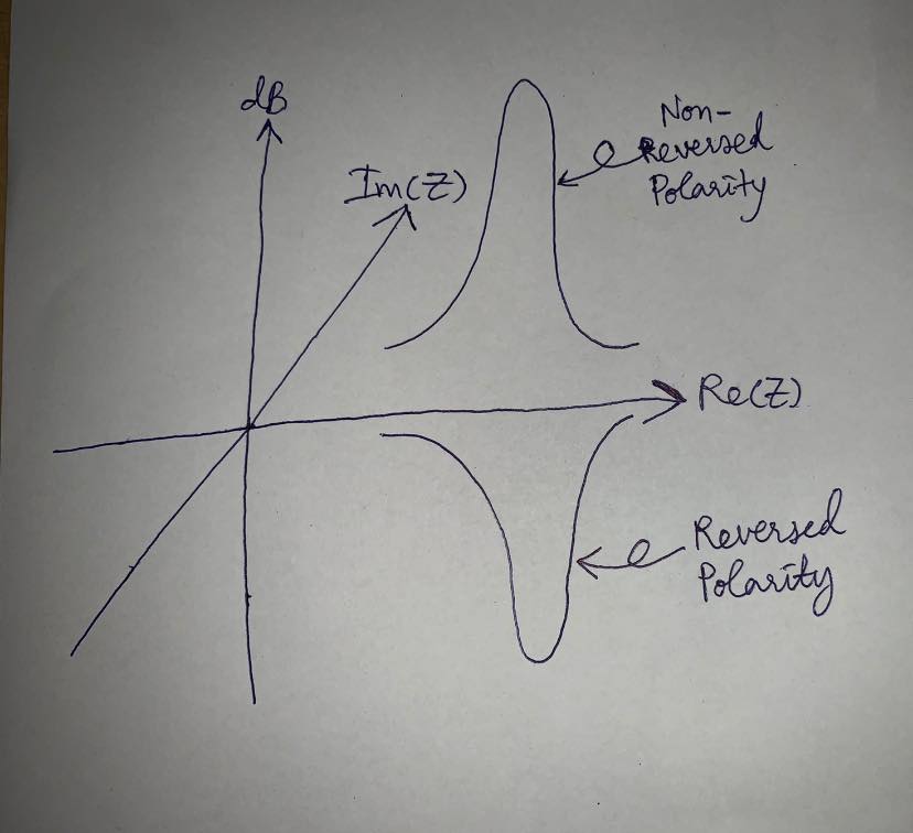

To my understanding, he may mean that if the tweeter is wired non-reversed polarity, the pole is aligned in the positive z-axis direction and when tweeter is wired reversed polarity, the pole is aligned in the negative z-axis direction at the same x, y coordinates (sigma, j-omega) on the s-plane instead. Is my understanding correct?

386172d1386407937-audibility-delay-pole-zero-filter-analysis-png
It's very abstract really, but convenient sometimes. If you have phase-aligned filters like Linkwitz-Riley, flipping the tweeter polarity will make a big hole at crossover. Designers actually use this as a test for phase-alignment. LR2 (12db per octave) is a negative polarity solution when time-aligned. LR4 (24dB per octave) is positive polarity.

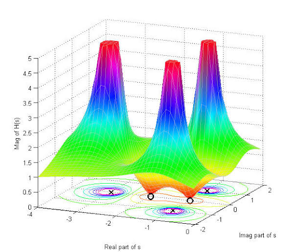

Here is the picture to illustrate post #6, the 'two-sided pole' concept in my opinion. Does it exist? With my little knowledge in Maths, I've never seen an upside down pole case before. Has anybody ever seen it? Please help to educate me.

A pole is a singularity where a filter transfer function becomes infinity. For example, take a first order RC lowpass transfer function 1/(1+sRC) for which s=-1/RC is a pole as this value makes the denominator vanish, sending the function to infinity. Since the pole is real in this case it lies on the real axis, as shown in its pole-zero diagram below (p=-1/RC)
All real networks have poles with negative real parts, just like the above example. Anything else is unstable. I don't know why you draw a curve to indicate a pole. Also, your poles are on the right half plane, which is not very becoming of a stable filter network.
Well, in that picture, the Mag(H(s)) is defined as positive (for any complex no.), so there's no pole that makes the function infinitely negative. With a phase inversion, only the phase plot would change by 180*, showing which would need another axis, i.e. a 4D vector space. The "towers" however, would keep going in the same direction as they're, i.e. along positive mag axis. Hope this clears things.
Now come back to reality to see how the mag values around the poles (singularities) shoot towards infinity and how the real parts for all the poles are negative. Also, since the magnitude around the pole locations is already known to be infinity, showing the s-plane alone (the one with circles) is commonplace and considered sufficient for all practical purposes.
Now, as to what that fellow possibly meant by the term "two-sided", just look at how the complex conjugate poles at (-1 +/- i) are symmetrically mirrored by the imaginary axis. Once again, as I already mentioned earlier, this mirror could not have been along the real axis, for stability related reasons.
I am not at all surprised that you didn't come asking about "inverted zeroes" of the system in the same way. Plus or minus, zero is just zero isn't it? 🙂

What you are trying to do with a crossover is get the woofer and tweeter to add up to a flat frequency response:
715080d1542008118-restoring-monitor-audio-r300-bookshelf-speakers-steen-duelund-1-414-root-2-png
We often use a normalised frequency of 1kHz to see what is going on. Gets rid of the constant with s.
Circuit A is a 6dB high pass. Just like a single capacitor filter to a tweeter in an ideal world.
s / (1+s) which has a zero at the origin and a pole at -1.
Circuit B is a 6db low pass. Just like a bass coil on the woofer in an ideal world.
1 / (1+s) which has a pole at -1.
Add them together and you can get (1 + s) / (1+s) = 1
Or (1 - s) / (1 + s) which is all pass.

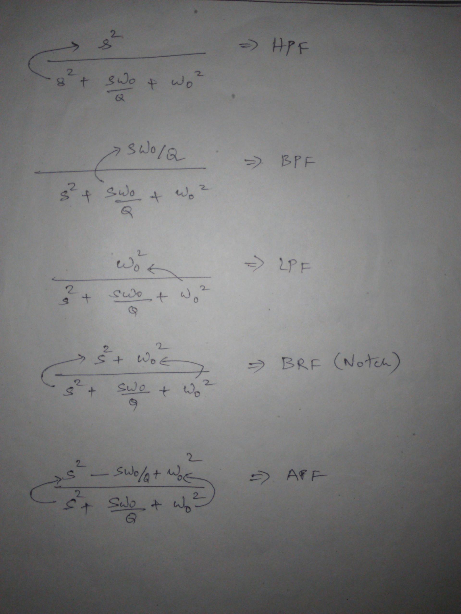

Second order filters usually place the poles on the unit circle. Zeroes are either at the origin or (theoretically) infinity on the imaginary axis.
A second order butterworth high pass looks like this:
ss / (ss + SQRT2 x s + 1) with poles at 45 degrees and a double zero at the origin.
1 / (ss + SQRT2 x s + 1) for low pass.
I can't remember the plus and minus signs, it's been so long... 😱
System7, here's an easy way to remember how the poles and zeroes of different second order filters play out.
Yes, it is most likely that the combined all-pass nature of the system was what was originally intended, as the zeroes mirror the poles right across the imaginary axis.
But presscot seemed to think that poles were the "stalagmites" in the picture (post #14) and wanted to know if they could be sent downward by way of a wire reversal which, clearly, is not how things work.
