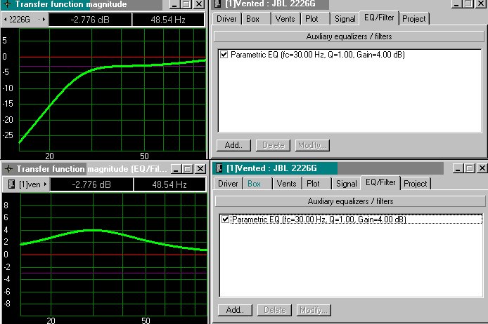

1. If you have drivers that you want to equalize in order to extend the low-end response (by compensating for the driver's natural rolloff), and you want to use a bass-reflex box, would you simply lower the Fb so the point at which the air in the port is damping the woofer's motion is adjusted to compensate for increased excursion at these lower frequencies?

Yes.You can lower the Fb..the response looks overdamped.Then EQ that response
www.linearteam.dk winisd pro,get the update too.
A sixth order bass reflex alignment requires an overdamped 4th
order reflex alignment. To do this you must drop the port frequency.
The 2nd order Q = 2 to 3 high pass filter is centred on the port
frequency, so maximum boost is at the point the port is maximally
loading the cone.
